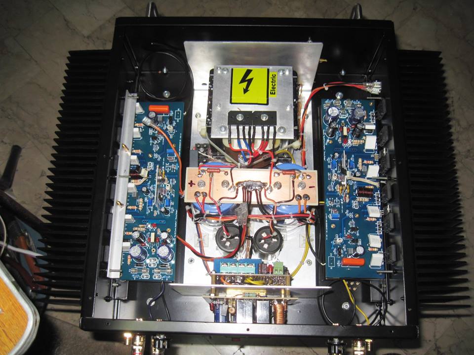

I think that returning the speaker gnd to PSU gnd directly is of even more importance if bridging is intended or at least it's possibility is given.
But then, how do you twist the speaker leads? Just right down to the amp PCB and let the gnd wire alone run to the PSU?
Best regards!

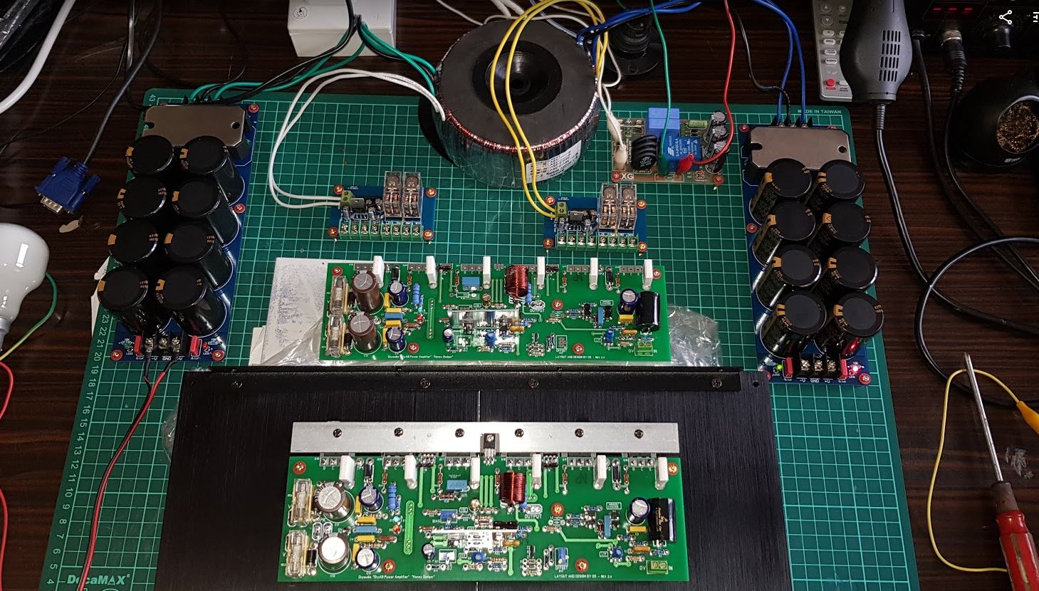

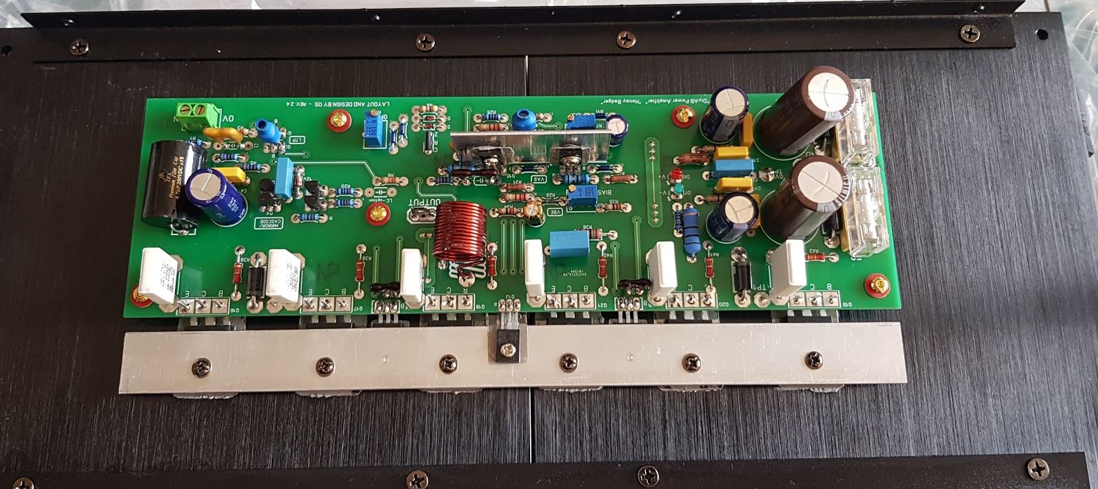

i twist the power rail supply wires, they are not long, 6 inches at the most and #16, the speaker hot wires are segmented, from the HB board to the speaker protection/delay boards, all short runs....where twisting wires will look silly, i would rather not do it..
Ok, the main effect in twisting is reducing the loop inductance of the involved wires. If these are short enough, the benefit of additional twisting indeed can be considered as marginal.
Thanks for these pics! Well done!
Best regards!

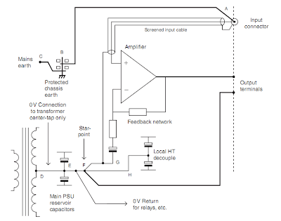

Let us say that this is the perfect layout where the Power, speaker, input/feedback and local decouple grounds connect at F (star-point). Normally F sits somewhere on the amp board. Connecting speaker return to E, as suggested here, adds an error voltage caused by the current between E and H.

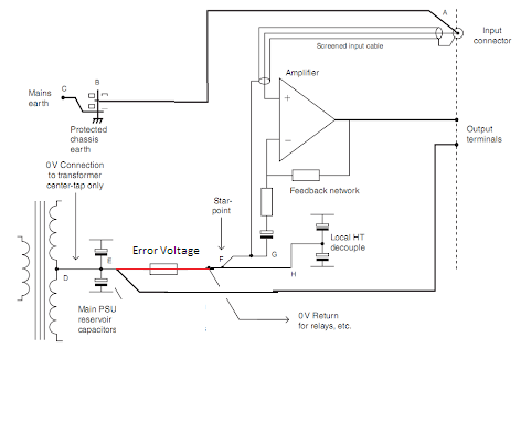

How long is a piece of string? Here is the error voltage in red. It will be dependant on the output current, the amount of high-frequency content, the value of the local capacitors to name but a few. If you really want numbers, try simulating the circuit.

way i always understood it, zero reference at the psu ground to the pc board ground are never meant to carry significant current resulting from amplification, just the idle or quiescent operating point currents, and lower this is the better imho...
now when the output stage delivered output currents and voltage swings the big currents flow thru the supply rails, thence thru the output trannies out to the speaker hot line, then to the speaker and back to the psu zero volt return point, this is the reason why i put the speaker cold side wire direct to the psu cap junctions...what is hard about this?
Because that is not the only thing that is taking place in a class AB amp or the way feedback works. The local decoupling capacitors are supplying current to the output of the amp every time it crosses 0. This is then followed by charging currents to/from the PSU.
Zero reference is wherever you connect the input/feedback ground.
