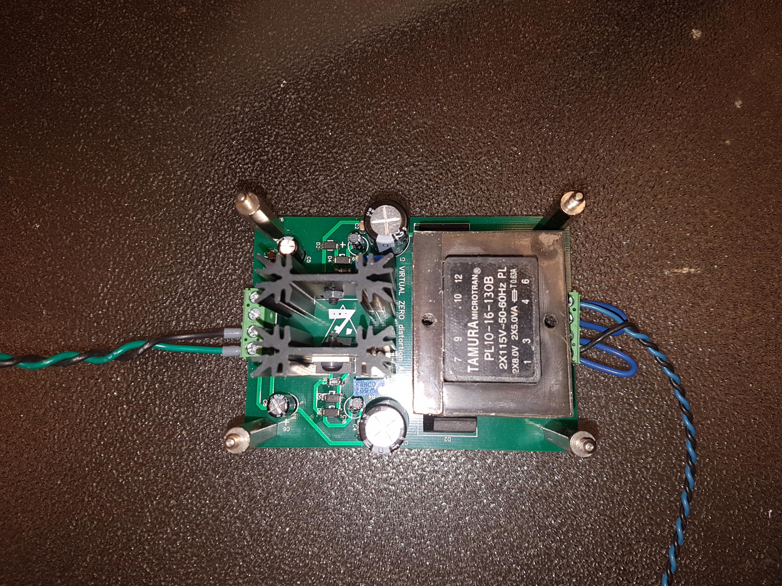

I may have the schematic somewhere in my workshop, will have to dig it out. In the meantime, here's a link to the units I used (rather basic easy-peasy stuff). I converted these stereo units to single channel (paralleled the two sides of the relay), and used one of those units for each channel.
The ability to use an isolation circuit for the grounds depends on how the DC detection circuit operates. Most are very high impedance circuits looking for DC voltage to be present, so a 10 ohm resistance in series really has no bearing on this. Unfortunately with a uPC1237 there are other parts of the system relying on this same connection to ground, so it's unlikely it will work reliably with this resistor added.
Kay Pirinha's suggestion of dual control supplies is likely the best option with these boards. There are lots of small DC supply or DC to DC converters that can be used for this. I've got some tube heater supplies designed that can be altered to any voltage output, and have dual isolated outputs that would work perfectly here.

I am not planning to insert resistors in the connections to the audio GNDs, because would most likely upset the DC sensing. My idea was to insert the resistors between the DC protection units and their (combined) PSU. Depending on the current drawn by the protection units, this would result in some voltage loss across the resistors, but it would float the units against each other, and break the direct connection of the audio GNDs via the DC*protection PSU.
Using separate voltage supplies is certainly the cleanest way to go. But that would mean adding two more boards with two more transformers to the chassis. Not very elegant... I'd prefer the much cleaner 21st century solution, which would act as a replacement for the inrush limiter and the DC protection.
Actually the resistors to ground for the DC detection aren't an issue. There's usually a 47k or 100k resistance in series with the circuit before the AC filter. 47000 or 47010 ohms really is no different to it. I'm not sure how the 10R resistor would work in the supply though. That depends on the circuit. It's tough to figure out an easy fix without seeing a schematic.
Dual control transformers wouldn't be necessary for your circuit. The picture I posted was a supply with a dual secondary transformer with two isolated output regulator circuits, so it gives you two completely separate control supply outputs from a single transformer. The 21st century solution is much neater though. High power mosfet relays are much safer for your speakers too.

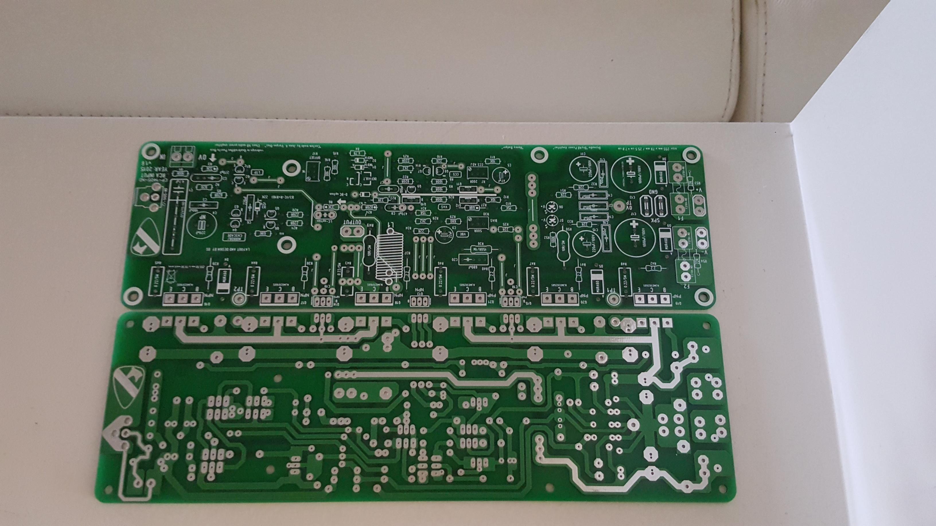

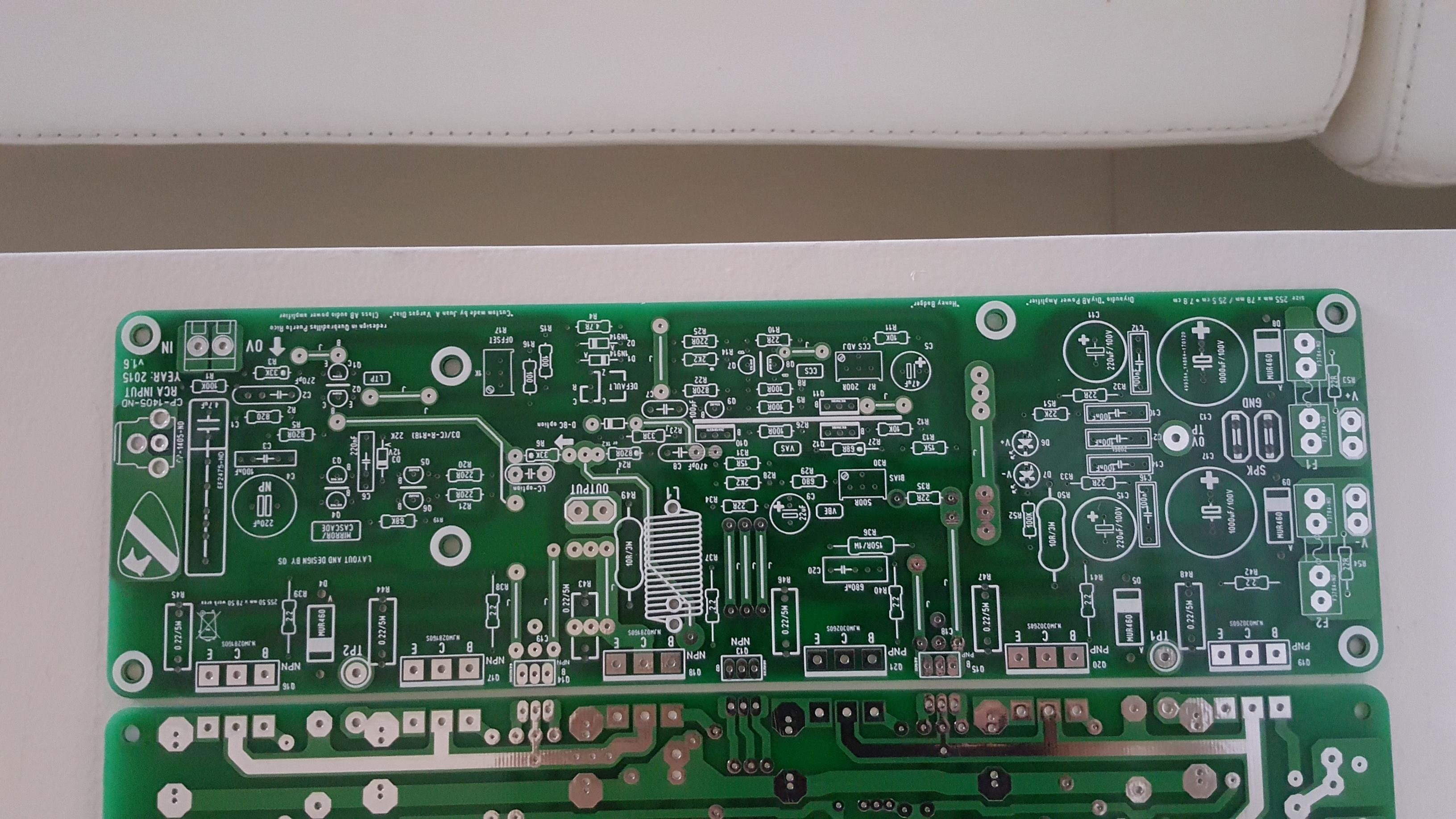

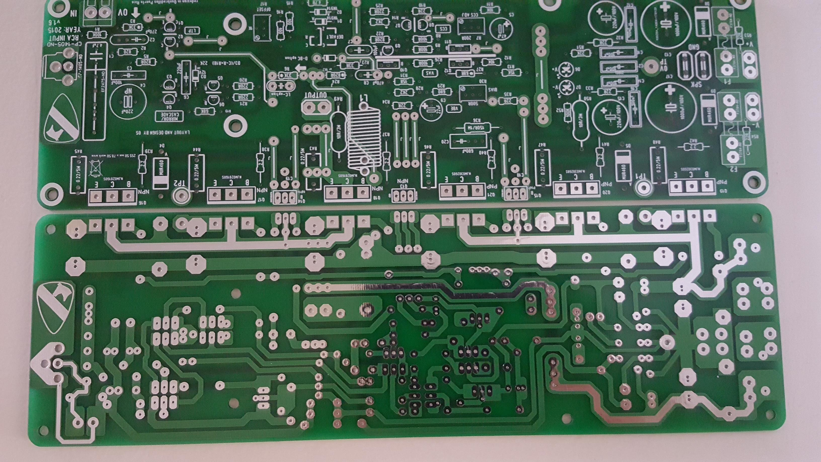

Hi All. I have some extra Honey badger PCB boards that I had made so if anyone wants a pair and lives in Australia send me a PM and I'm sure that we can arrange something.
These boards look nice, but I believe they are a little different from my V2.4 boards I bought from the diyAudio store. Your boards are labelled "version 1.6", but I am not sure how this relates to the the Honey Badger version(s). Can you describe how they are different (or not) from the V2.4 boards that were available from the diyAudio store?
I believe that the boards are a clone of the 2.4 board. They also have an RCA output directly on the board and some extra solder reinforced tracks in some important locations. Here is a video I found with some other information. https://youtu.be/M5zlFYZ9Bc8
