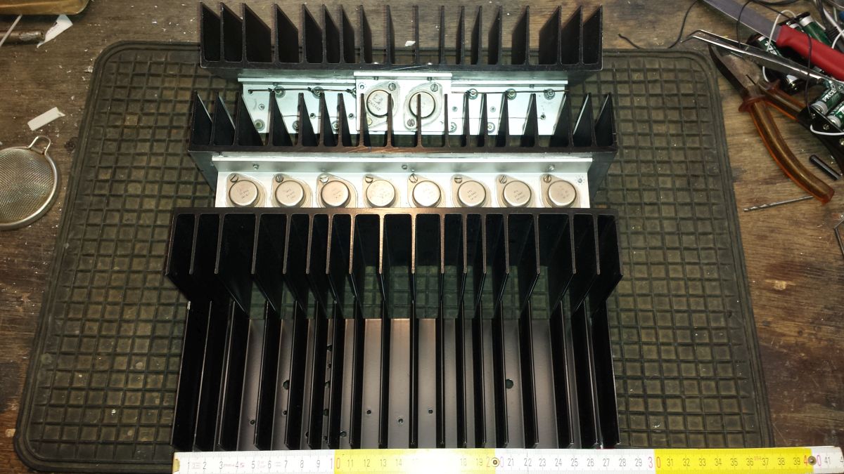

While staying on a visit at my father's yesterday, I dug out a small box containing two pairs of heat sinks that I bought as a high school pupil from a surplus vendor at the end of the 1970ies. Each HS measures 277 x 93 x 45 (WxHxD) mm and has 19 fins.
Yes, there are some holes, but, hey, it's surplus and they were cheap, as far as I recall.
One pair I've populated then with five pairs of 2N3442's for a pair of RCA style amplifiers that I've planned - but that never were done yet. Perhaps their time will come...
Can the thermal resistance of these heatsinks measured or, at least, estimated? And are they suitable to build a pair of Honey Badgers, fed from ±48 Vdc?

I would be surprised if you wouldn't be fine with these heatsinks. I biased the output stages of my Honey Badgers quite a bite "hotter" than the standard described in the build guide, and the heatsinks are hardly warm.
Question answered, partially at least:
I applied 110 W of dissipation power per eight of those 2N3442 devices (14 Vdc, 7.9A), using the ninth one to drive them in Darlington mode (the tenth I left unused), and observed a temperature rise of 60 centigrades (from 15 deg to 75 deg). This calculates to about .55 centigrades per watt. I didn't measure the driver's emitter current, so the value might even be somewhat lower per the dissipation of that. Does this sound sufficient?

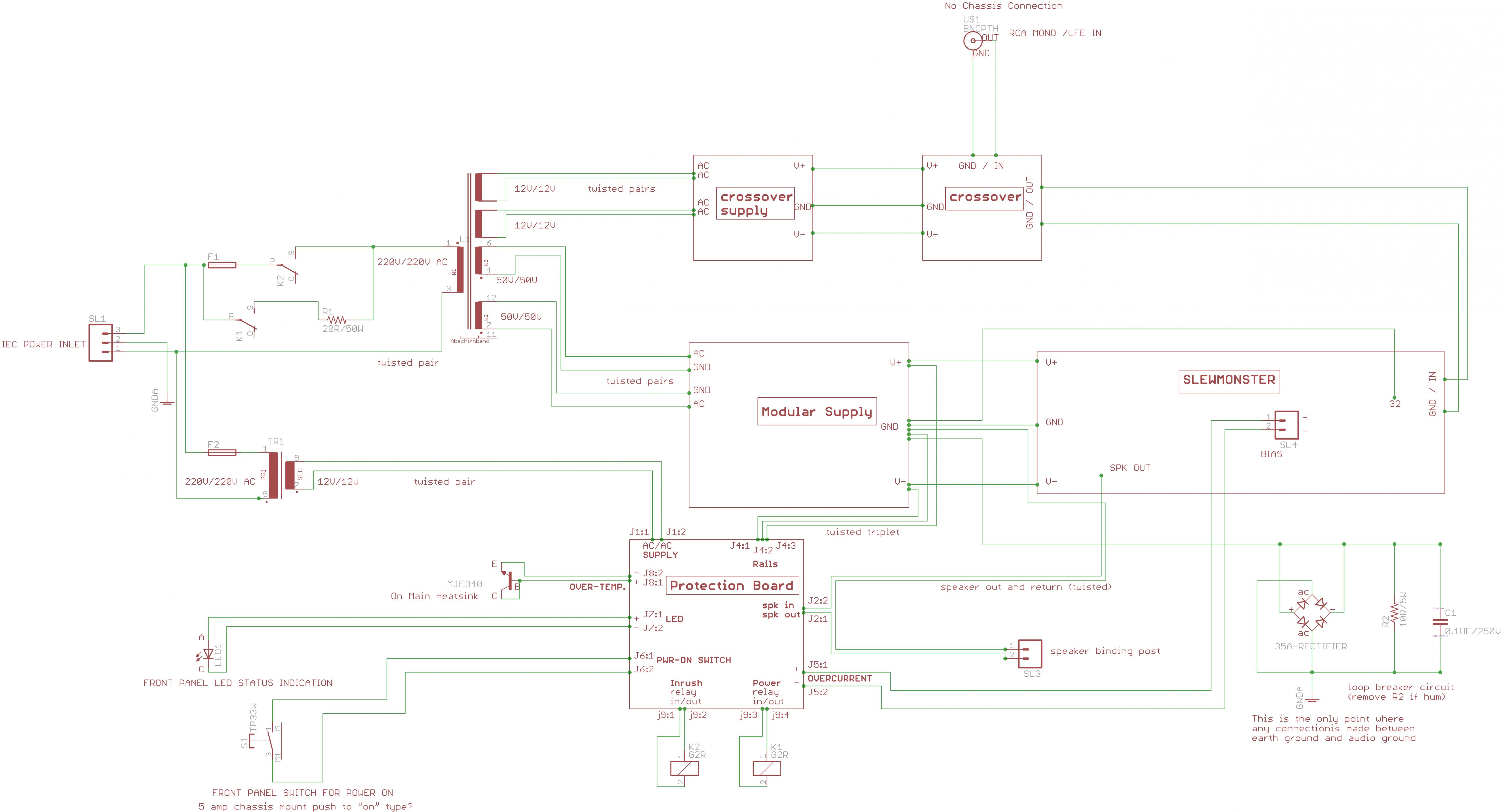

hi Jeff,Here's a diagram for a monoblock wiring example. This is for with out 21'st century protection, but yours should be similar. Ignore the crossover.
here is somewhat of an extension of your excellent amp wiring example that you had shared with me.
one can remove the things that are not there in their builds.
reg
Prasi
PS I do not know if the sch is clear, one would require quite a bit of study to decipher this schematic.
of course......ESP - Heatsink design and transistor mounting
IMO, yes......

Hi Prasi,
what's that Protection Board you're showing in your wiring schematic?
@AJT: Thanks, measurement is already done: The thermal resistance of my heat sinks measures about .55K/W.

Hi Kay,
it is the 21st century protection board by Vzaichenko and JWilhelm. http://www.diyaudio.com/forums/soli...1st-century-protection-board.html#post4110406 . just as an example.

That layout & wiring diagram looks very good.hi Jeff,
reg
Prasi
You have managed to keep all the Flow and Return pairs close coupled.
Even the speaker Return follows the Flow route from the amplifier and then follows the power routes from the PSU.
Well done.
The only exception is the single wire MAG to Chassis via the Disconnecting Network. This should only pass interference to the enclosure in normal operation.
I see no separated star ground and no need for one.
All the voltage references appear to be on the PCBs and thus no need for external voltage reference wiring.

Chassis ground isn't a good place to join returns all together. Everything should return to a common point, usually on the supply ground. Often you find the chassis/earth ground from the supply needs to be done through a loop breaker to eliminate hum.
I am looking again at your "simplified" wiring diagram
The antek0124 is a dual primary transformer.
You have shown two reds together and two blacks together.
Think of driving one primary winding. Where are your Flow and Return PAIR?
Twist them as a close coupled pair all the way from entering the enclosure/chassis until they reach the insulation of the transformer.
Repeat for the second primary.
I think you will end up with one red and one black twisted as a PAIR. And another red and black twisted as a pair.
DO this for EVERY inter-module connection.
eg,
is that a soft start for the big transformer? Then it should have mains power PAIR arriving from the mains input to the soft start. You do not split the pair into separate wires and run those mains wires to different destinations. Your MUST keep them as a close coupled pair all the way from Source to Receiver.
