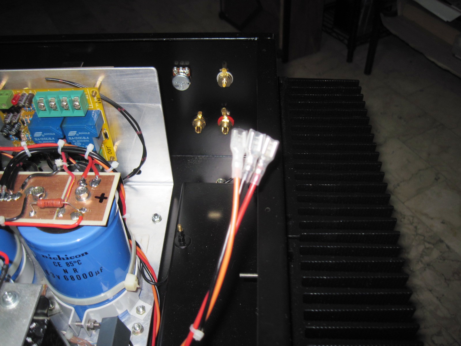

I used the GND / 0-Volt connectors on the Badger PCB to connect the Badger PCBs to PSU-GND and speaker return. And I did not connect the RCA inputs to the chassis. And I used ground loop breakers to connect the PSU-GNDs to chassis.

Every current MUST return to the Source, not to a common point.
said another way, every power rail lines to load must have a return line to its source.....
however if the return point of the source is made into a common point,
then the requirement of the first line is met...
i do not see any confusion here...

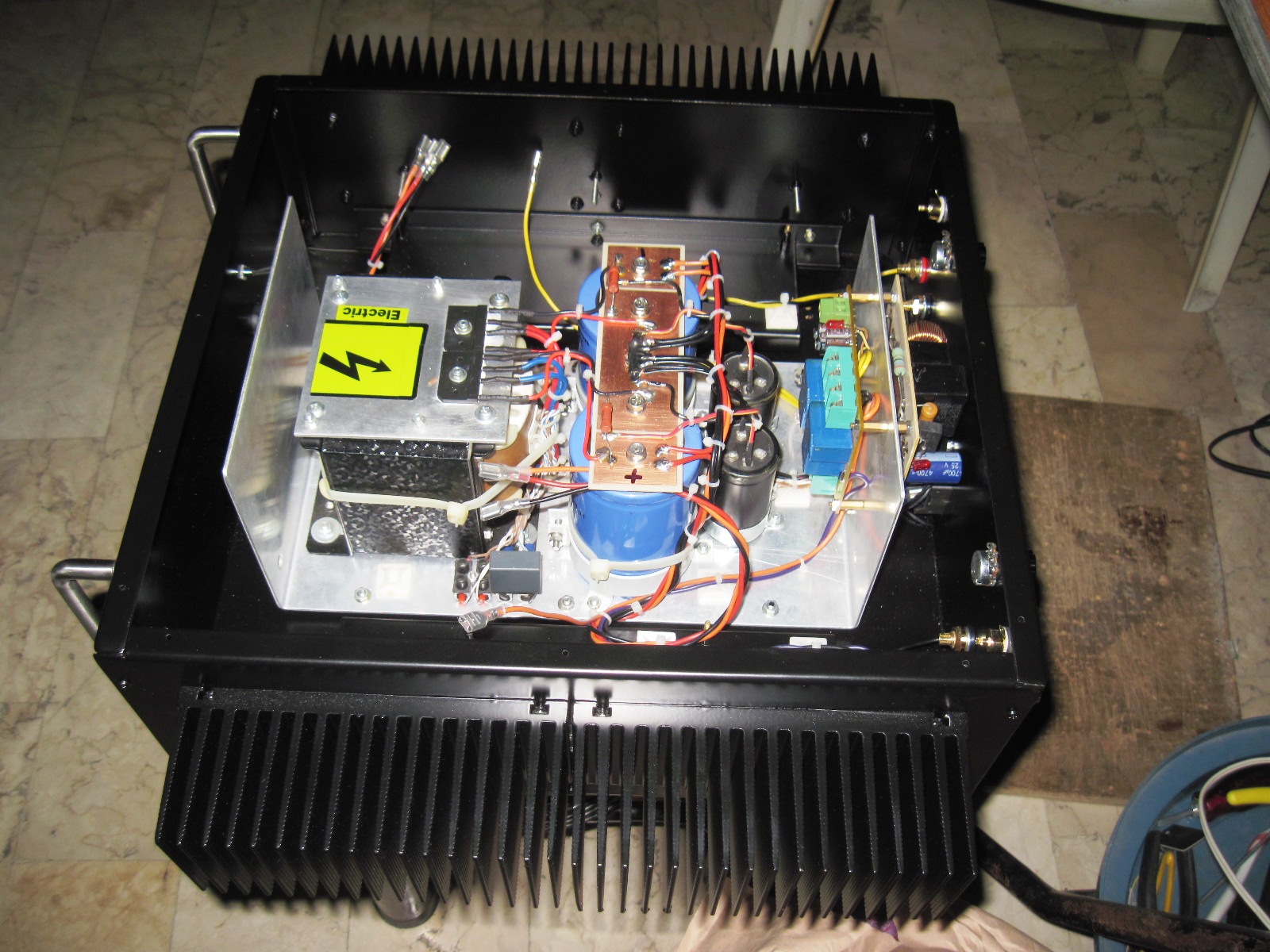

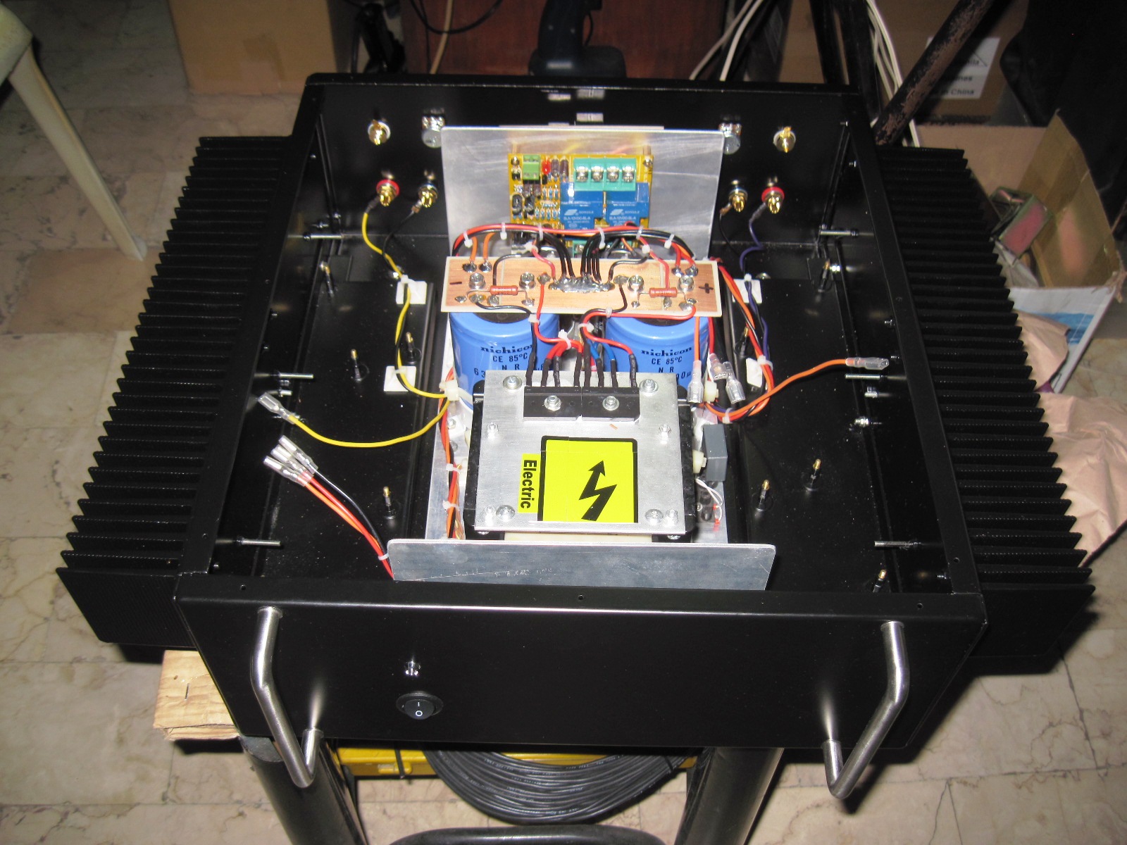

this is how i did it in my HB amp...
said another way, every power rail lines must return to its source.....
i so not see any confusion here...
