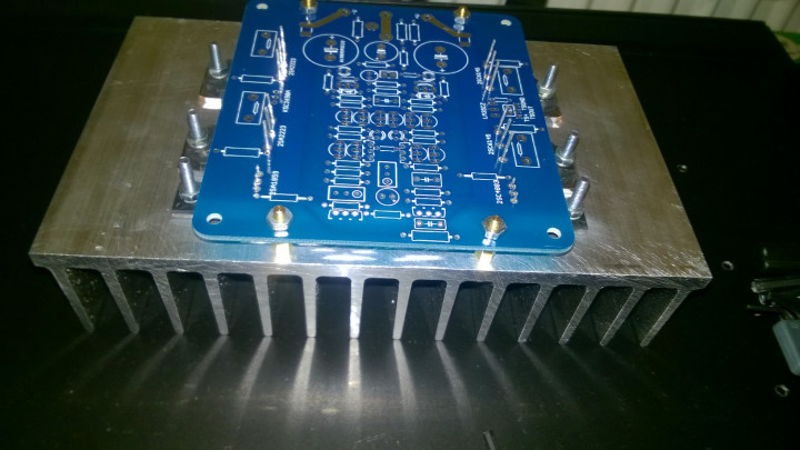

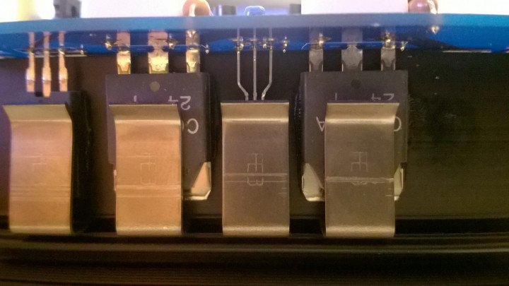

I never do the soldering before clamping the transistors to the heatsink. It can break the soldering, or can make unnecessary force if the part is not properly positioned. (2nd picture)
Precise mechanical arrangment makes the screewing possible too. The first picture shows testing the mechanical arrangement, with a bit long screws.
Sajti
Sajti
What are those silver clips on your transistors? Are these you clamps or are they clips to temporarily hold you transistors in place while you solder?
Sent from my SM-G920I using Tapatalk
