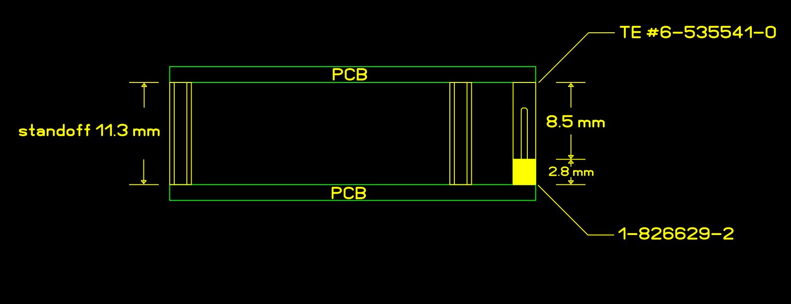

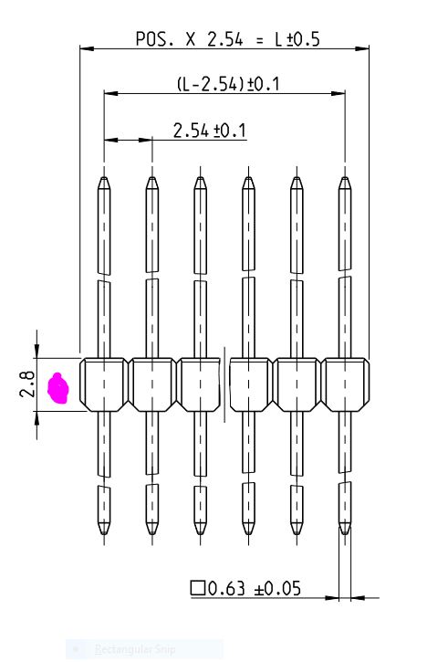

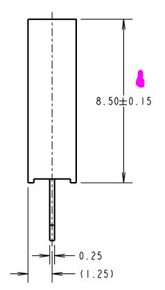

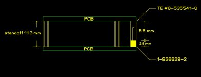

Hi ST I was thinking about the connections of the IPS and OPS EF so for what I see the standoff need to be at least 11.3 mm in high right? See image, the part number is TE #6-535541-0 in high and the part number 1-826629-2 male pin headers are 2.8 mm in high so an 11 mm to will fit well there? I was just thinking out maybe you already got it figure it out already :)

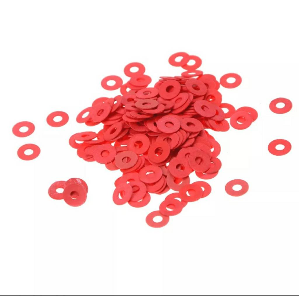

Hi Juan, yes I did see that and you are correct. You can just order a 10mm plastic hexagonal stand off and then use one or two red fibre washers. Like these.
Or just ordered 12mm stand offs a 0.7mm gap is not going to matter

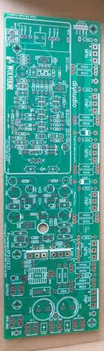

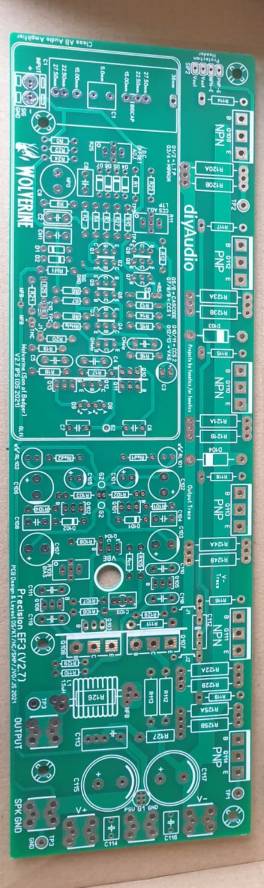

Everything is still moving along... We found some mechanical alignment problems, lead spacing of components, hole sizing, and the big one - the driver not wanting turn off properly without turning the predriver into a space heater. We felt it was necessary to fix these issues on the pass 2 prototype and forget about building the pass 1. The design overall is much improved and I believe we are ready to order boards again. Sorry for the delay and not keeping everyone up to date.
