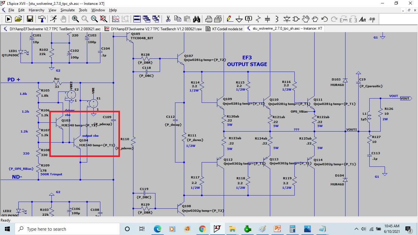

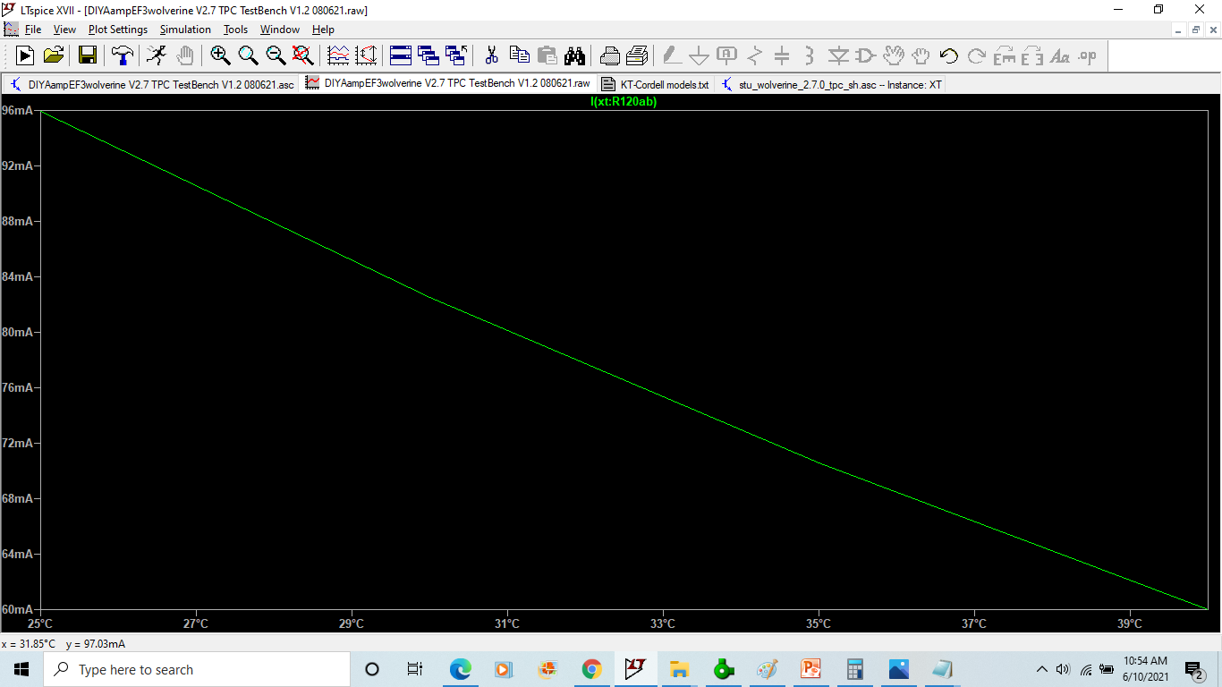

So here is a more realistic test for comparing 0ohms vs 100ohms for the driver base resistor.
Ambient is swept from 25°C to 40°C
Driver is 5°C above Ambient, Q103 thermally coupled to the Driver
Outputs are 15° above Ambient, Q104 thermally coupled to the Outputs
Below are plots showing bias current variation over temperature through one of the outputs emitter resistors
Jeremy
To those who are concerned about the bias trending upwards and myself included, put your minds at ease. The problem is with the Cordell model for MJE340, well at least for temperature. Specifically in the MJE340_C in the KT-Cordell models.txt.
I tried Onsemi's spice model for MJE340, KSC3503, and TTC004b. All of them the bias is trending downward slightly.
Here is the updated sim with driver base resistor adjustments.
Jeremy

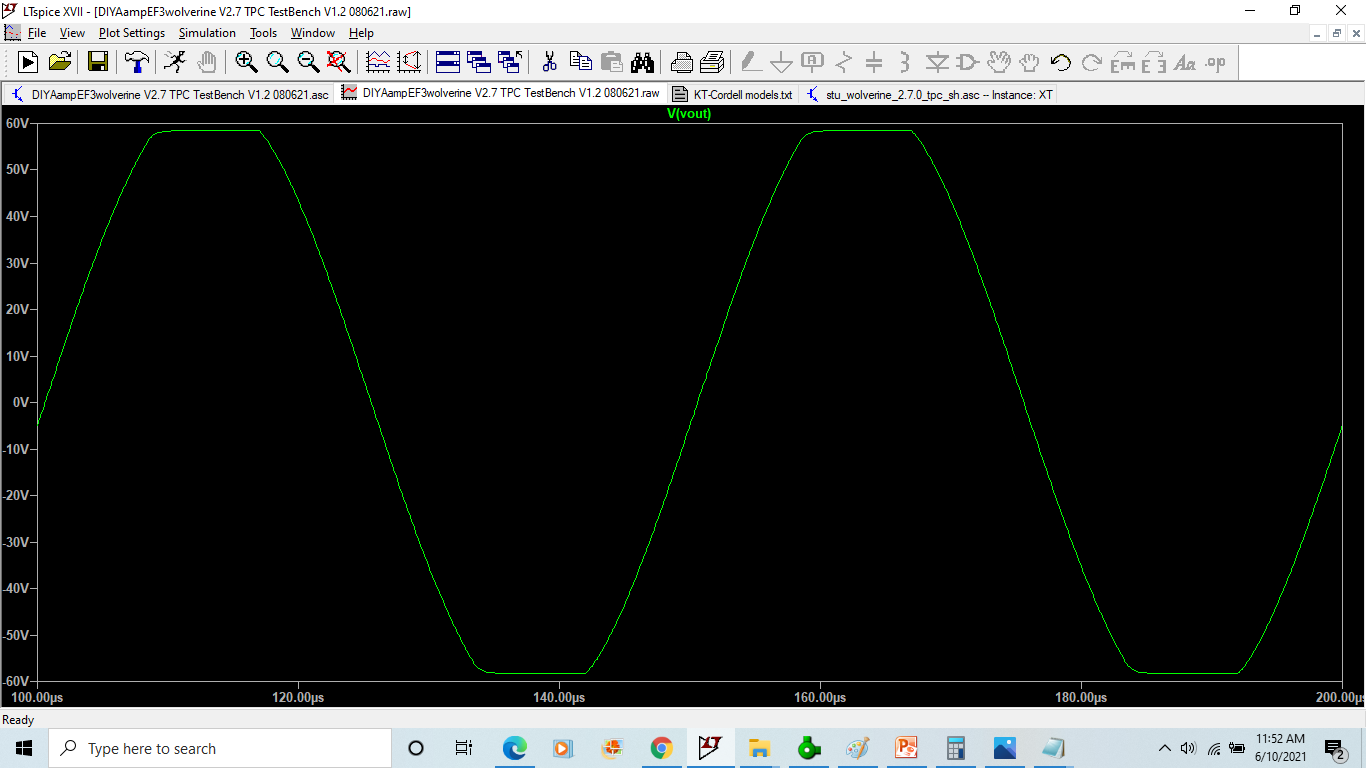

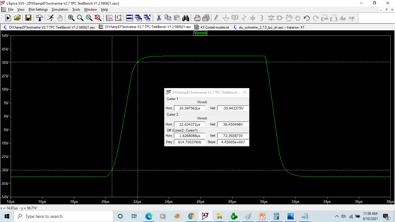

No issues here... slew rate is symmetrical 44V/us. I did a manual measurement so you could see.
No issues clipping... perfect
See pics below
-Left picture is slew rate measurement
-Middle picture is clipping 20KHz into 8ohms
-Right picture is clipping 20kHz into 4ohms
Jeremy

On Post#1161
The left picture is Driver base resistor = 0ohms
The right picture is Driver base resistor = 100ohms
Jeremy

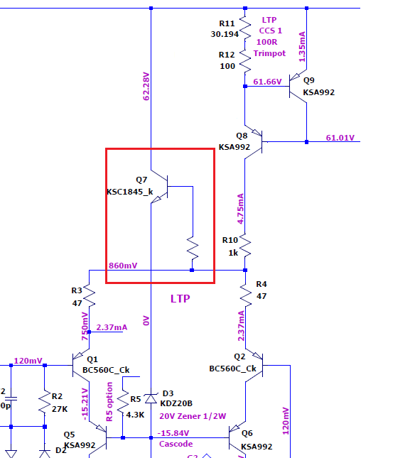

Hey Guys,
I wonder if Q7 base should be tied to the bottom of R10 rather than the top side. This would prevent the cascode voltage on the diff pair from changing depending on the tail current going through R10. Of course this would be a minor layout tweak.
Sounds like a good idea to me. To be honest, to this date I have never heard a good reason to have R10. So far, I have heard:
- It provides an easy way to measure I_tail since the voltage across / 1000 would be the current. I guess that is fair since if R11 and R12 are variable, it is hard to tell what the current is.
- It Isolates the capacitance of the tail current source from the diff-pair. That is unlikely since if COBO of the transitor is ~5pF, the frequency where it would matter is ~32MHz.
- I reduces the voltage across the CCS transistor. Maybe, but a 5V or so reduction is not that much to matter.
Maybe the first one is the best reason.

The main question was not that series resistor R10 on the CCS was installed or not but if the buffer transistors Q7 base for the zener /cascode should be tied toward the CCS end or the Diff pair end. With the buffer transistor Q7 base is tied to the top side of R10 the cascode voltage will change depending on what current is going through R10. Moving the base of Q7 to the bottom of R10 the cascode voltage will be constant with tail current.
Jeremy
I would keep this configuration since Stuart has a valid point about the PSRR. Although considering the rails are already filtered I don't think there is anything to fear from either option.
Thanks KT, it was actually Jeremy's idea I just posted his question for him as it was late in the evening his time.I would keep this configuration since Stuart has a valid point about the PSRR. Although considering the rails are already filtered I don't think there is anything to fear from either option.
