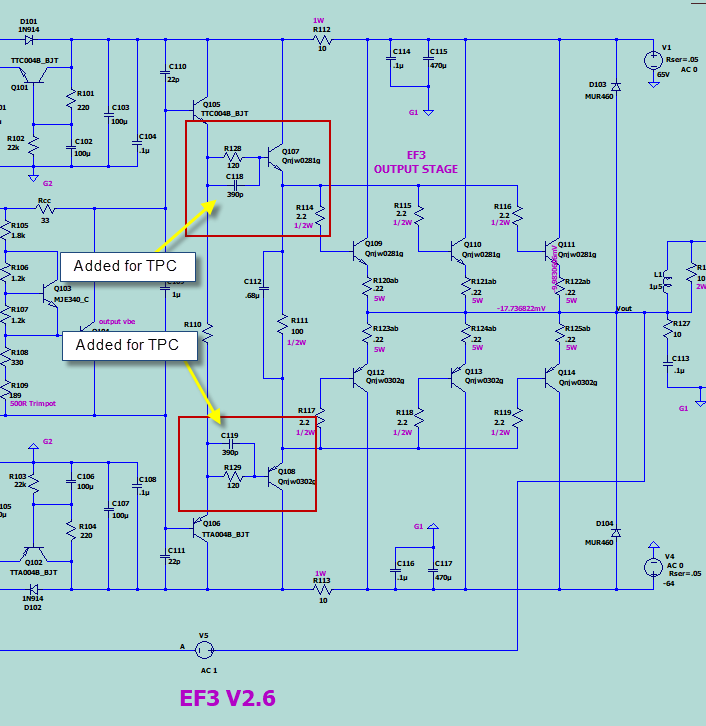

EF3 Board updates to support TPC
Hi Guy's,
I added the parts to the EF3 board and did a creepage check.
  • DIYAampEF3wolverine V2.6 TPC.zip

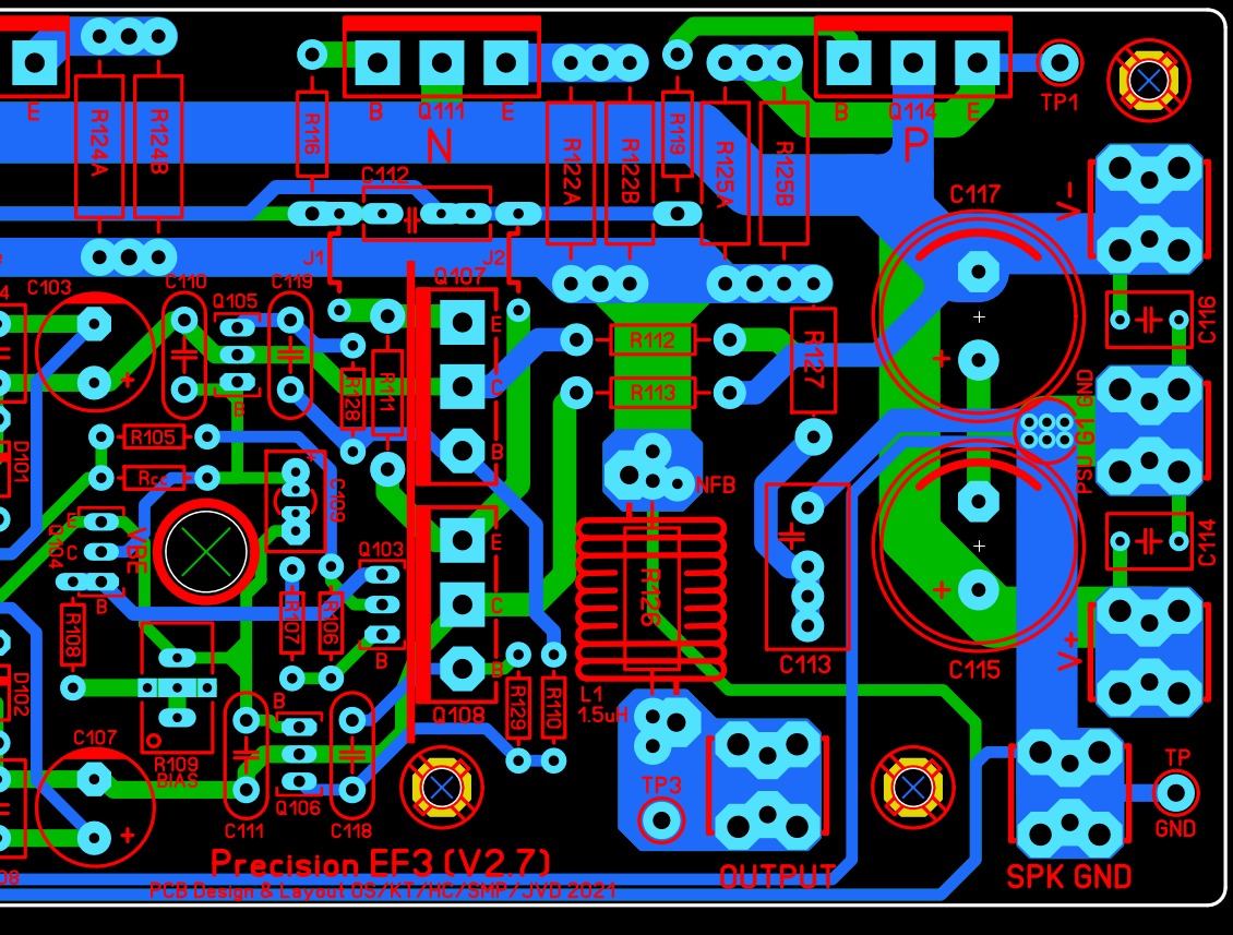

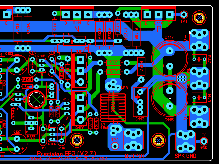

Hi Guy's,
That looks great Stuart. I'd like to change R128/129 to 100ohms and C118/119 to 470pF. This will be a little less lossy and works just as well. If there is 10mA of base current into Q107/Q108, R128/R129 at 120ohms will drop 1.2V vs 1V at 100ohms. If the base current is higher, well you get the picture.
Those RC networks really squash gain peaking tendency in the triple around 5-10MHz.
Jeremy
Hi Guy's,
Awesome!
FWIW the 120R and 390p in the OPS isn't specific to TPC, it helps gain margin for TMC or plain old miller compensation equally.
Jpc2001,
Try post #1116
Holy heck. That gets the wolverine down to 6.5ppm of distortion for a 20kHz sinewave. The tallest distortion product is the 3rd harmonic but even that one is >106db down.
I wouldn't have guessed Early effect from the VAS buffer was contributing enough to show up -- even if you just ground its collector, that only brings distortion to 10ppm -- this is better.
Geez that's almost worth building another amp to try out. That's brilliant.

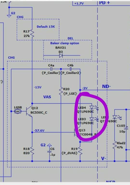

I'll try and make these changes too over the weekend. Screenshot_20210604-053405_WhatsApp.jpg

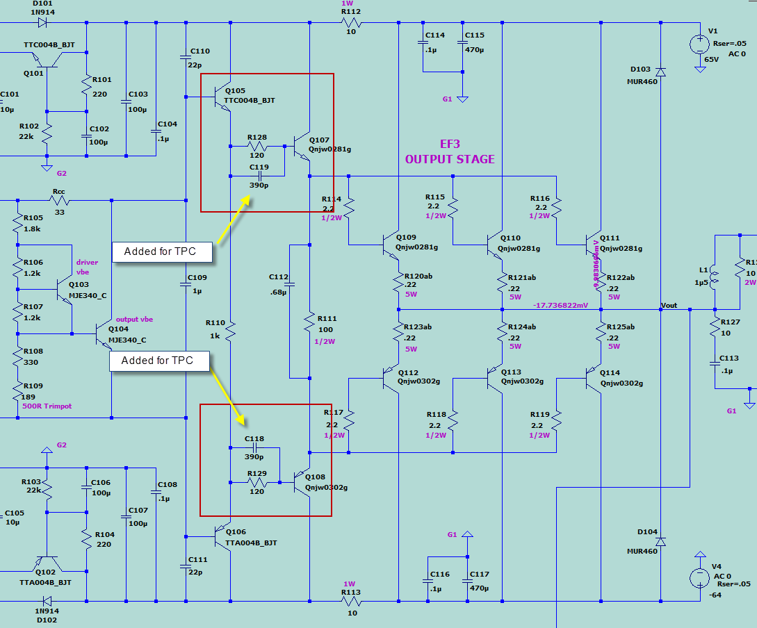

The resistors could be replaced with wire or low ohm resistor if you want. So it can be configured both ways. Bench tests will confirm the final config.
I was changing the R to 100ohm and the C to 470pF looks pretty much the same as 120ohm and 390pf. The R could maybe be reduced a little more with the appropriate C increase.
I think it would be prudent to consider more factors than just stability compensation, this doesn't seem like it has been properly vetted. Some compensation might be achieved by adding a base resistor to the Vbe multiplier transistor mounted on the driver heatsink and perhaps also the one mounted on the main heatsink. This in turn will probably affect the Vbe multiplier ripple compensation resistor as well.

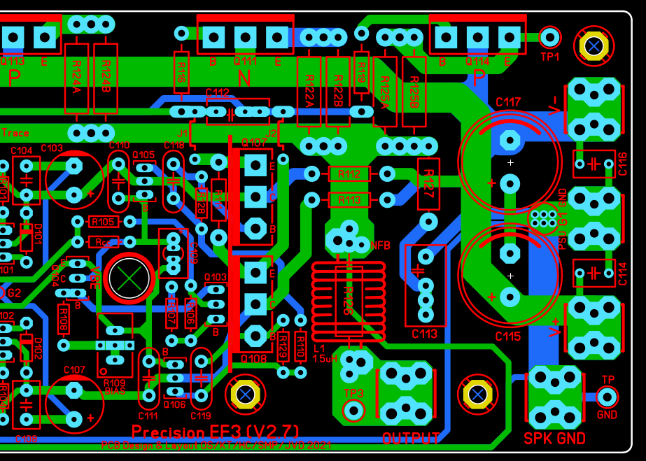

Joined 2016
Hi Guys,
there have been a number of good suggestions presented here.
We really need you to post schematics so they can be discussed and simulated BEFORE Stuart changes the PCB.
As you know, making changes to the PCB is very time consuming and nerve wrecking.
Thanks.

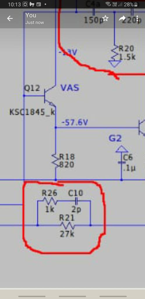

Hi Guy's,
Harry has selected these parts as candidates for the RC network over the feedback resistor.
Mouser
C10 = RDE5C2A2R0C0P1H3B
R26 = 71-CMF501K0000FHEA
Considering the space I have, I think these are good options. I'm trying to minimise the amount of vertical space this takes up. Screenshot_20210603-221328_WhatsApp.jpg
