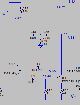

Hmm, the VAS Baker clamp diode contributes to simulated distortion, quite a few ppm.
It would be nice if we didn't have to trade off distortion and "civilized" clipping. The alternate Baker clamp below accomplishes that.
It works by letting the VAS buffer drive the (nonlinear) diode reverse leakage current, so the IPS doesn't have to. The 1k resistor connects at the base of Q13, not the emitter of Q12, so it can discharge the Cob of Q13 during slews.
We don't need a fancy super-low-leakage diode -- any old 1n4148 should do OK. The only downside that I see is it requires one extra diode.
Simulated distortion falls from about 16ppm to about 11ppm for a 100W / 20kHz test sinewave with this change.
We can reduce distortion further, as others mentioned, by reducing R17 to reduce the voltage it induces at the collector of Q12 (and whatever Early-effect current that exposes the IPS to.) I played with "flipping" the VAS buffer to a PNP, which removes the need for any current limiting, but it's more difficult to bias it and I was throwing too many extra parts in. So to heck with that. Anyway the distortion contribution of R17 seems to be pretty low.
The only thing the Baker clamp does here is prevent Q12 from driving it's max current into the VAS base. It goes into the collector instead. However I don't see why the TTC004B would have any trouble handling that current with R17 set reasonably. Is there a need for a diode to begin with?

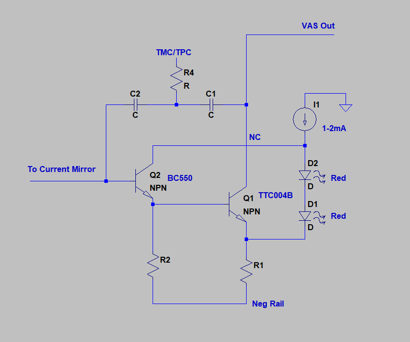

Dadod has a neat trick to deal with this. Requires 1 resistor only.
See slide 12
http://hifisonix.com/wordpress/wp-content/uploads/2019/02/Anti-Saturation-Diodes.pdf
See slide 12
I thought the purpose of the Baker clamp was to prevent Q13 from saturating during clipping so that it can recover faster and not "stick" to the rail as much. That and reduced THD were my goals in redesigning it.
This question was the basis for the developing a better VAS in the Honey Badger thread:
diyAB Amp - The "Honey Badger"
If one studies the VAS design they could figure out how to apply the same principle for clipping here.
Yep, that's the idea. When Q1 saturates, it's base current is drawn from it's emitter rather than increasing the VAS output voltage, averting positive feedback.
Also the BC capacitance is bootstrapped on the buffer transistor minimizing BC capacitance modulation.
Yes, as well as base modulation from Early effect, which can be a significant distortion from that transistor.
KT you're right, we don't need the diode. So what is the original Baker clamp diode doing? The amp clips fine without it. The VAS transistor saturates, and then no rail-sticking happens.
I guess the clamp reduces current at the VAS emitter during clip by a few mA, so you get just a few hundred mV more headroom. (Is that all?)

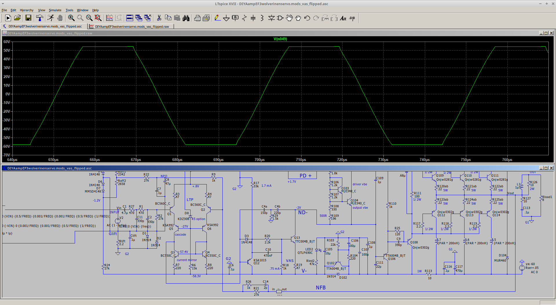

Here's an arrangement with the VAS buffer flipped around to PNP. It gives the same headroom as the original design with Baker clamp, but with less distortion (11ppm).
How this works: R20 raises the voltage at the buffer enough to keep its base in the region where the current mirror can drive it. D3 prevents the buffer's B-E junction from going reverse-biased during negative clip. C10 reduces distortion.
With the buffer flipped, R17 doesn't see a surge of several mA during clip, it conducts a constant 1.7mA.
