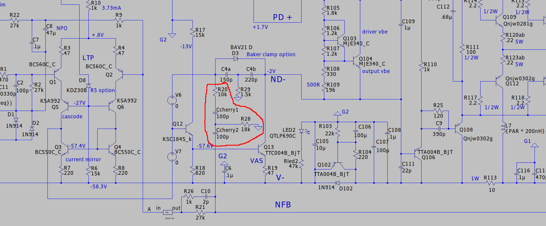

Oh yeah -- I reinvented dadod's OITPC. There's nothing new under the sun!
I started with plain TPC. Then connected a "Cherry" cap from the output rail to the VAS input. The size of this cap controls the in-band loop-gain over the IPS, you can select it anywhere between ~30db and ~60db.
Then add a series resistor so the Cherry cap doesn't reduce stability margins >1MHz.
That's already pretty good at reducing the AC response peak, though it's not totally gone. I set loopgain over the IPS at ~40dB.
Getting crazy now: you can split the Cherry cap into its own little TPC network, to yield a few more dB of in-band loop gain over the IPS without making peaking worse.
It looks complex, but the sim is good. Minimal overshoot, 44db of in-band loopgain around the IPS, 56db around the OPS. It's easy to find values that work, surprising for the complexity of the network.
That's enough "adventures in R&D" for today. To be clear, this isn't a proposal -- I'd more likely build with plain old TPC and a 2nd-order RF filter at the input. That stops the small-signal overshoot and preserves all ~60dB of loopgain around the IPS. Probably not a bad idea anyway to "tune out" radio noise!

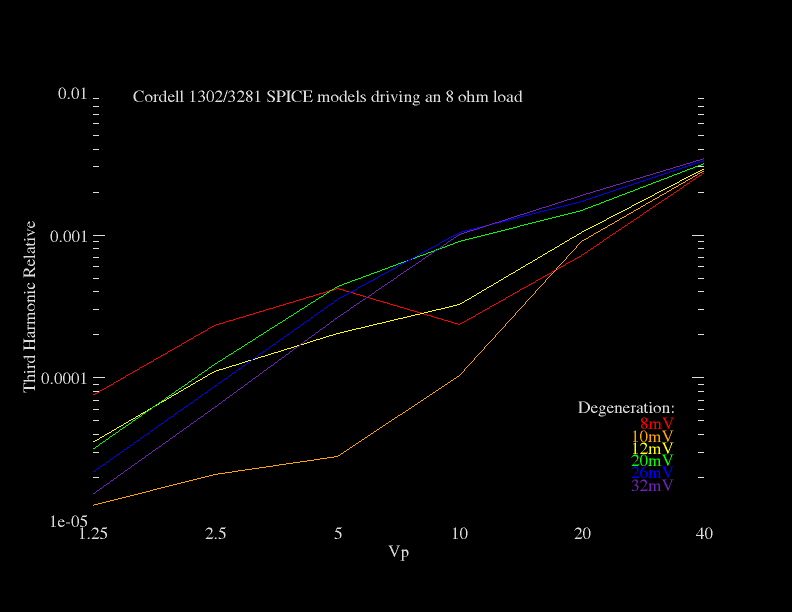

Here is a chart I made years ago which seems relevant. Note that it is only the 3rd harmonic.
Notice that at 26mV temperature drift doesn't make much difference whereas at 10mV degeneration, just 2mV has an enormous effect. At lower degeneration voltage you need better bias stability.
Notice that at 26mV temeprature drift doesn't make much difference whereas at 10mV degeneration, just 2mV has an enormous effect. At lower degeneration voltage you need better bias stability.
Very good point. I did notice that. As you lower the RE voltage drop the distortion comes down slowly but go to far and it very rapidly rises. Thank you for providing more clarity to this.
I guess right now if myself and others are simulating other circuit mods we can temporarily set the RE voltage to this level knowing it will provide low distortion.
My RE voltage in the post above should have been 17.1 mV
