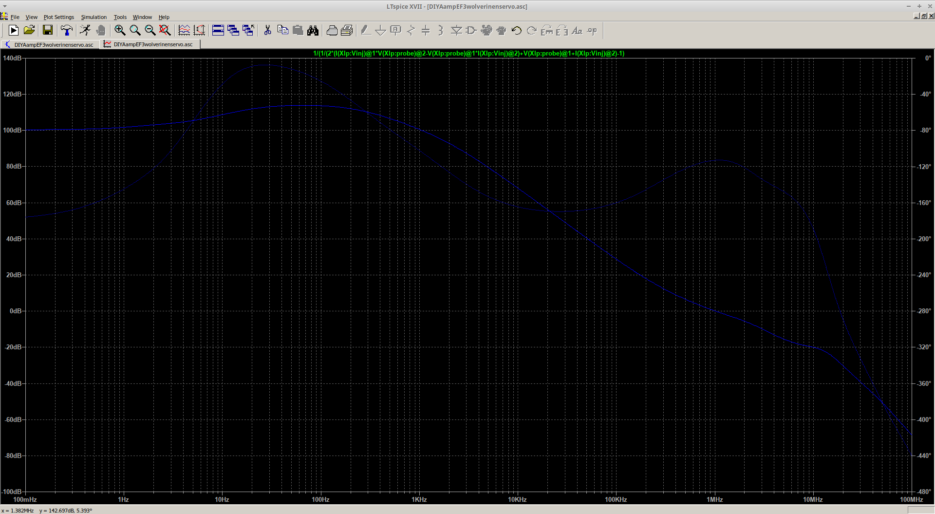

Let's check the stability of the wolverine from comment #612:
That 7MHz "hump" eats into gain margin which is a bit less than 10 db. Kinda skimpy -- can we do better?

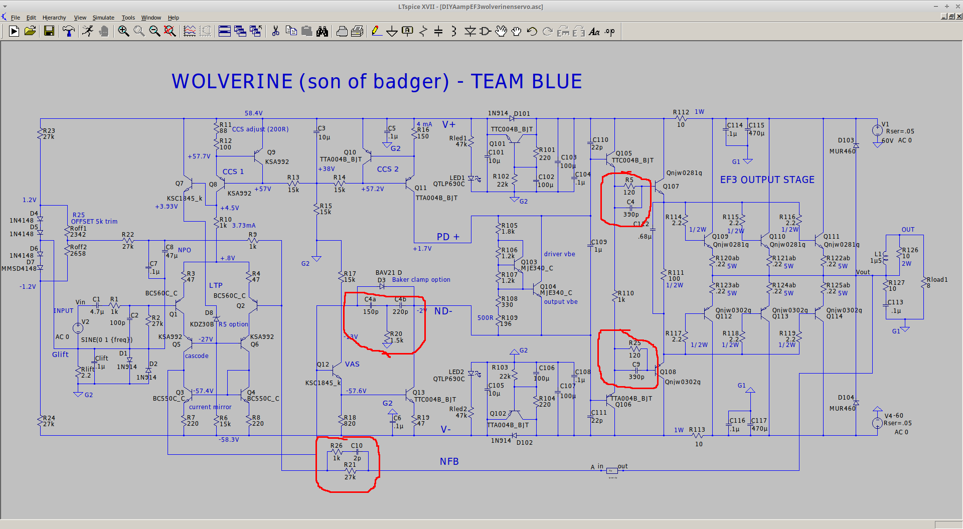

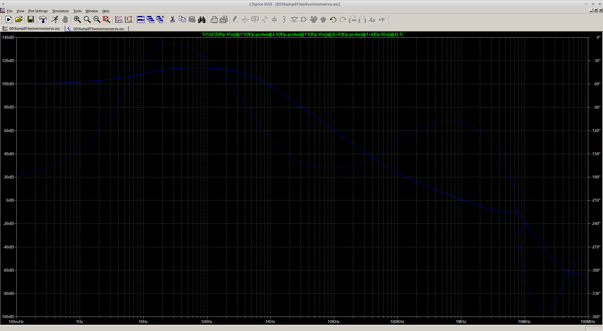

Here's TPC, plus a lead cap, plus a zero added to the OPS:
Now we're cookin with gas: 70 degree phase margin, 20db gain margin. This is radically stable:
That output stage zero idea is "stolen" from the NAD 2600A. My 2600A is a long time survivor. (They're "Not All Defective.")
TPC puts all that loopgain around the input stage too -- probably around 20db more than TMC does at treble freqs.
That keeps input stage signal current in the nanoamp range even when driving rail-to-rail output. We know from Self's work that DC current balance is super important for input stage linearity. Why would we allow AC currents to take it out of balance? Why make the IPS charge and discharge a bigass miller cap or TMC network? It doesn't have to -- this is the magic of TPC.

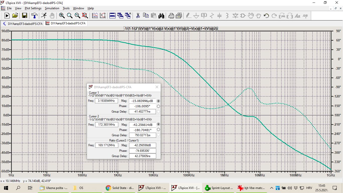

Regarding GM, CFA IPS attached to the 3EF OPS (not changed to the OS one) here is LG and GM shows about 42 dB, LTspice file is in post #1006 https://www.diyaudio.com/forums/sol...e-son-badger-suggestions-101.html#post6655230
