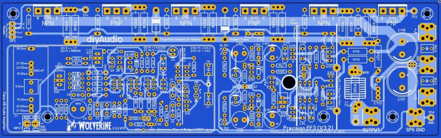

Hi Guy's just to add to what Jeremy said. Jeremy, myself, Harry and Johnno have been working on this in every spare moment that we have had.
Jeremy even went to the extent of measuring the trace inductance of the first prototype pcb on his network analyser so we could incorporate those measurements into the simulator.
The drivers have been changed to MJE15032G and MJE15033G and proper heatsinking has be calculated tested and implemented on the new pcb. All in all the new pcb is far superior to the last.

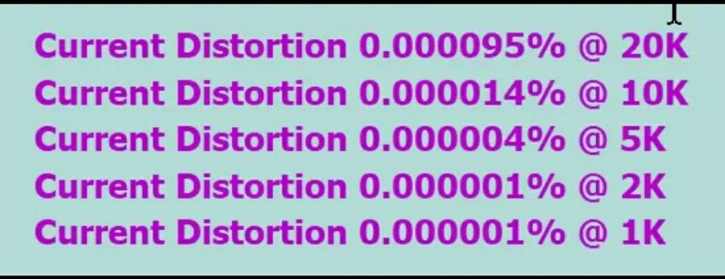

Current simulated distortion 100w into 8 ohms

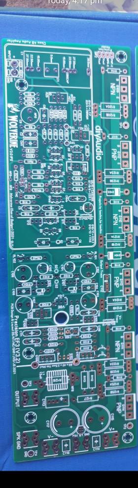

Still WIP at this stage as no prototypes have been made at the moment. I only just finished and ordered the pcbs yesterdayI guess I'm dense, but what build guide...? 🙂

Everything is still moving along... We found some mechanical alignment problems, lead spacing of components, hole sizing, and the big one - the driver not wanting turn off properly without turning the predriver into a space heater. We felt it was necessary to fix these issues on the pass 2 prototype and forget about building the pass 1. The design overall is much improved and I believe we are ready to order boards again. Sorry for the delay and not keeping everyone up to date.

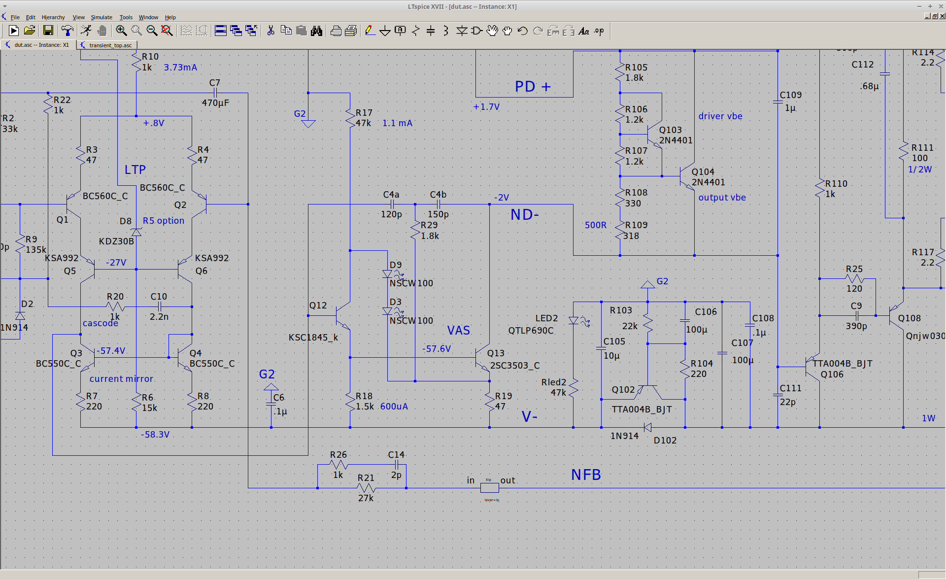

Here's an improvement to the TPC build option. It reduces distortion a couple of dB in the treble range. It doesn't require adding any elements, it's just a connection change: instead of bringing the TPC resistor to ground, connect it to the VAS emitter.
This reduces the nonlinear current that the IPS must feed into the TPC network: voltage on both sides of the first TPC cap now "bounce" along with the nonlinear voltage at the VAS emitter so they cancel.
This doesn't affect stability margin. Just cleans things up a bit without changing how the circuit works. I didn't even change any component values. Sometimes it's the simple things 😀

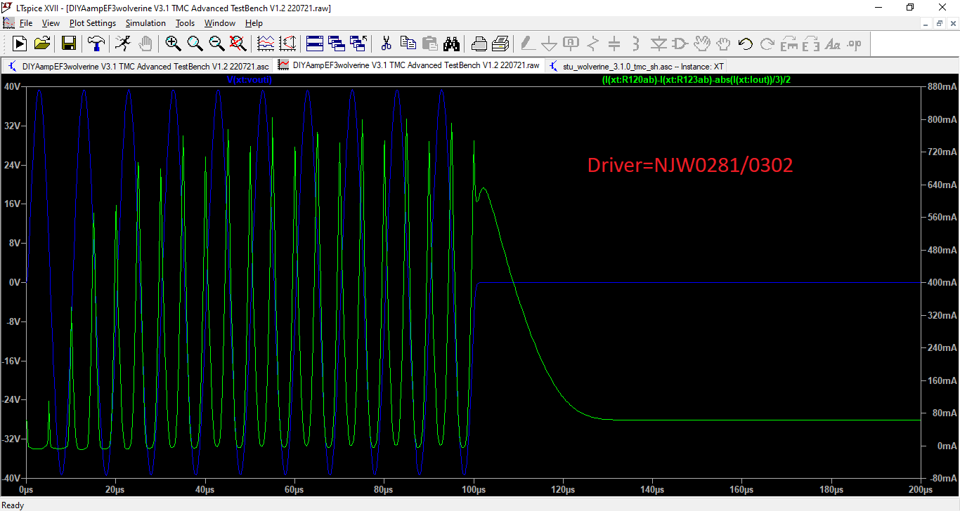

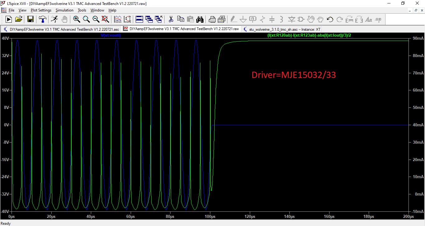

For the plots taken below:
-100kHz, 10 cycle burst
-Predriver bias resistor=910ohms
-Driver bias resistor=91ohms
-Cap across Driver bias resistor=1uF
The green trace shows the cross conduction in a pair of output transistors. I did some math to remove the signal from the bias, so you are left with the dynamic bias between pairs. During the zero crossings the bias through both transistors should be about the same as the idle current.
Notice how the cross conduction in the outputs is worse with the NJW0281G and NJW0302 when they are used as the drivers because they are not getting shut off properly by the predriver. The cross conduction problem can be resolved by lowering the predriver bias resistor and adding a .1uF cap in parallel with it but then the predriver transistors are dissipating a lot of power for a TO-126.
Changing the driver to the MJE15032/33 eliminated these issues and keeps the predriver much cooler. Using NJW0281/0302's for drivers is unnecessary to drive 3 pairs of outputs anyways, more like overkill.
Jeremy

Good idea we are already looking at that. Too bad we just ordered pass 2 prototypes... We can get that into the final version hopefully.
On your schematic, I'd change Q12 to a low VCE and high beta transistor.
Jeremy
