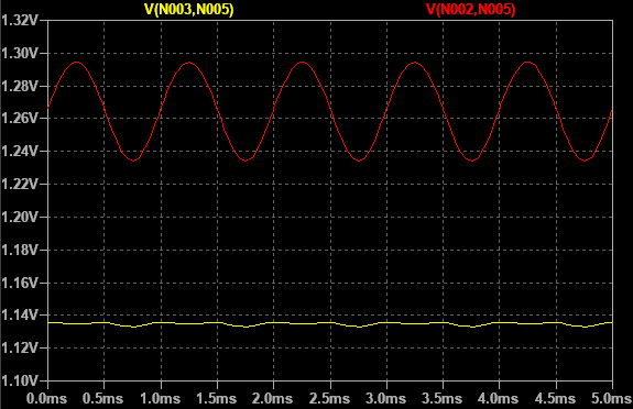

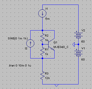

I simulated both, VFA and CFA and good value for both is 75 ohm.
The value should be equal to the effective resistance of the Vbe multiplier. That changes with VAS current, but also trimmer position. So there is a bit of jank to it...
In simulation you can connect a sine current source across the Vbe multiplier to determine it's dynamic resistance and then see the invariance after adding the resistor.
What if we put Rcc in the frontend module? We have to run an extra trace to the Vbe multiplier, but I think that would be fine.
In this example the sine current source has 2mApp and the Vbe multiplier shows 60.4mVpp so the effective resistance is 30.2ohms.
Second picture shows bias voltage with and without the compensation resistor.
I simulated at VAS current 4 mA and bias of 90 mA for both VFA and symmetric CFA. For different bias(different trimmer position) it is not perfect but good enough.

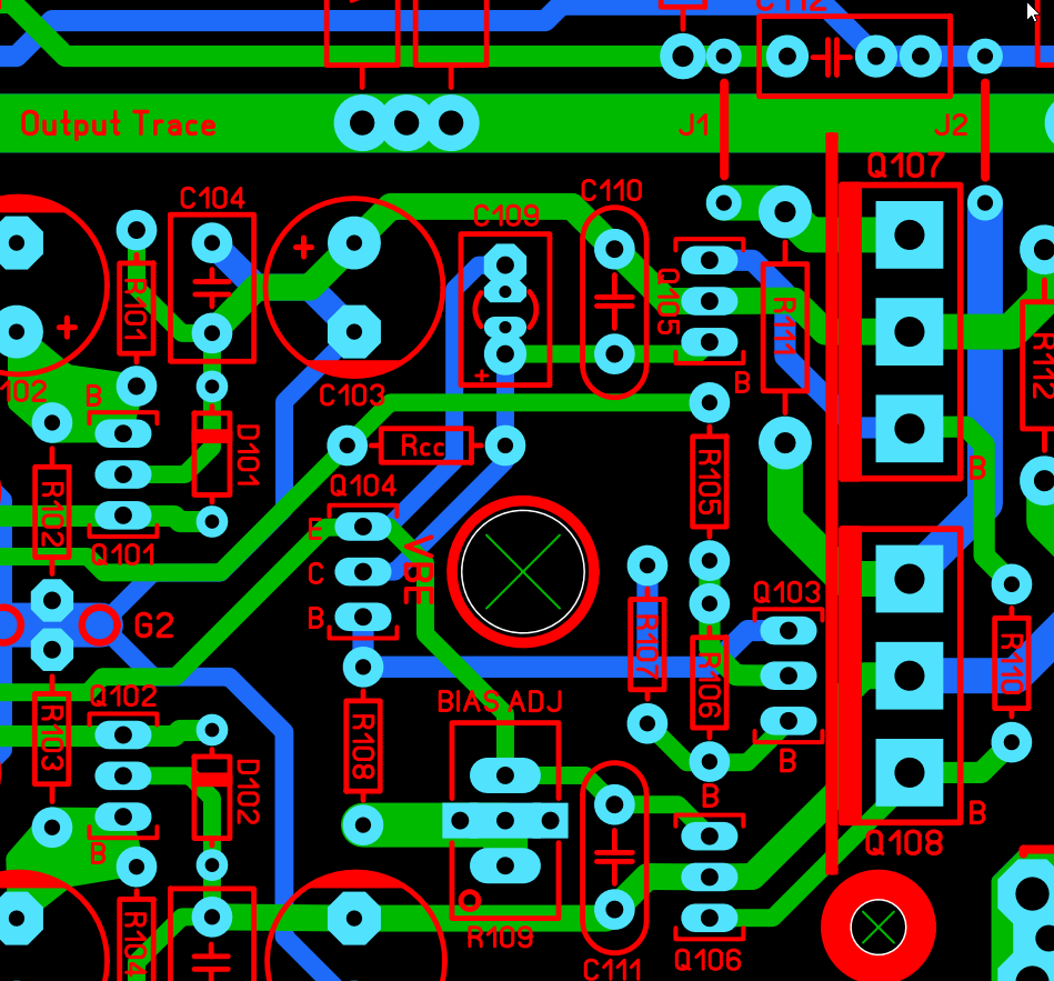

Neater Route Option ?
Hi OS,
This maybe a neater route option. I'll e-mail you my file
Had to redo the Vbe , neater now with "Rcc" (Self resistor). Badger had
it. I can be an option. Safe !!

Another long trace ? nah.
Here is Rcc right on the Vbe decoupler (below). C109 is just a 2mm LS
electro. It does not need to be any special thing. I remember I just used
a 1uF 35V wima on my 5 OPS's . Might make ... yeah 2 + 2.5mm for the wima. (below) real tight Vbe now.

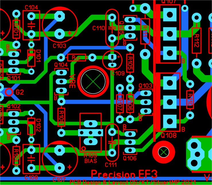

OS, you personally told me that, "it would be best to give the user the option to use a film cap for C109"Another long trace ? nah.
They are itching for this project .... let's get er' done !!
Stuarts aligned package with the Vbe update.
OS
Were you currently have C109 that doesn't allow people to use a film cap.
Couldn't you move C110 to the left?
This would allow C109 to fit as it was before and give the user the option of using a film cap.

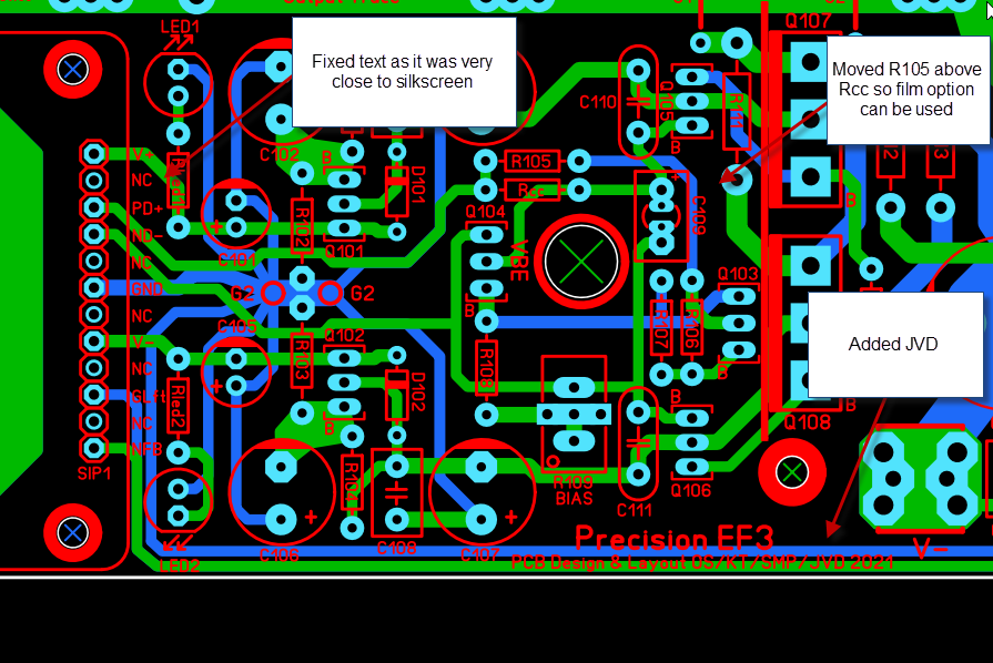

Film Option
Hi OS,
This may work.

What's with the rush for PCBs you guys???
Keantoken came along and made improvements. Dadod is now on board and has improved the design.
Take your time OS. Most of us don't want to see a "compromised" PCB after all the time that you have spent on design over the years.
Side note: I've always admired the way Luxman made their PCB for the amp you posted above. Copper buss bars on rails and output, regulated front end etc.
Also the PCB needs to be flexable for various componts that people want to use eg film caps.
When prototypes are made people like Jeff and Stuart have the equipment to test the amps for fine tuning.
