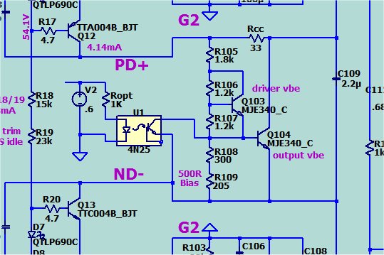

I re-thought SIP 3 , most of these high-end amps must have inferior
Vbe arrangements. Needing so long for warmup to stabilize is rediculous.
My Slews would immediatly stabilize. 70mA cold .... might drop to
65-68mA hot. Slightly negative co-efficient.

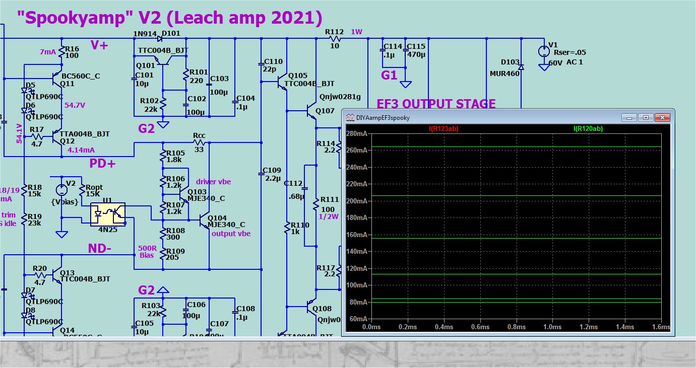

Might be better with Rcc. Just thought it would be a neat addition.
With a micro ,
-thermal overload could back off bias to a near class B state.
-the instant warmup scheme.
-"Audiophile" high bias AB (with a limit).
Since you use a lot of them -
-any recommends for a BJT one ?
-what do you do with the base .. let it float ?
-simulation shows a very low voltage to trigger the BJT. Infrared
LED ??
PS -SIP 2 can already serve as V/I and DC detect. Mouser 2 ended
female board to board connectors are common.

I always use optos on switch mode as a digital input, usually HCPL2530 but I remember Valery mentioning a high linearity version that he used. I'll need to do some digging to find a part number. Yes the base is left floating. Preferred devices don't have a base connection to reduce the possibility of interference. CTR is the rough equivalent to transistor gain. One hurdle you will run into is the analog output of a microcontroller is PWM so it's not straight forward using it in an audio circuit. A digital pot might be a better option.

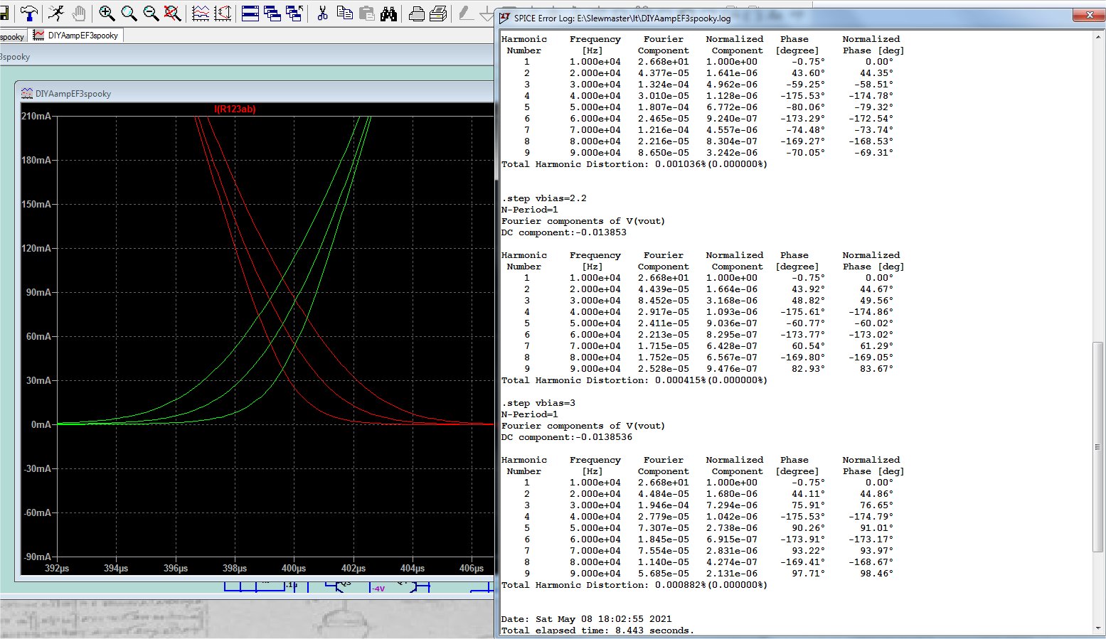

Why not just step it externally.
What DAC could not provide 4-5 simple voltage steps between (0) 1-4V ??
Ropt at 15K limits the steps max deviation.
Thermally simulating Q103/104 shows normal co-efficient regardless
of step. Bonsai must of done this before the micro age.

"Bonsai must of done this before the micro age."
:D
The idea behind the circuit is that you use a standard Vbe spreader (they generally work well, but only over a limited range!) to provide 1st order compensation, and you then use the controller to trim the spreader so it works over the full expected temp range. You would have to go through a calibration cycle, but these things are easy to do in software.

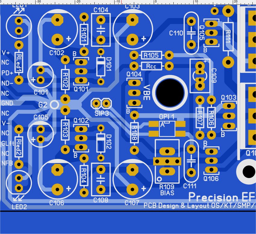

I posted this concern a while back and no one responded, so I'll bring it back up one last time. Basically it's about Q107 & Q108 positioning.
On page 76 post #757 shows a picture what I'm getting at.
DIYA store "Wolverine" (Son of Badger) .... suggestions ??
Disregard if you don't think it's a problem
Both the Sanken 2sa1186 and ON njw0302 holes will sit @ 17mm H with full
insertion. A mje340 is a full 22mm from hole to lead end. No issue here.
Width , the Sanken is a little fatter at 2mm (lead to back) , MJE340 is 1mm
lead to back. ON 0302 is 1.7mm.
We only need 2.7 - 3.2mm max between leads. We have 6.6mm V2.42.
insulator + HS can be 3.4mm . standard 1/8" AL plate is 3.2mm perfect.
The M3 would be about 10mm long to screw the MJE and the NJW together.
MJE + sanken might need a 12mm M3.

I chose the $.88 HCPL-817 , just a modern faster 4N25. SMD-DIP-4 .. oh
no !!! Will they freak ? :D
