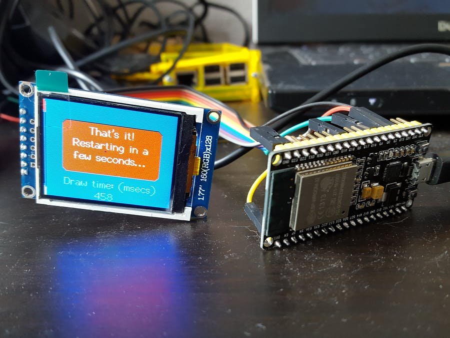

Ice cubes and fire symbols ....
And run all this , soft-start, temp , V/I , DC with (below).
Bias could get ice/smiles/ and flames. Just seen
the GUI development apps for ESP32 w/ ST7735 color display.
Watch your cap banks charge with a battery icon (soft start phase).
Fancy , fancy.

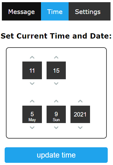

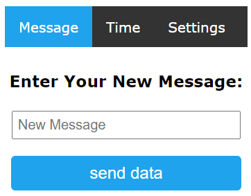

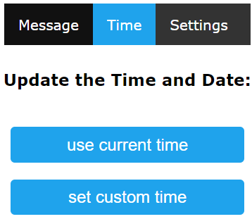

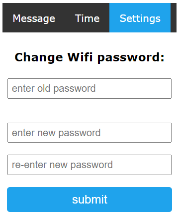

For anyone new to ESP8266 not not new to programming. Here is an example of a small clock I made for my desk at work. The library versions indicated much be used. Im not using the new json parser.
Just an example of handeling webpages to be served by the esp itself.
This project creates its own Access point and does not connect direct to internet. I did not spend much time on making the webpages it serves to be pretty. But they are nicely viewable on PC and mobile.
Instead the user logs into the wifi hotspot provided by the esp.

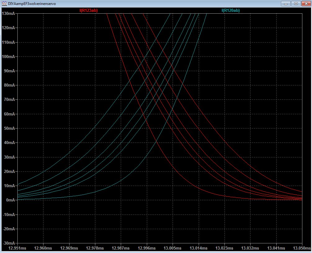

The opto is just a precision fine tune of the existing main bias trimmer.
Luckily , default is still the trimmer. I set up my simulations with default
at 40mA , where the window of very low distortion begins at high power.
Sankens even do better AB @ 50mA , ON 70 - 80mA ... different silicon.
(below) is what range a 100K trimmer in series with a 47K would give
hooked to a 5V supply (though the OPTO). the bottom (40mA) step is what switching the
opto out of the circuit entirely would have.
I saw your EF3 Vbe , single device Vbe's are adequate for EF2's.
My oldest amp , Sansui EF3 .... set it high cold (80mA) , has negative Tc.
Ends up 40-50mA when hot. HK , 80mA .... 0C to 70C (+/- 3-4mA).
Drops that 3-4 from 40C-70C.
So , just a front panel control. 110mA limit , I noticed no issue running
5 of these same designs anywhere within this range.
Best to leave any automated (or refined) bias control to a micro. Just
