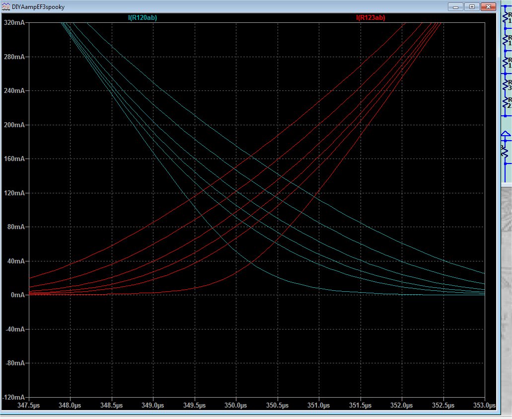

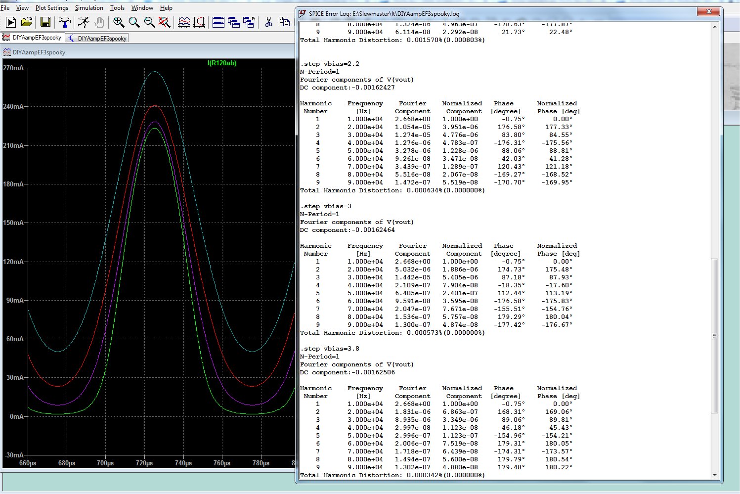

Pretty linear ... every .8V gives just about exactly 40mA more bias.
0V defaults to the trimmer.
2.2V gives the first 40mA step because the 1.4Vf of the diode. Looks like
a good future option for the OPS. Imagine programming just a few user
steps ( toggled by wi-fi ??).

Just like in the Spooky the LED's have a neg. T opposed to the trannies
positive one. red and IR's just about negate the transistor.
I always strive for a slight neg. Tc on any design. (safe).
Actually the curve is a hump. This means high ambient for the opto will
back off on the boosted bias (negative Tc).

The opto BJT shunts 60-120uA and the LED uses 70-140uA.
Very sensitive , Q104 still shunts 80% of the Vbe.

Consider that just 20R on the trimmer and a mV or two on Q104's base gets you
that 20-200mA bias range.
