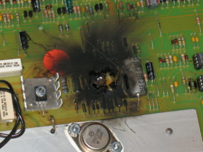

I'm stuck on "magic smoke" , learned that term 10 years ago right on this
forum.

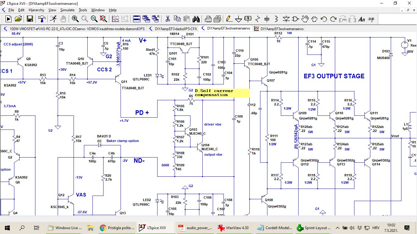

If not to late, I suggest to include so called current compensation resistor (D.Self) in this case it's R5. Without it bias current fluctuate greatly with change Of the VAS current(different reasons, thermal...)
I simulated it and 75R looks optimal.

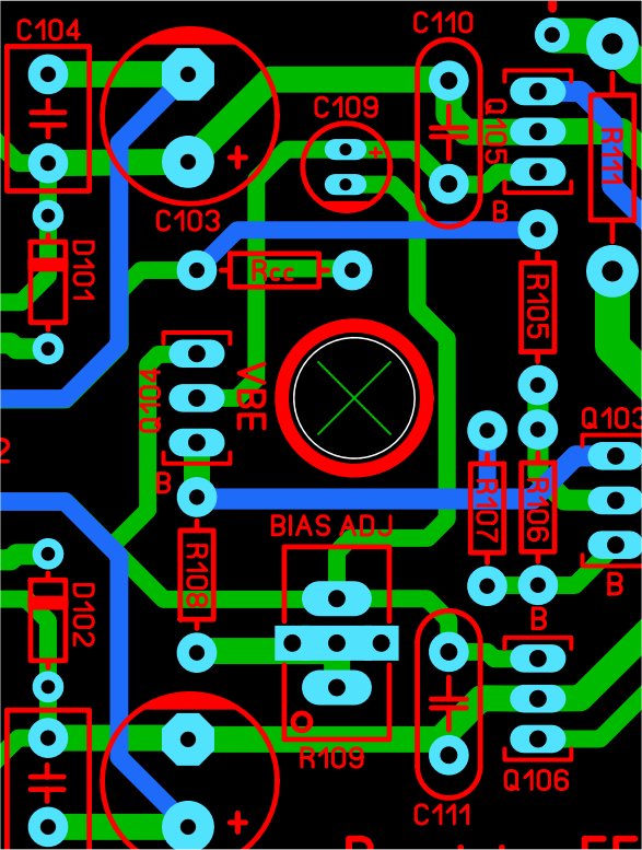

I could easily add your resistor ( or a option component) , I call it "Rcc".
Much space in the Vbe area.

Probably with VFA where VAS current is controlled by CCS is not big problem, but with symmetrical CFA could be, better prevent then be sorry.

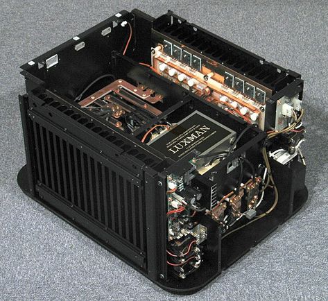

I agree on your major points. Except the "longer traces". It was a 10K Pass
amp that validated your NFB return advice for me. But how does he get away
with a 300mm + ribbon cable length for his NFB ?? I even have a couple
Darzeel schemas with separate OPS boards (also running NFB through a wire).
My last example was the hand crafted luxman ,
with the Japanese hammer guy pounding out 3 custom IE's for the supply per week.
This where I originally got the shielded cable idea (below 1). That is a BF-1000 $22K.
Both the Pass and the luxman are free to put the IPS's anywhere in the box.
The more high end designs I see , the attention to the loop is evident. But
not to it's length.
Your CFA experience guides me to add this "Rcc" option. I knew of the
Self resistor (Badger) , but decided to fine tune the IPS's for rock solid output.
Along with the snowbank to hairdryer testing , it worked.
This OPS could have a CFA plugged into it.
OS

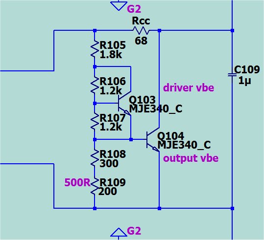

Done
Had to redo the Vbe , neater now with "Rcc" (Self resistor). Badger had
it. I can be an option. Safe !!
Should not "Rcc" be directly proportional in value to the difference between the Badger VAS I and this ?
OS
