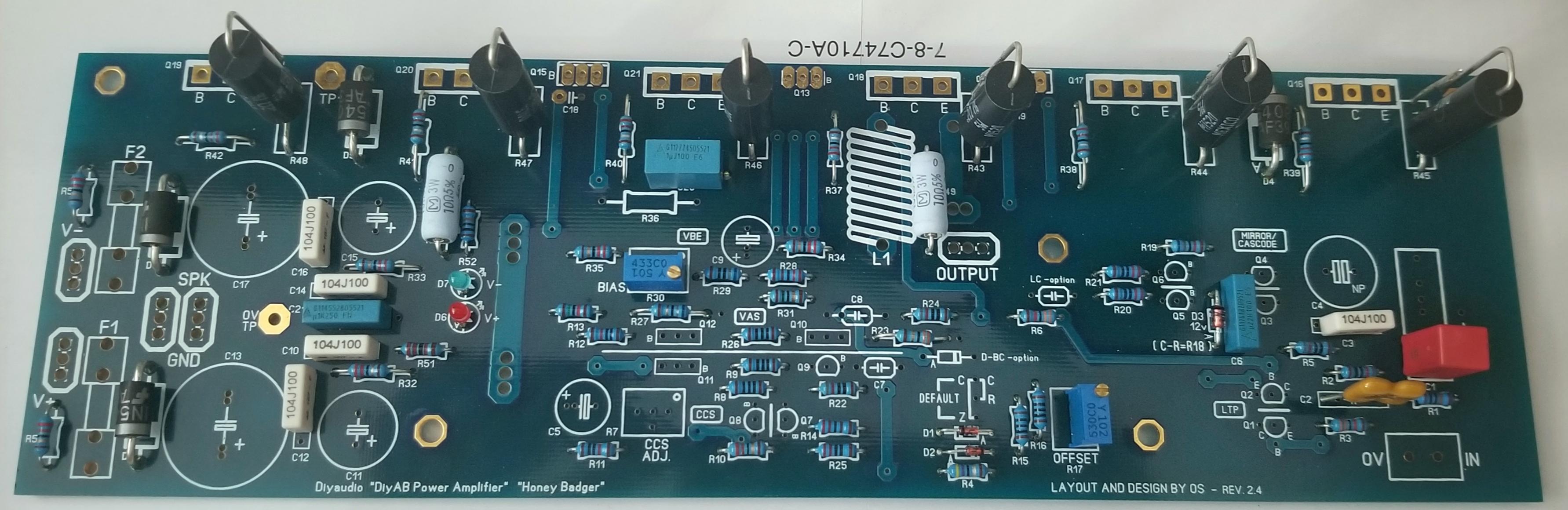

I believe on the original badger you layed it out as a single layer board (bottom layer only). When they ordered the official boards they added the top layer copper to eliminate jumpers, all the holes were plated at the same time making their diameter unintentionally smaller.
I remember doing some research back in the days. So this is what happened ?
Does anybody know what offset the plated through holes entail ?

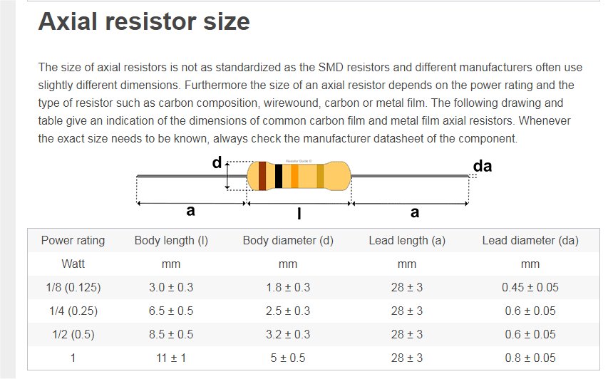

Look at DIN standards 0204, 0207, 0414 use a lead pitch of 10 (tight) or 12.5 (loose) mm, standardize on mm LS, like I use 7.5mm for DO-35
35mil FHS is usually adequate for resistors up to 1/2W, pads can be bigger on the bottom than the top 65T/75B works for me
I am using Vishay MBA0204 and MBB0207 thin films in some designs if you need precision 25ppm parts.
Look at that datasheet as a guide. No barking please

Not sure if it's helpful or not... I used resisters per the BOM. I might not have the prettiest craftsmanship, but everything fit perfectly tolerance wise.
That was my actual first Sprint creation (Badger). First try , Jason still sells
it.

Just to be clear, I was critical of my craftsmanship in assembly, not yours as a designer. The board is beautiful .
This is what I am going by.

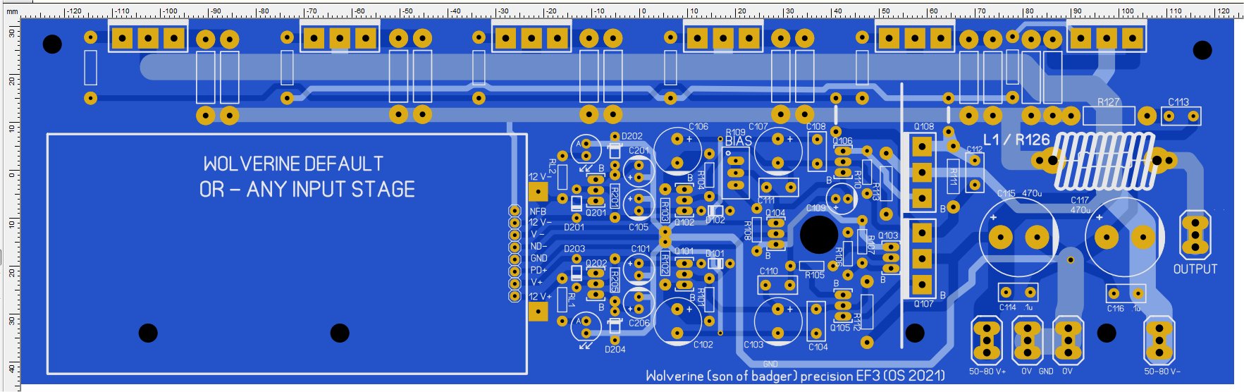

Sorry I feel we exhausted this topic but what is Sprint's default through hole diameter for a 1/4W resistor or did you create the parts manually?
Sprint has default macro's. Reflecting an age gone by. And parts no longer
made.
I just looked up -
the Nichicon UV Z/R as the premium BOM EL capacitor.
https://www.mouser.com/datasheet/2/293/e_uvz-1219460.pdf
Made the macro for both the 6.3mm and 10mm version in a minute each.
To Nichicon spec - 47 or 100u/100v for the 10mm's and either 10-22u/6.3mm.
No 80V option for these smaller caps.
(below) is the result. also , made the diodes and zeners to Vishay specs.
12V regulators are (beefy) all TO-126 ...
Just the main Wolverine to go. IPS/servo , all the services are at the interface.
OS
- DIYA store "Wolverine" (Son of Badger) .... suggestions ??
