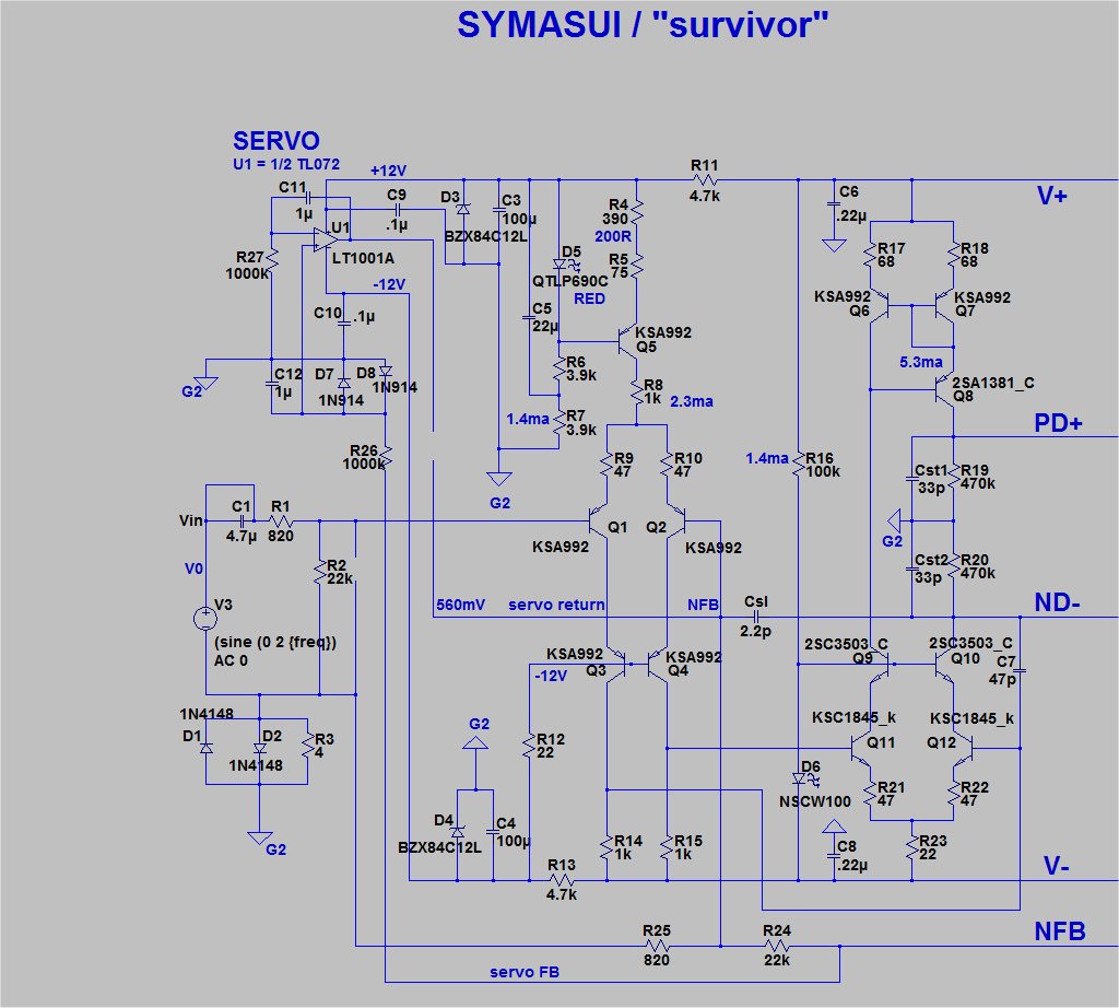

Thank you , I looked over your circuit. I see what you are trying to do with
the cascode. I like your amp design , too. Like my "symasui" (below 1). Symasui is like the HK680 - as is the slew triple EF.
Playing around with the cascode (diodes /resistor/no buffer) seems to
have little effect on THD.
What does have effect is the ratio/value of the 2 pole (TMC) caps + OPS FB.
I was able to shift that .00002% "no THD" zone up or down.
Going too high made my SQ wave ring. 🙄
Where it is between 5-15Khz seems to be the most useful.

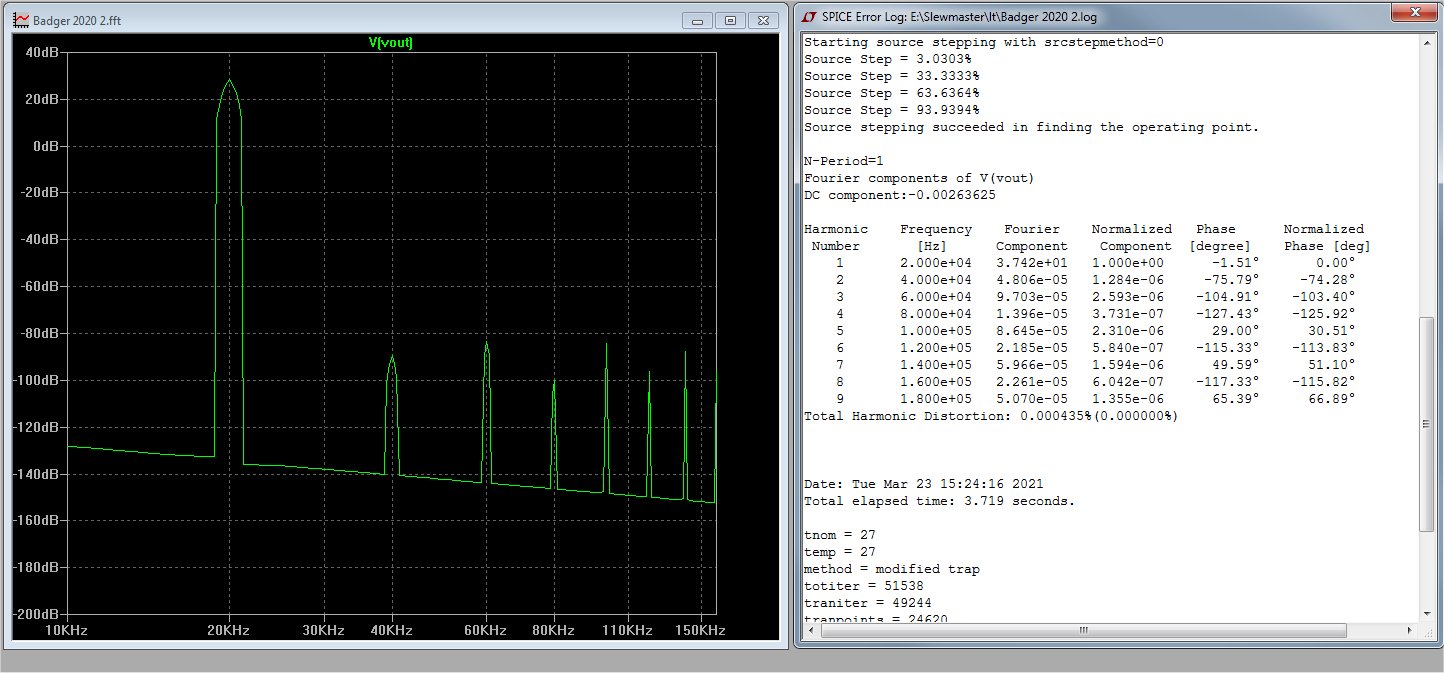

Who cares about 4ppm 3R 20k ?? Ha ha (Below 2).
Interesting that odd harmonics dominate .... at -112db 🙄 .
FFT at 10k is below the simulator floor. This must of been what that English
builder did to his to get his real world 5ppm (AP test).
Nor would I expect it to. Any effects would be subtle. Saved a resistor. Might give a subtle improvement in AC performance, too. Hard to say. The output impedance of the cascode is a little higher if the impedance at the base is lower.

Absolutely. You are boosting the loop gain by lots of dB at the higher audio frequencies. I'm glad you have been open to everyone's advice. You have started with a really nice amp and made it great.

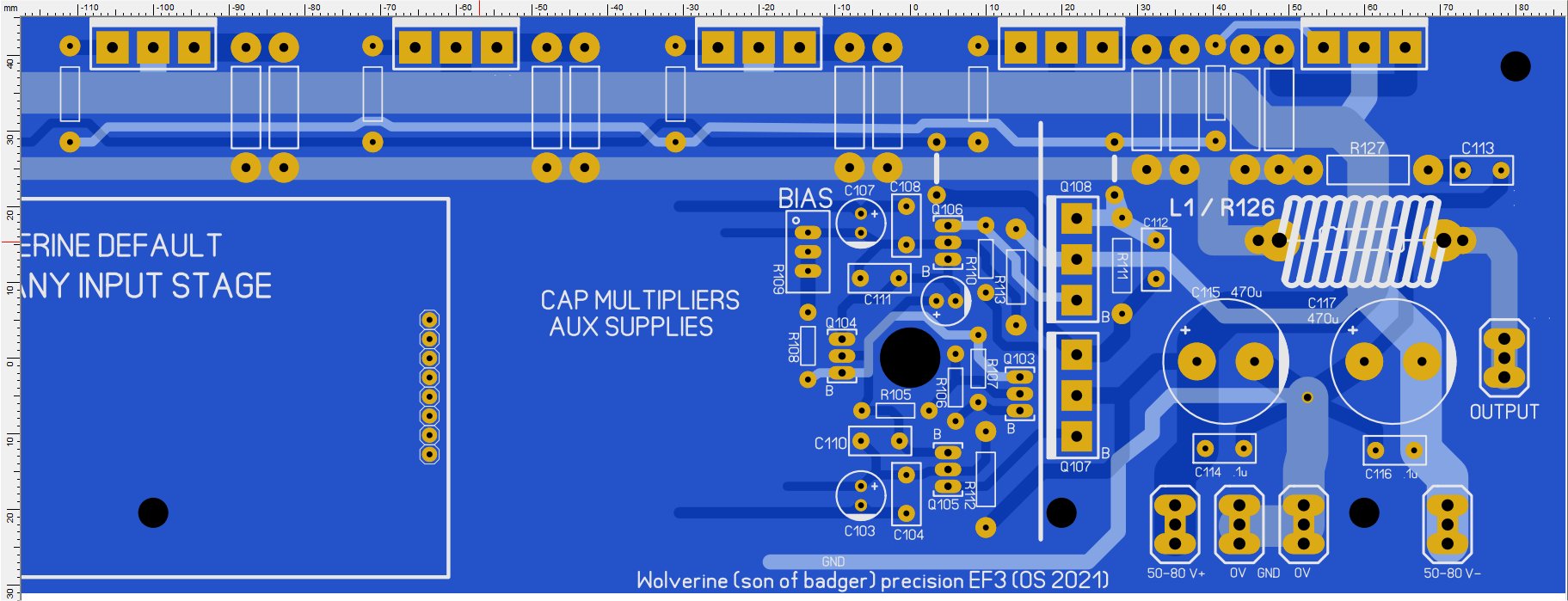

Needs a nice layout (below).
Driver stage /vbe / RC filters done. Enough room for cap mults/ 12V aux.
regulators.
The cap multipliers seem to be sufficient for the job ... just use 220uf caps
instead of 47's if you feel (tweeky/anal).
Questions -
- Is a TO-126 package pinout always reverse from a TO-3p ?
Will a TO-126 stand high enough (lead length) to bolt to a mounted TO-3p ? Do TO-3p/126 both use
M3 bolt size ? - I want to bolt Q103 to the back of Q107.
- Like it says on the board , I will make the 12V supplies right next to the
Cap multipliers. Any accessory module will have -
(+12V / +60V / PD+ / GND/ NFB / ND- / -60V / -12V ) there is my 8 pin SIP.
I have so much room .. could I make a simple/better 12V regulator than the
zener pass reg. I've posted ?? Any suggestions ?
- (important) Since I have P/N alternating outputs , can my NFB take off be midpoint from between any pair ??

Looking good so far! In theory feedback should always be taken from the output point, that's what you will be hearing so that's what it should be correcting. I've never actually taken the time to actually test this though, I doubt it makes much of a difference.
It looks like you're using .400" centers for your resistors. That's a bit short for 1/4W. It means tight bends with no room for thermal expansion. Could lead to fractured resistors over time.
You could stretch out the lead centers on the base resistors for the outputs and move the traces to the other side of the output rail. That would loose a couple jumpers. Leads are a mile long on 1/2W resistors normally.
150mils or 3.8mm

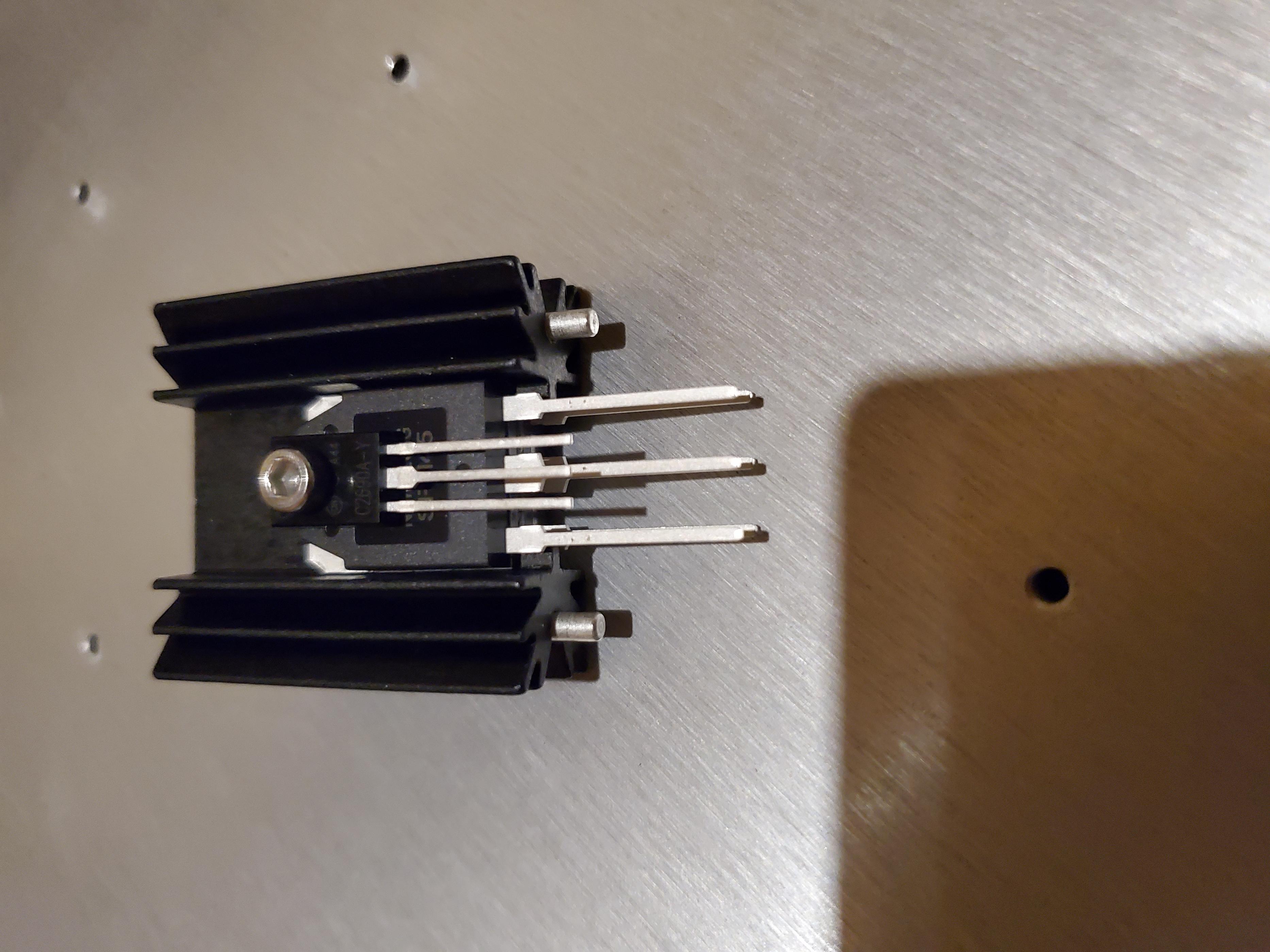

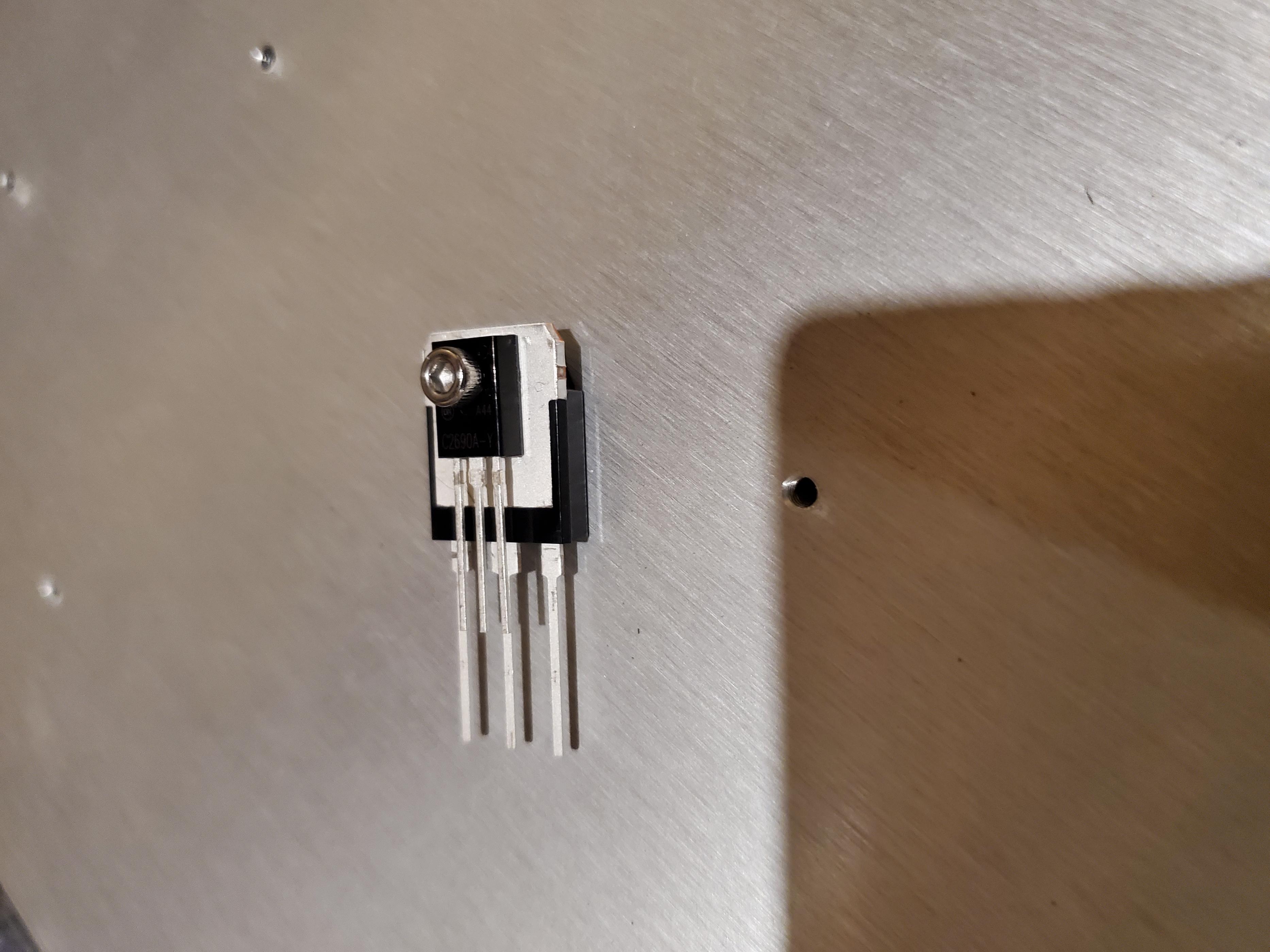

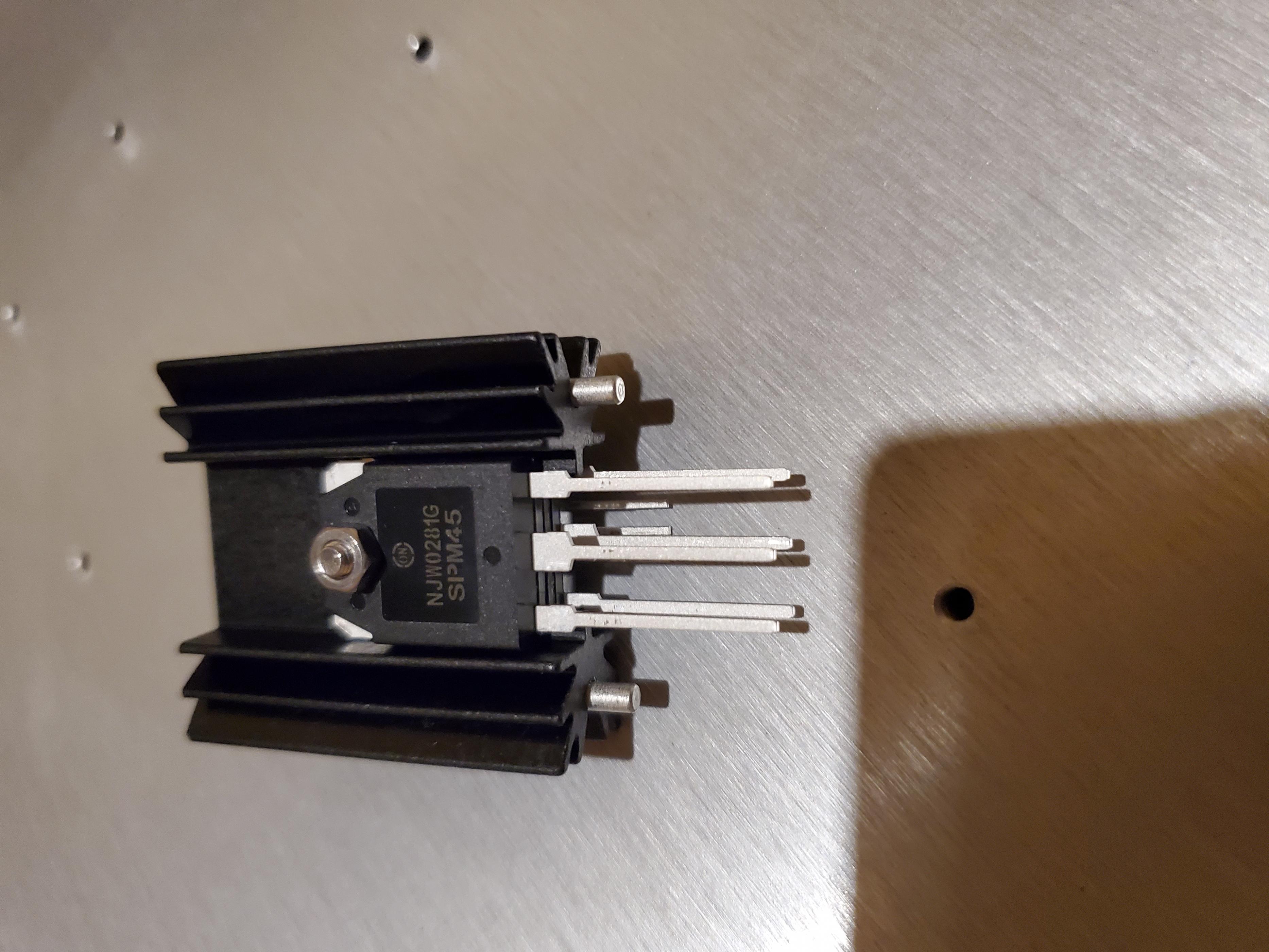

Have you considered something like this? Mouser part number is 532-513102B25. The small heatsink can be soldered to the board via the two pins.

I use Russian software. Res500 for 1/4w = 1/2" lead centers. I think that's military spec too.
Who's military ??
BTW , 1/8 watt can be used anywhere I drop an 8mm macro. the ones I am concerned about are the 12mm/16mm.
I will handle the PDF "bible" for this creation , as well.
PS - I lost my macro library , as well.. I stole all the "slewmaster arcwelder" macro's to do this.

Cool , nearly 4mm + 2mm for the AL plate (HS).

I believe on the original badger you layed it out as a single layer board (bottom layer only). When they ordered the official boards they added the top layer copper to eliminate jumpers, all the holes were plated at the same time making their diameter unintentionally smaller.
