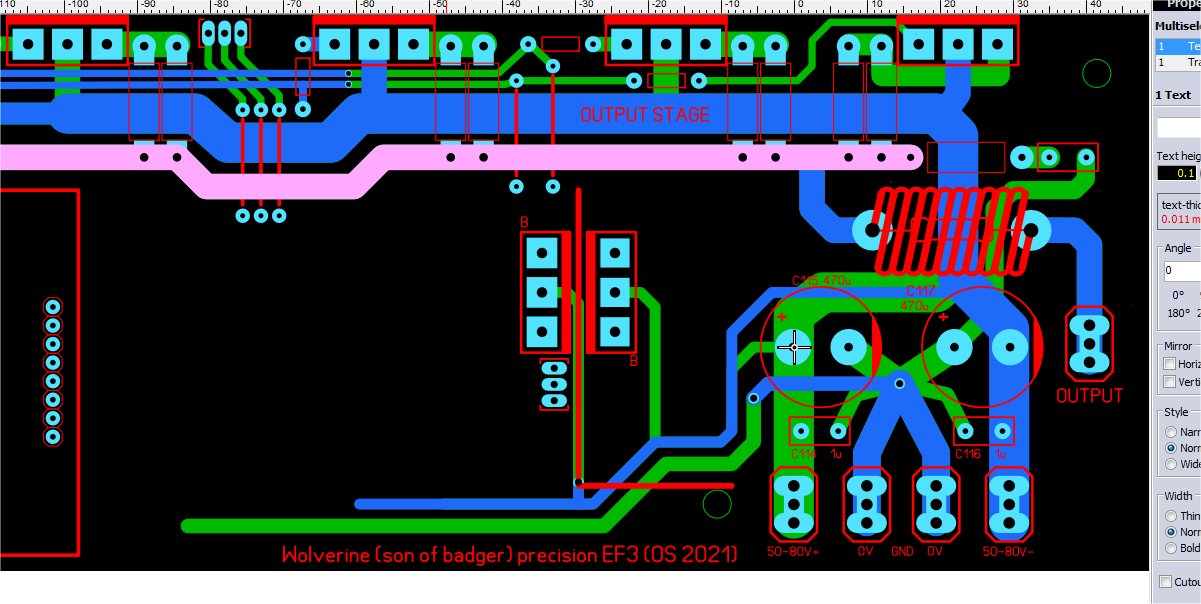

Hey J , see the 5 jumpers from both the main HS Vbe and the P/N channel
main basestopper traces.
Both the cancelling 6mm rail traces and the double sided output rail do not allow me to "snake" any trace under/ or over them.
Any ideas ??
OS
The double sided rails can be a pain! I just put the temp sensing transistor under the main board on the NS Amp. Can you use one of the board mounting screw hole instead? Could you swap Q103 and Q104's job roles? Q103 is connected with resistors, they could replace the jumpers.

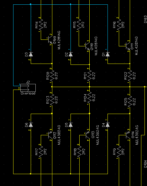

We came up with a better overcurrent detection scheme. Instead of just connecting to one positive and one negative emitter resistor we connect to them all with small diodes. The current sensor will see the highest current device that way so if there's a current hog it will catch it.
An even simpler fix might be to run the power rails on the other side of the output transistors.

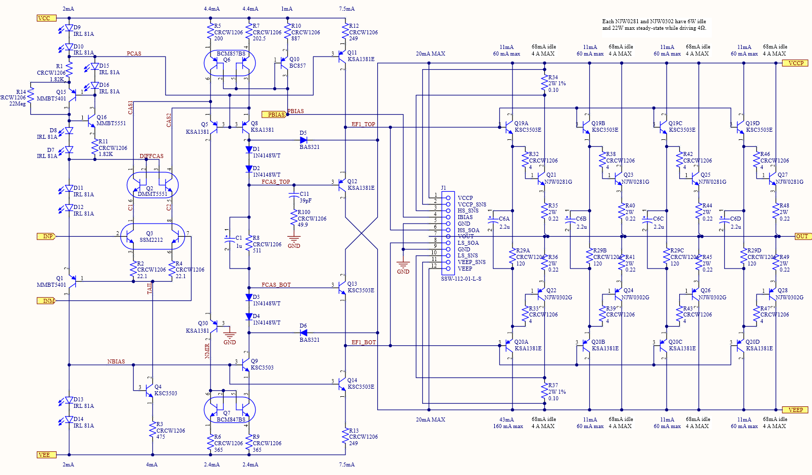

Hmmm ...
1 - I like eliminating R10. This was a remnant of earlier designs.
No effect on THD.
Q7 just makes the cascode reference independant from the LTP's. (buffer)
Using 4 diodes would make the Q1/2 run at 3V Vce ,current mirror would
see much more voltage.
Lower Z on the cascode from Q7 is a good idea. I will go half way and
use R5- 10k and R6 -15K.
In the real world , one builder tested this design at 60v p-p. 5-7 ppm @ 20k.
Consistantly. with no TMC.
2- easy to do that ... I need to simulate that.
3 - show a example of that.
4 - a little lead compensation ... I actually had that as a Badger option.
5 - yeah .. Two pole , like the badger. This design beats it without TMC.
I should see what TMC can do.

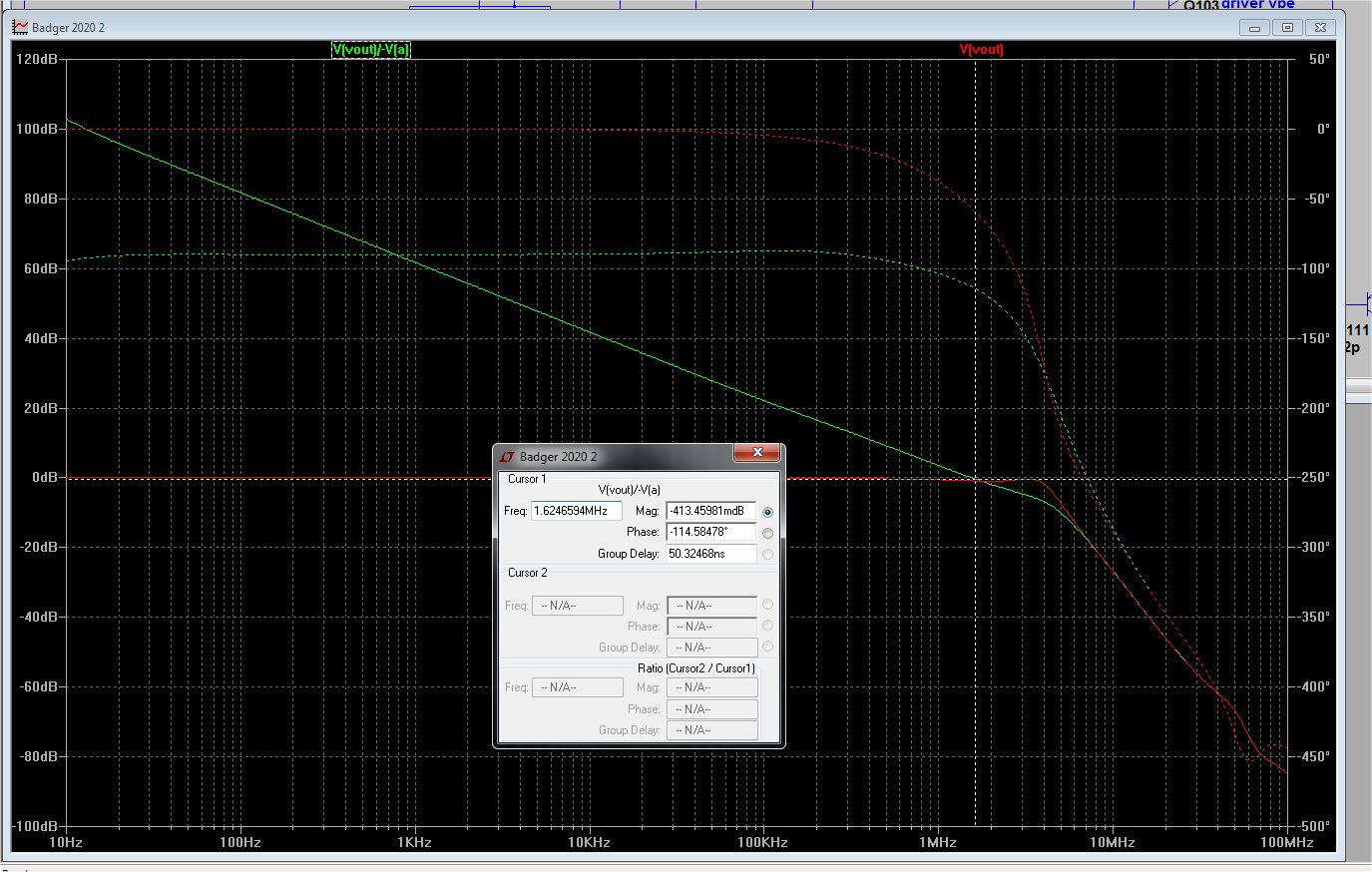

Wow !! , never tried TMC on this triple !!! (below 1) that is 100v p-p/ 4R /20K.
Bode (below 2)with 330p/68p two pole and output FB at 2.2K ... (below 2) No peak at UG , Nice sim !!
Enough margin... 1.6 mhz UG - aggressive - like a Wolverine.

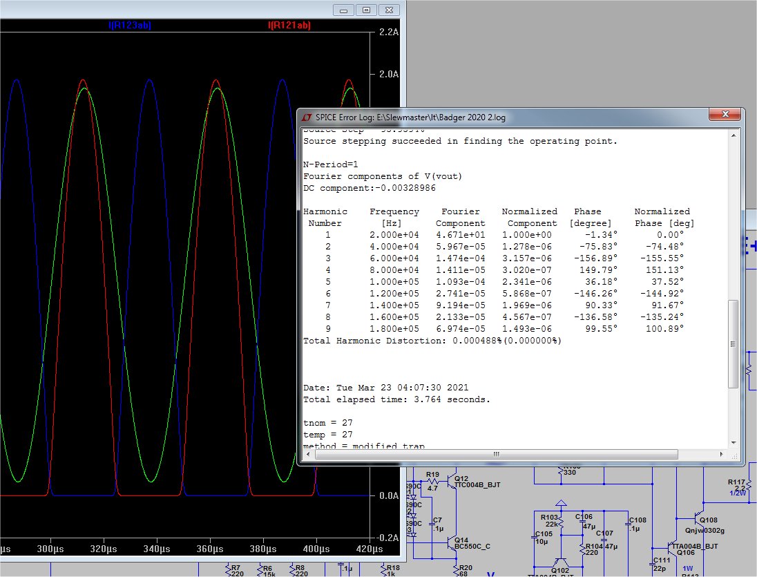

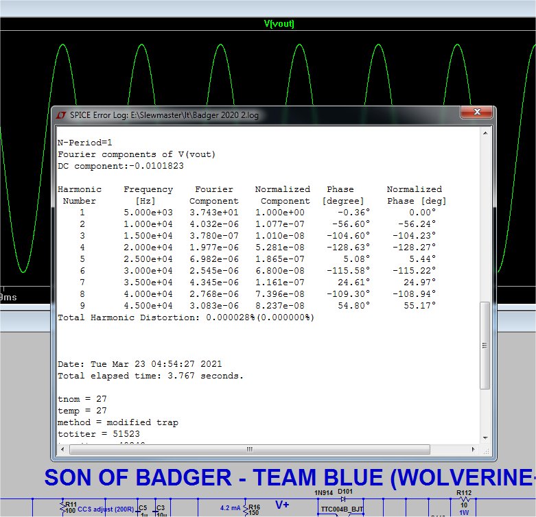

Whoa !!
Never got readings like this ... (below).
2ppm LF to 2Khz / WAY ... sub- ppm 3K to 15K / up to 4ppm 20k as the amp
runs out of gain margin. Wow - I hit 10ppm at 33Khz.
Stunning results.
Yes ... fixed the Vbe layout deal - Thanks Jwilhelm (layout master) !!
Found a UMS hole right near the driver cluster.
-- (below 2)
Stunning results.

I've attached a picture of our new overload detection scheme. This will send the detection circuit the highest voltage drop readings from all of the output devices instead of just one pair. We tune the trip point on an optoisolator to match maximum peak output current to signal the microcontroller.

The bias leg on the left shows my preferred way of biasing an input cascode. I'm using IR LEDs instead of diodes, but the idea is the same. Those IR LEDs are 1.25V each at 2mA. So, that's about like 4 regular diodes.
My EF triple shows an example of the flipped-over pre-driver. The pre-driver runs at nearly constant current, so it's current does not have to be very high. Flipping the pre-driver gives you another VBE at each end of the voltage swing. It also seemed to give me slightly lower OPS distortion.

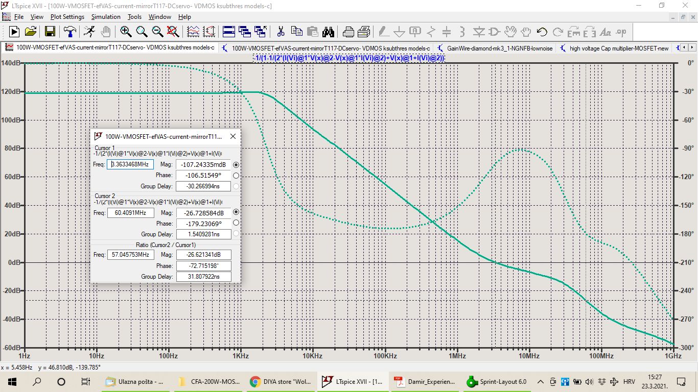

OS, this bode plot does not look like two pole compensation.🙁
This is what I've got with my OITPC compensation (kind of TPC).
Hi OS,
Dadod is right.
Phase in TPMC should dip way below 90 degrees, and then come back close to 90 degrees before you reach the loop gain 0dB crossing. I can see that your phase dips very slightly below 90, but there is hardly any extra correction at all.
Dadod is right.

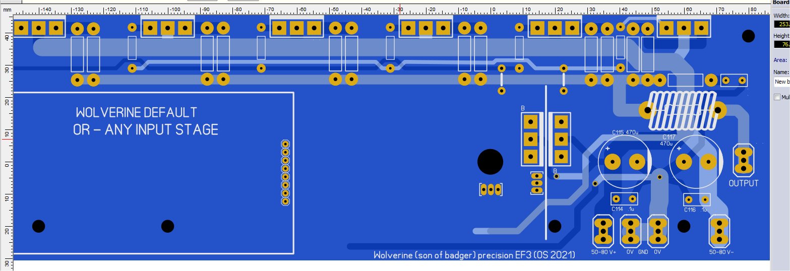

PCB Layout suggestion
Why are you not use this example pcb board for this design? Output 3EF on left and right side, drivers on main heatsink and Vbe drivers on left side of heatsink and Vbe for output stage on right side of heatsink. Upper center put electrolytics with regulated psu jacks for input and vas stage.

I'm looking forward to seeing how this one turns out. I have successfully built Honey Badger v2.4, and a Slewmaster with the Spooky leach front end. Absolutely no trouble with either amp, even running some demanding loads like Magnepans.

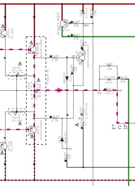

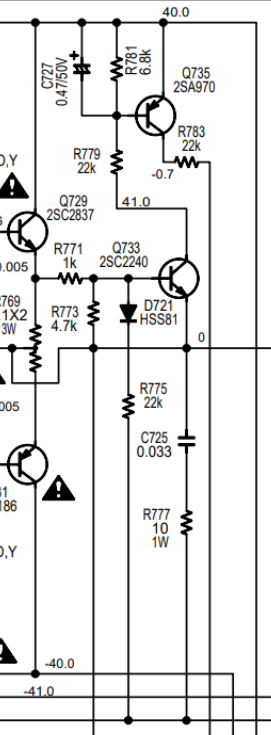

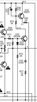

Protection should be considered even if it's Not VI limiters. I agree dc detect can be on another board. But even basic short circuit detect is common on all commercial amplifiers.
How effective they are can be argued but i think it's a clear consideration that should be made, even if it's just detection and not the actual protection board.
Attached detect from Yamaha and Marantz.
Would there be a problem to hardwire the VBE from that posistion? I for one would rather have the VBE as close as posible to the outputs.Whoa !!

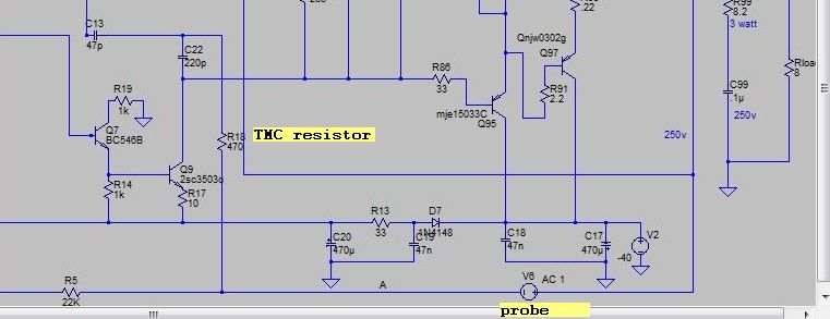

I think Os did not connect TMC resistor after the probe as it should be as in attached picture.
I bet you are right. Wired correctly for operation, but not for the Bode plot.
