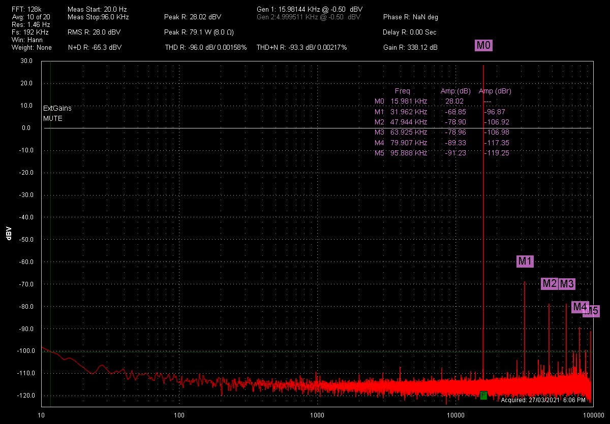

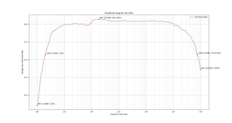

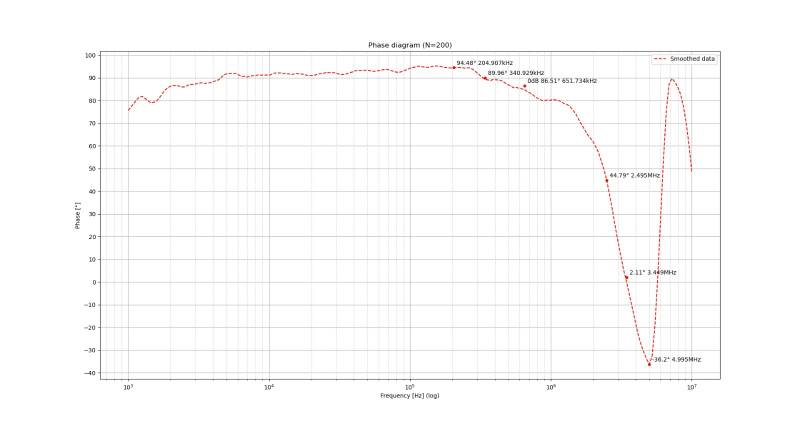

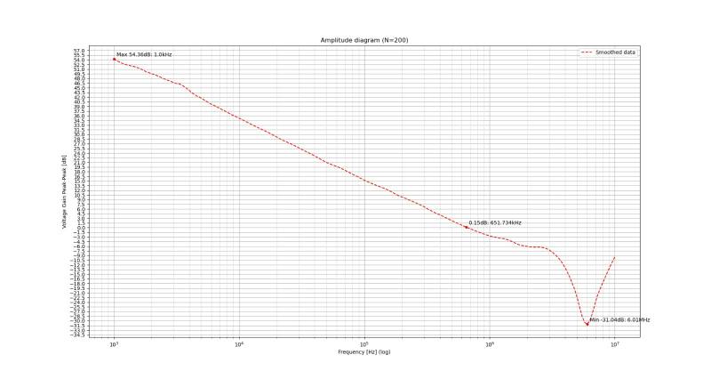

Hi OS,

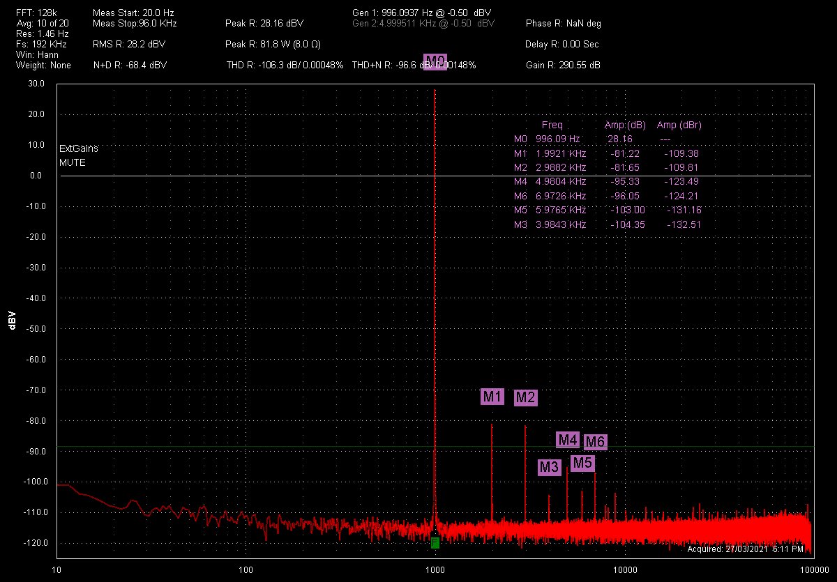

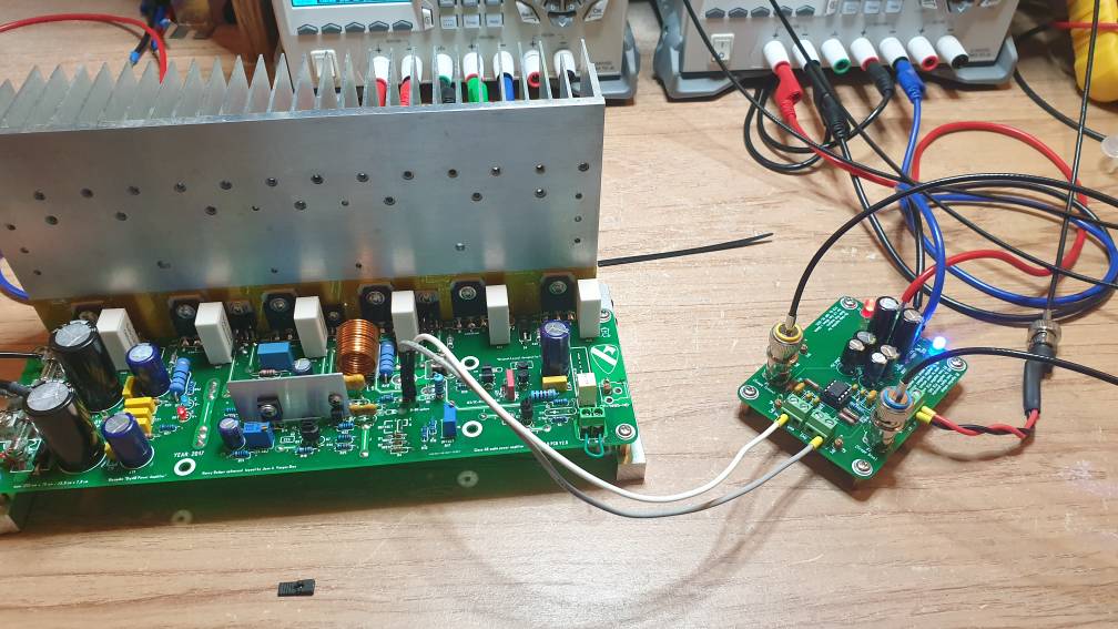

I'd be interested in testing one of these and providing feedback.
As you know I have all the test gear.
I have also recently ordered the Distortion Magnifier to go with my QA401 as my current HB build is measuring distortion at 0.00043% at 1K which is actually equivalent to the QA401's loopback distortion. So the actual distortion is unknown for now.

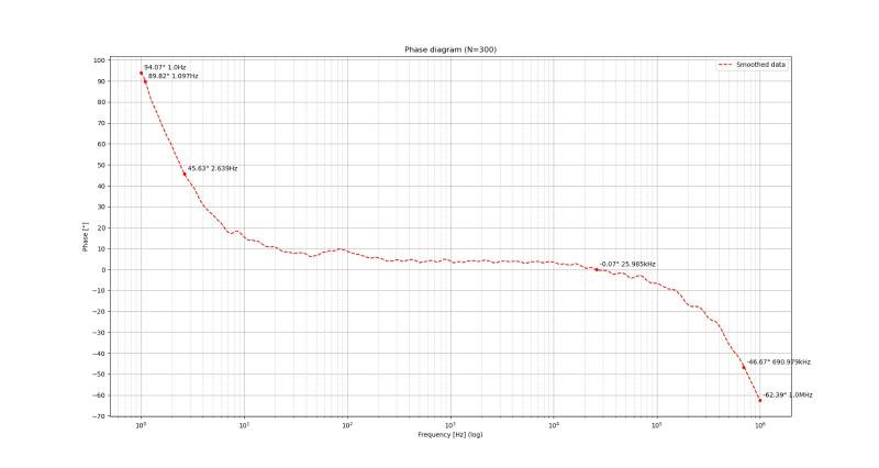

I could also accurately measure the loopgain so the phase and gain margins are know.
Let me know if you're interested.

Yes , sounds good.
With the "Anal level" I am aiming for in this update to the store amp , it would
be great to actually see if it works as good as it should.
This one is "Slewmaster" based.
Many forum members have helped and (tested) this group of designs.
The new store amp (Wolverine) is a way to redeem myself for my
amateurish attempt 6 years ago.
Many people helped with the Badger , but in reality it is one of my learning
designs that I was drawing with a Sharpie on FR4 😱 .
I want this one to "wipe the floor" compared to ANY project offered in the
current store .... So any tester is welcome.
Since it has modular capabilities - there will even be more (testing).

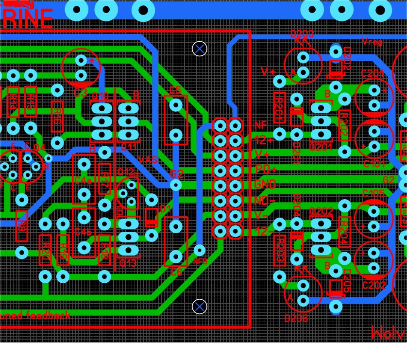

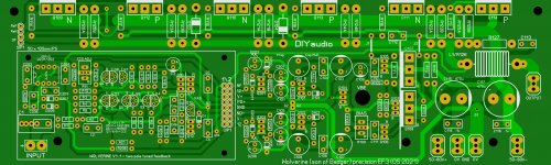

(Below) is the current 4'th final ... haha ! PCB.
I was thinking that one could have the onboard wolverine fully populated ,
have enough clearance to just plug in a Spooky or whatever right on top.
Either a standalone project (wolverine) with modular capability OR just
a OPS/regulator "devious playground" for IPS's.
OS

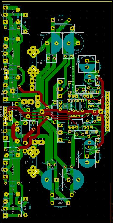

Hi OS and the others:

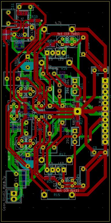

I am closely following the progress of this project. I had a similar idea for the Slewmaster Amp. I have attached my current state of the boards to you. My Slewmaster board also has OP transistors in line, is 170 * 85mm in size, could be mounted on the heat sink at right angles or in parallel.
The IPS (Greenamp VFA and Kypton-ND) are each 100mm * 50mm in size, are connected to the Slewmaster at right angles via connectors and use a mix of SMD and THT components.
At the moment I'm not quite finished, but if you are interested, I can share the drafts. I also use the open source SW KiKad🙂.
Now to my questions:
1. There were changes in the dimensioning of the Slewmaster resistors. What was the reason for the changes?
2. The Greenamp-CFA (https://www.diyaudio.com/forums/solid-state/369758-diya-store-wolverine-son-badger-suggestions-11.html#post6588859) is quite different from the Kypton-ND (different servo input and one less transistor in the VAS). Does this IPS reach the Kypton-ND performance?

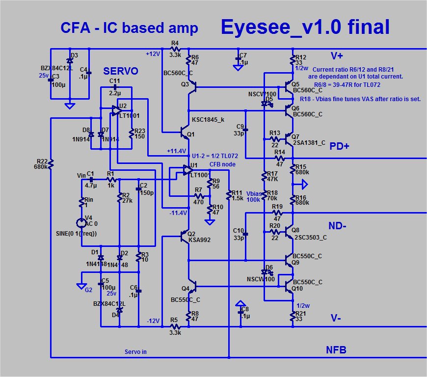

The project that keeps on giving.....
This was my sales pitch to management.
I also had them read the Slewmaster thread. They liked the content.
Looking at the current store projects.... I won't comment. 🙄
SMD option , modular .... I think it should be Forum standard.
Just think of it - I have almost EVERY amp EVER designed on this forum AND
at least .... hmmm ... 67 classic Japanese 20th century designs ported
to this EF3 OPS.
Plus op-amp (EyeSee-below) IPS's ... truly unique. Several more unique ones,
as well.
I have about 140 LT simulations total.
OS

If you could standardize your IPS's to this amp's 8 pin
(ND/12v/V+/PD+/GND/ND-/V-/-12) scheme , you might have a wide audience in the end.
The "Greenamp" is the simplified Kypton-ND with just a standard Hawksford
cascode. Clips better than the super-pair ND.
Having the cap multipliers feeding the simple series zener regulators is better
by far than the hot,dirty standalone zeners in the ND.
Positive servo FB in the greenamp - offset is microvolts instead of millivolts.
Diamond pair and current feedback pair would be ideal as dual matched SMD
SOT-23-6 packages.
10ppm - 20k/4R with good clip and 110db psrr. Close to the wolverine with 4X
the slewrate. Simple and easily ported to both SMD and this project.
Edit - the resistors give the choice of either ceramics like the KOA BPR55-56 series
or dual standard 15mm 2W .47R in parallel. Either group can be had in wirewound or metal film versions.
