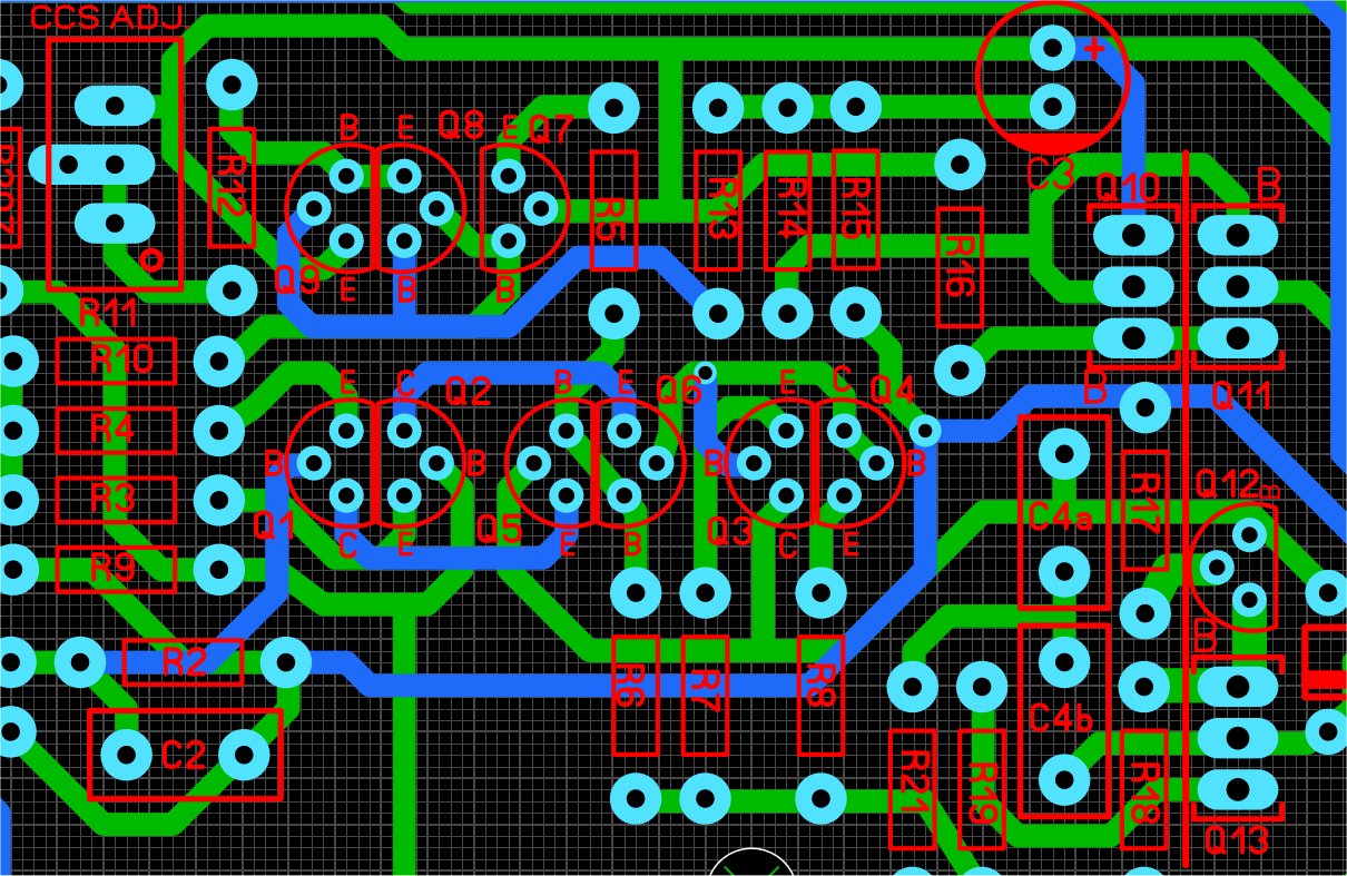

Let them make fun of my through -hole.
Another level of perfection , check out that IPS/VAS (below).
It will preserve 2ppm , I think ...

C2 and R2 are connected to supply ground. The schematic is showing them connected to the ground lift resistor. Which one is correct?
Should the servo ground reference be connected to supply ground or the lifted input ground? If I recall correctly Thimios saw a substantial difference in distortion levels by connecting it to the lifted ground on Spooky.
On the top side of the servo, + & - inputs are connected together. I think it's supposed to be + & out but I can't make out the schematic properly.

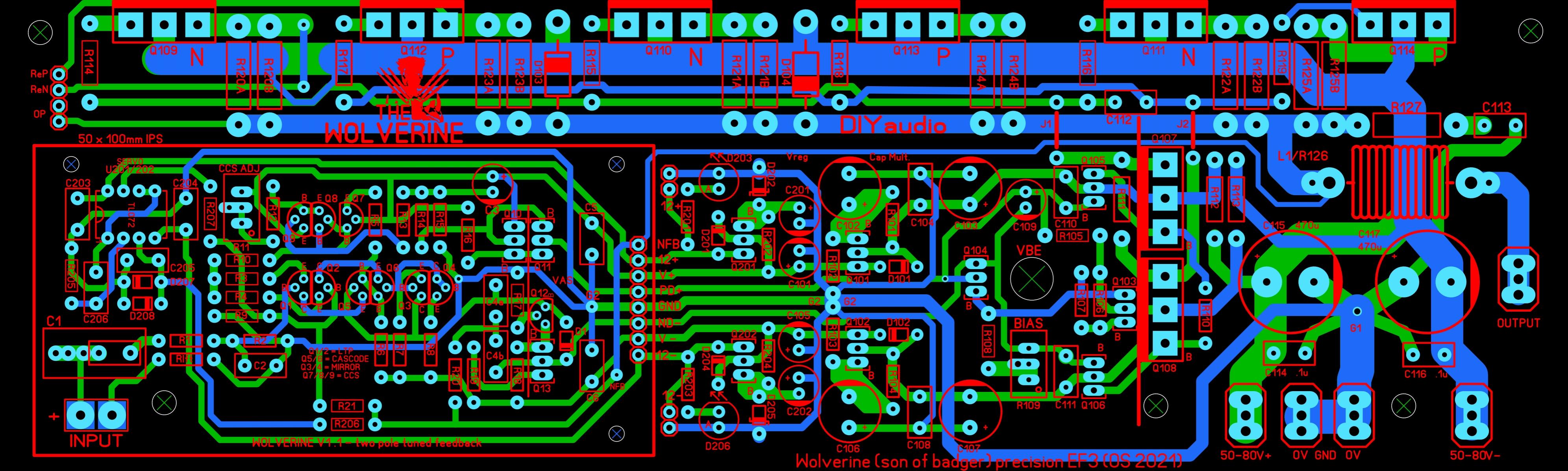

I have the options of either lifting the whole IPS or any of the 4 starred
ground references.

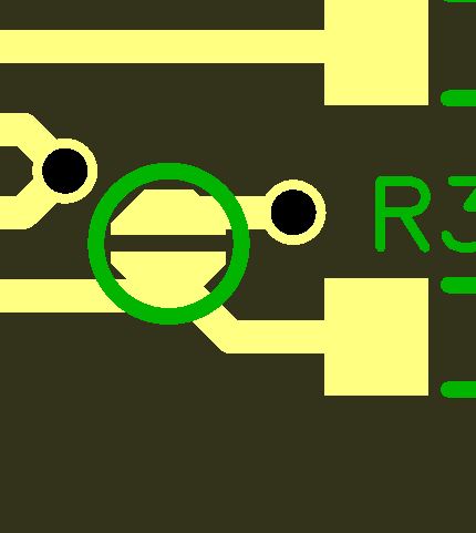

I did fix the Q6 and R3/4 (below).
Ohh .. that one hid from me , you are right.( - /out) shound be bridged. That
op-amp is just in a buffer/follower mode.
Other one is an active non-inverting LPF.
Thanks , JW.

Hopefully Thimios can remember what he found for sure with the servo. It was a couple years ago, I may be remembering incorrectly. Your B side of the servo looks like it's still wrong.

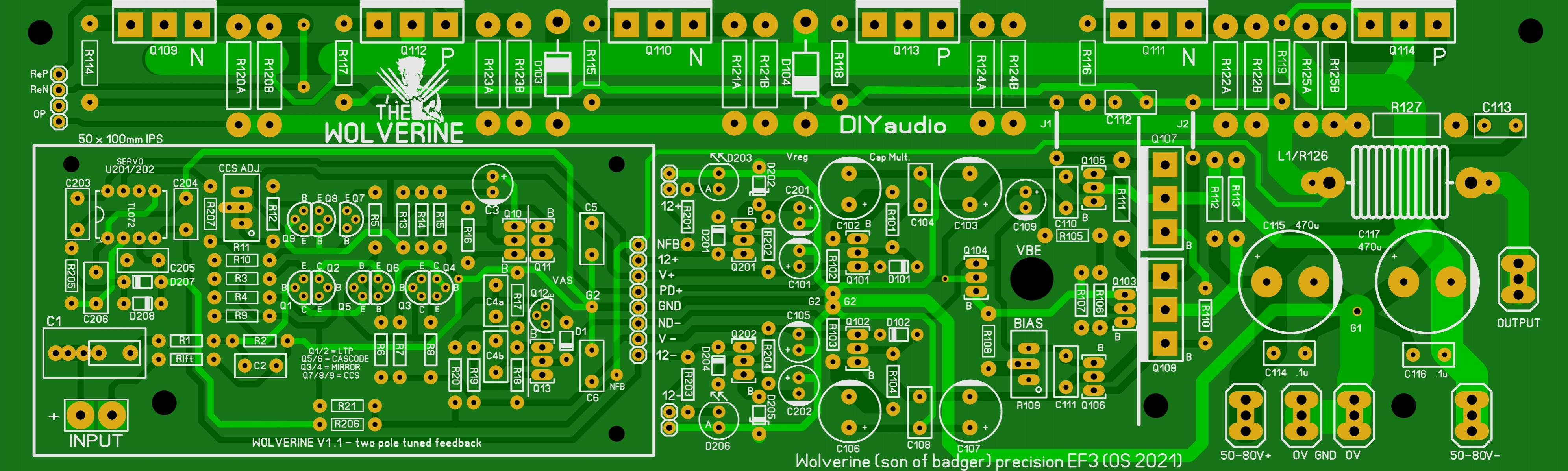

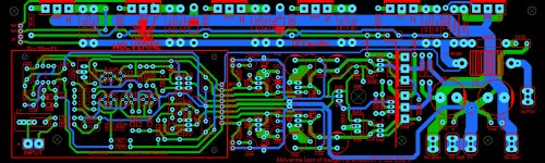

That's looking good! I see you added some screw holes for the input boards too.
It just dawned on me there's no way to run the input stage in isolation unless the output stage is left unpopulated.
Sort of a half - solution to that .... G2 and NFB via's can be drilled to not allow
stray ground or NFB signals if using a separate input stage.
Input stage in isolation ??? I've done that powered right off the slewmaster.
- 2X 2.7K's between PD+/12V+ and ND-/12V-. Output stage is populated and
running a static 50ma bias - no input stage required.
Then , 2X 1K's in series across PD+/ND- (IPS) , run the centerpoint to NFB.
This won't work with any CFA's low Z. Works with all VFA's.
Jacks near the two LED's facilitate this (below).
PS - hopefully builders would make the onboard or 3'rd party choice right off the bat.
I might clone the onboard IPS to a 50mm X 100mm PCB , just for that purpose.
I won't force anybody into the modular way.
OS

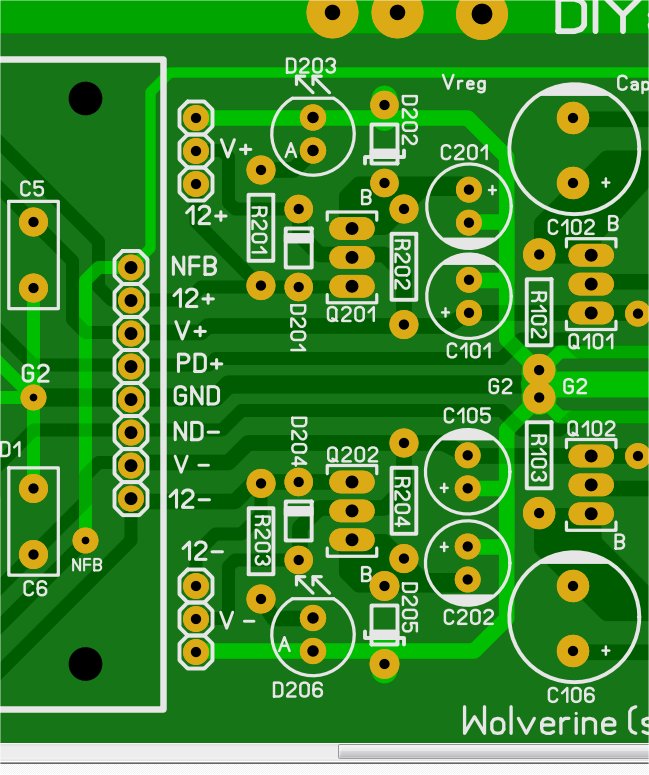

Please ignore if this isn't helpful or has already been considered...
But would there be any negative effect if the 8 solder pads for the daughter boards pin connector (coming from the IPS) were doubled up/ done in two rows? This would offer the ability to jumper for on board use, or solder a connector for daughter cards, ignoring the second row.
Ahhh , not helpful ??
That is brilliant !!!!! 🙂🙂🙂
I was just looking at dual SIP molex connectors.
Did not really make that connection (pun intended).
I could put a male dual row onboard. they would either jumper the dual
row for onboard with a bridged female or just engage the OPS facing row
to go outboard (single row female).

I prefer to put the female connector on the board with the power supply. It's a little safer that way, no exposed high voltage pins. The two row jumper would work though.
Another option is a small solder blob jumper to activate/ deactivate a trace. I use them for address selection for I2C devices, but they work well for disconnecting supply regulators. ect in big SMT boards.
