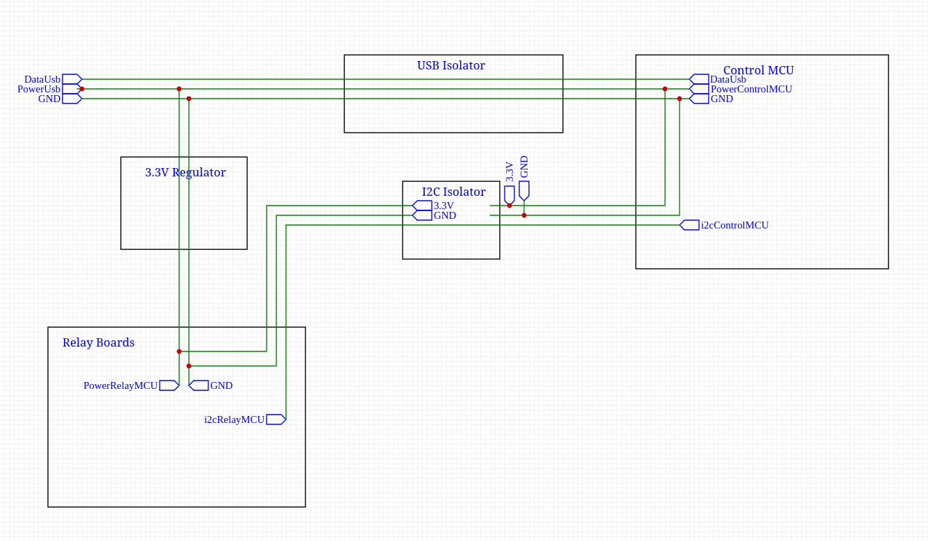

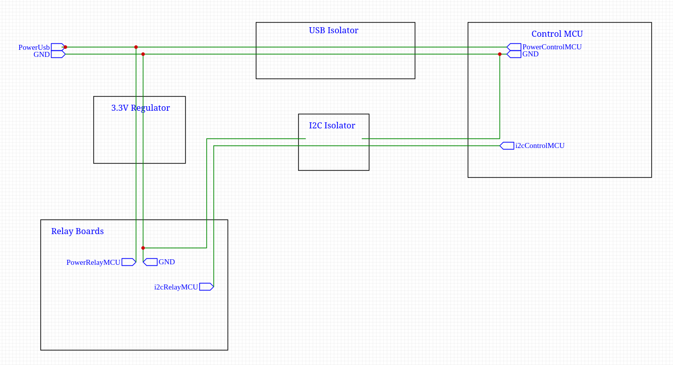

We're getting there. Now draw at least one USB data line and also add the power connections for the I2C isolator.its the same, i just draw in one "power lane" for both 5V and GND

Don't understand. Is the ground on one side of the I2C coming from the MCU and the other from the USB connection?Edit: its actually like this, mind that the i2c isolators gets both grounds

Please draw: Power, ground, and one data line for each of the blocks. It'll make it much easier for me to explain to you where the currents flow.
Right now the I2C isolator is unpowered on both sides.

So now imagine the I2C signal from the MCU going high. That will create some current flow onto the relay board. The return current will flow in the ground line through the regulator and USB isolator back to the MCU board. That's a huge loop, so it'll radiate like crazy.
are you sure this is the case with this kind of i2c isolator?

The way you've drawn the wiring diagram, yes.are you sure this is the case with this kind of i2c isolator?

but what way i would need to draw it ?The way you've drawn the wiring diagram, yes.

to me the i2c isolator looks like its creating two loops, one with the local ground and it creates another loop with the actual isolated GND, i dont believe current will flow "over" the isolator back to the controlMCU
think about a optical isolator it has essentially two power supplys utilized and there is no current at all flowing, its creating two loops
Uh... The way you intend to connect the circuit.but what way i would need to draw it ?

Your block drawing does not make absolute sense, you for instance have 3.3V derived from USB 5V in the MCU block back to the isollator block as well as a 3,3V regulator to the relay control block. Is there interconnection to 5V perhaps.

2. the 3.3V regulator will take 5V and regulate down to 3.3V for the relay board to use, no need for 5V there

Keep in mind that current flows in loops. So if you power both sides of an isolator with the same supply, even if the 'isolated' side is through a regulator or filter, any current drawn on the 'isolated' side of the isolator will have to flow back to the original supply, so you'd have to share grounds.alright...
If you want isolation you need to provide different power supplies for the input and output side of the isolator. That means either a lot of SMPSes or a lot of transformer windings.

well i get what you wanna get to but isnt the DC-DC converter inside the usb isolator essentially "a different power supply" ? ground loops get broken by isolators, so there is no noise current flowing...Keep in mind that current flows in loops. So if you power both sides of an isolator with the same supply, even if the 'isolated' side is through a regulator or filter, any current drawn on the 'isolated' side of the isolator will have to flow back to the original supply, so you'd have to share grounds.
