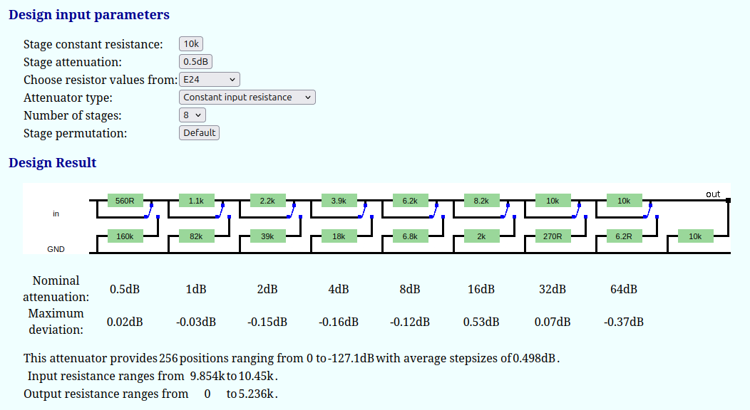

i did some research and preferably you want over a 1:10 ratio of input/output impedance, many output devices like dacs will probably offer 200 ohms or less
where for example my active speakers have 10k input impedance, which is fairly common i think
So in theory with this 10k input impedance version above, one would have 2,5k impedance at 64 db attenuation, somewhere around 1,25k at 32db, everything under 64db i just consider for a "good" mute option
So i think a purely passive version like this probably works out fine? since i still was arguing with myself about a output buffer

allternatively i could make the input impedance only 5k , which ends up being 1,25k at -64db, 625 ohm at -32db , i think "too low input impedance" is only important for tube gear right?
imo 625 ohm at -32db isnt that worse than a buffer considering its only a passive volume control where you probably can keep volume quite high (adjust volume on your amps etc...)

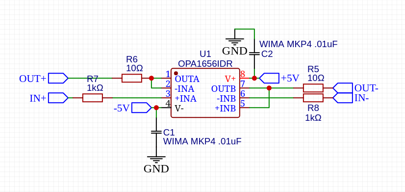

So i actually think i will end up building a design like schitt freya, where you can switch between passive and buffer output and just check what sounds better...
im just not sure yet how/where to implement this
for starters, would this be already a sufficient buffer circuit?
Parallel to C1 and C2, imagine a additional 47uF-100uF cap, just havent added it yet
should i just decouple both power supplys towards ground or also to eachother with 2 additional caps? i think i read so far just towards ground is more desireable, but my own opamp swapping showed hooking up a 47uF cap (+ 0,1uF MKP cap) between V- and V+ was quite beneficial, what do you think?
im unsure what the last dac had as a circuit, but i imagine it was decoupled towards ground and i was decoupling the power supplys additionally to eachother
10-100ohm output resistors were recommended by chatGPT, also the 1k input ohm resistor, which limits current to 15mA at 15V
probably using something like +12/-12V allows for more opamp choices
You'll probably want 100 nF for the local bypassing. I'd use X7R ceramic rated for at least 50 V. They'll have lower ESR and higher SRF than the Wimas.
You'll want 10-47 uF on each rail where the power enters the circuit board. I'd use a plain electrolytic cap for this. There's no reason to go overboard here. More is not always better.
I'm curious about the purpose of the 1 kΩ in series with the input. If you're going for ESD protection, I suggest a pair of diodes to V+ and V- instead. If not, you can go without the 1 kΩ.
The 10 Ω can be handy for driving longer cables. Some put it inside the feedback loop.
