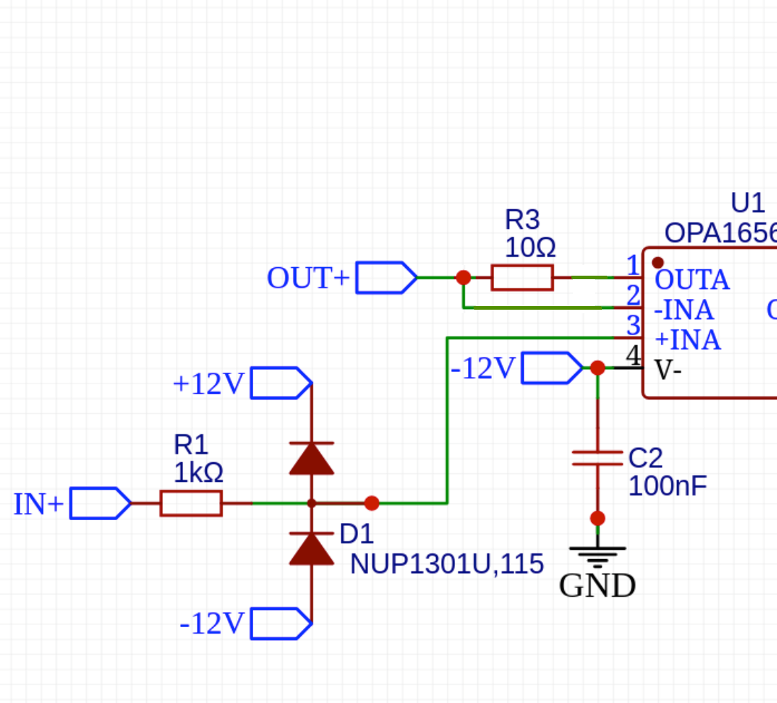

I'm curious about the purpose of the 1 kΩ in series with the input. If you're going for ESD protection, I suggest a pair of diodes to V+ and V- instead. If not, you can go without the 1 kΩ.
im unsure if the resistor is really nessecary, just added it to elimate any kind of "illegal load"
you are probably referring to zener diodes towards GND on each input, right?
i read the input voltage shouldnt exceed the power supply voltage, so for a 12V design i could just use some around 10V zeners?
i figured since XLR can usually reach up to 6V, its probably best to have a bit of headroom, 9-11V zener plus 12V power supply seems like a good combination, also in regards to using different opamps
The 10 Ω can be handy for driving longer cables. Some put it inside the feedback loop.
about the feedback resistor, i wasnt sure if i even can add one, since tutorials suggests for unity gain you need a direct connection between output and inverting input
No, the standard protection pn-diodes to V+ and V- to stop the input straying outside the range V- to V+ by more than 0.6V or so. The zener "solution" doesn't work when the circuit is powered down, for instance.
Normally ESD protection consists of series resistance, then the diodes to the rails, and sometimes another resistor afterwards.

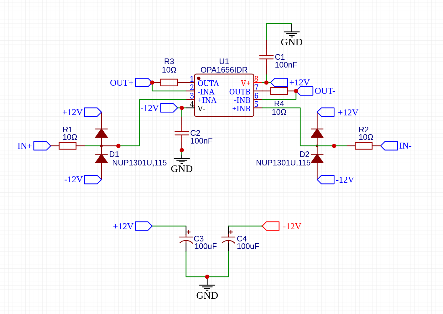

D3 and D4 are 13V 1W zener diodes
D1 and D2 are Nexprexia esd protection IC's including two diodes
C1 and C2 are Yageo 100nF 50V X7R ceramic caps
C3 and C4 are Panasonic Electrolytic caps, 61mohm ESR
Two Questions:
  • is 10 Ohm R3 and R4 for the output sufficient or should i increase this a bit? i read it can prevent oscillation
  • can i safely remove R1 and R2 input resistors? what kind of current can i expect on unbalanced/balanced audio signals?

This would be one way to include the 10 Ω inside the feedback loop and still have unity gain.
But you will need to run a stability analysis if you have the resistor inside the feedback loop. Or at least I'd encourage you to do so. If you go with the circuit you posted you won't have stability issues, but you will have 10 Ω output impedance.
The ESD protection diodes do not need to be Schottky, but it (probably) doesn't hurt if they are. I say "probably" because I don't know how reverse biased Schottky diodes will impact things like distortion. They probably won't impact much, but the OPA1656 has very low distortion. It'd be a shame to wreck that with the ESD protection.
What's the idea with the two 13 V zener diodes? Over-voltage protection? With the circuit as-is any power supply worth its salt will just blow the zeners. Also keep in mind that zener diodes are not precision devices, so you'd probably want 15 V zener diodes if your goal is to protect the circuit ... and add some series resistance so they don't fry immediately if someone attaches too high a voltage.
Some use 0 Ω. Some use 47 Ω. Anywhere in between is probably good. It's highly non-critical.
I'll answer this in the form of a homework question for you: What's the input impedance of the non-inverting input of an opamp? The input current would then be Vin/Zin.
the idea came from this: https://sound-au.com/articles/esd-protection.htm which suggests the zener is required for the ESD protection to actually work (?)

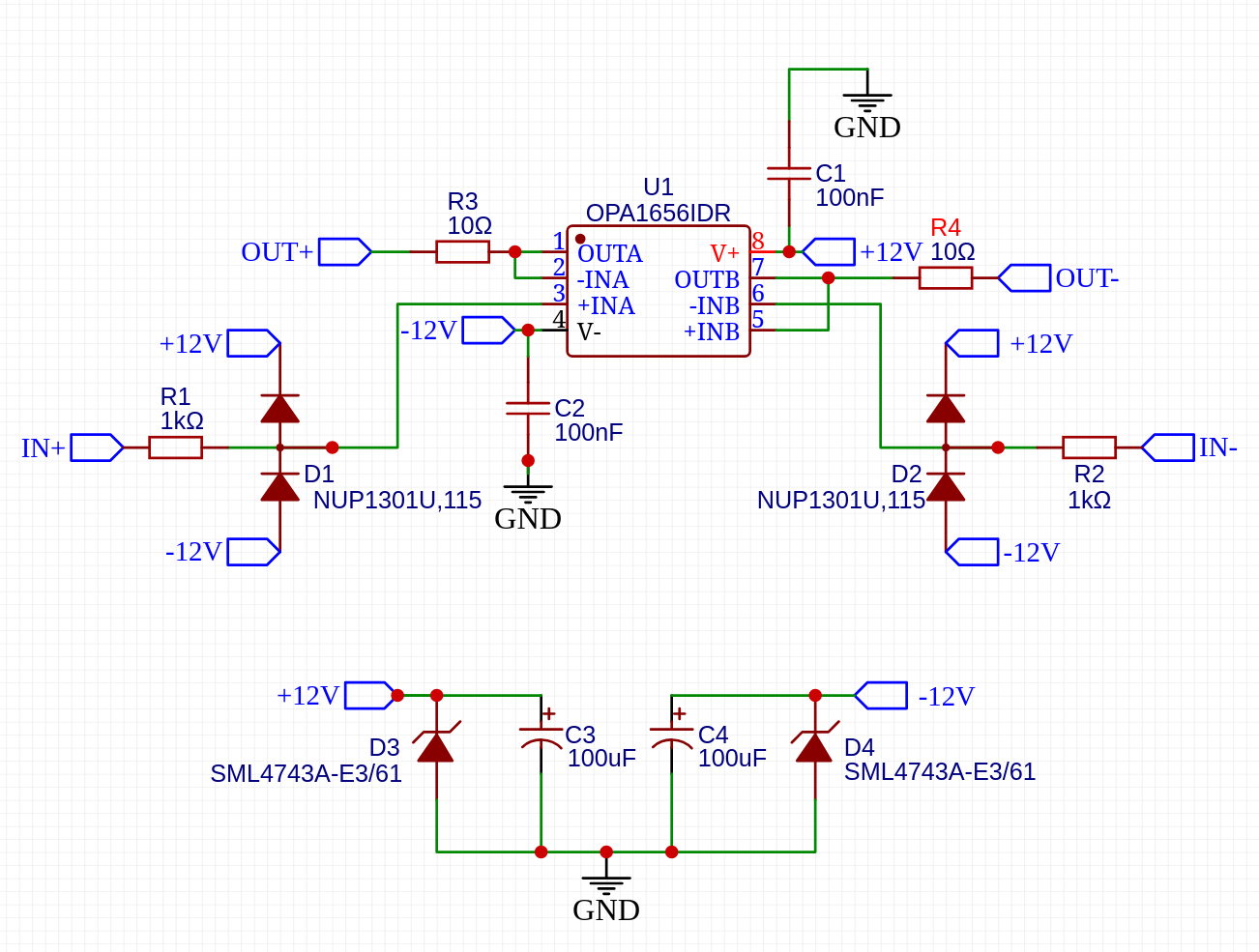

actually unsure which one i would take here, but i will just go with the lower one of 100 MegaOhm
So.. 12V / 100.000 ohm = 0,00012A, which is 0.12mA ? 0.06mA for 6V inputs
So no need to worry with high impedance inputs like this i guess
Try to think it through.
If the ESD strike is positive, the diode from the input to V+ conducts. The energy goes into the power supply. Let's say you have 10 uF there and you have a 20 kV ESD strike. Assuming human body model (100 pF + inductance), you're looking at 20k * 100p/10u = 0.2 V buildup on the power supply. Hardly anything to worry about.
If the ESD strike is negative, the diode from the input to V- conducts and you get an additional -0.2 V on the power supply.
Rod is right. To fully protect the IC you also need a zener clamp (or similar) from V+ to V-, but you will likely find that plain zener diodes have too high internal resistance to properly protect the IC. Also, Rod neglects that the IC has its own internal protection both on the inputs and across the power supply. The internal protection is intended to protect the IC during circuit assembly (under ESD controlled conditions), not to protect the IC against anything the end user of some equipment might throw at it.
Actually, 100 MΩ = 100,000,000 Ω, so you're looking at 12/100E6 = 120 nA.

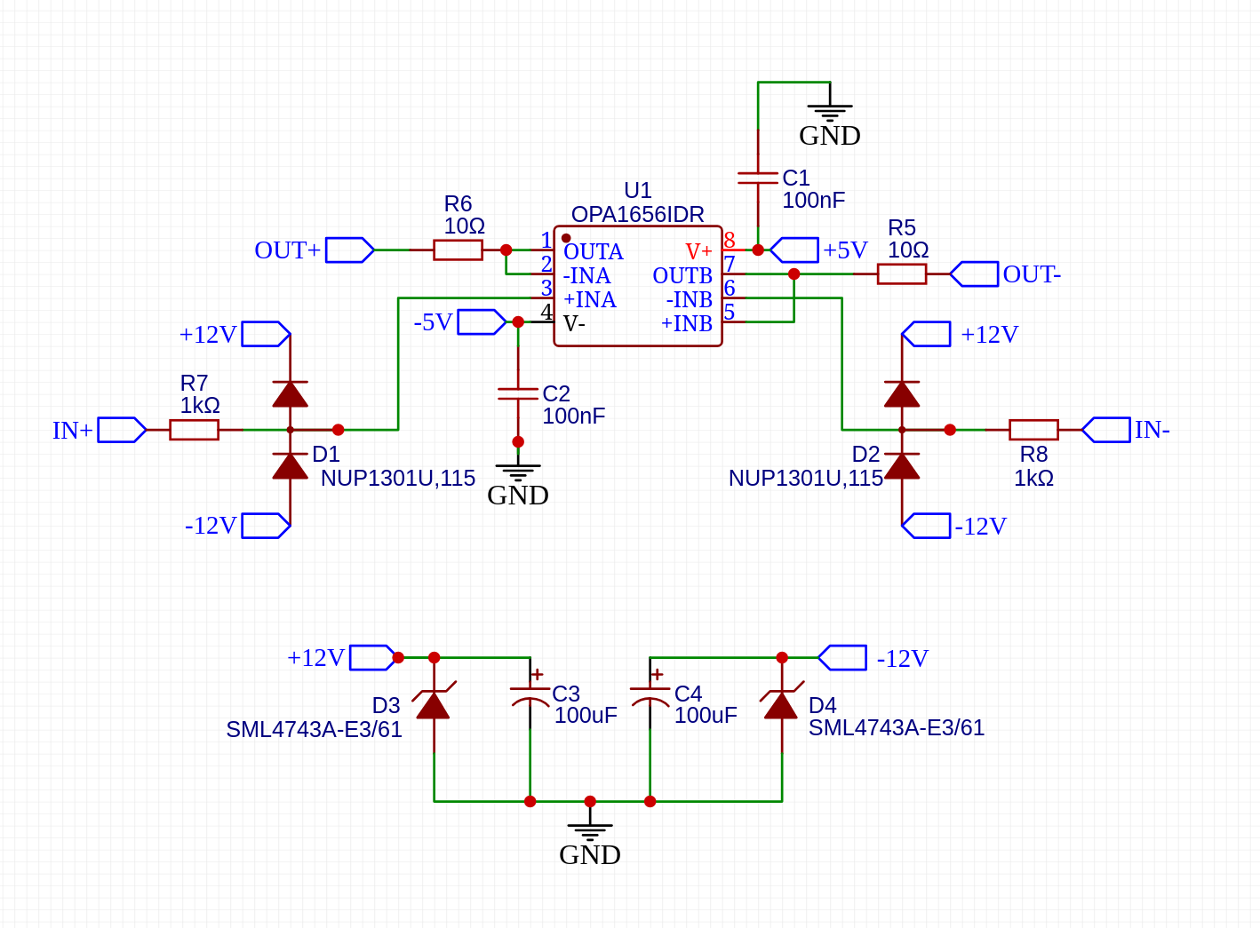

So this should be the final circuit.. i hope the seperate feedback & output resistor works out, else correct me please 🙂

What are you looking to accomplish with R5 and R6?
Also, U1B has positive feedback. Are you looking to build an oscillator? If so, you need a capacitor there too to set the frequency. 😉
Nono, i just wasnt able to find a balanced schematic, so i kinda assumed minus voltage needs to go to minus input, both inputs go now to the plus input and feedback to minus
just so im able to change and match feedback resistors + input resistors, without nessecarly changing output impedance
more variables to play with later on, tho im unsure if this does introduce gain with two resistors on the output/feedback
EDIT: oh i probably got it, your schematic connects the "output" directly to feedback after the output resistor, so feedback still gets 1:1 what the opamp throws out, my schematic probably messes with gain...
maybe it works out with two resistors with the same value, but if i need to swap them both i can also just use your schematic i guess 🙂

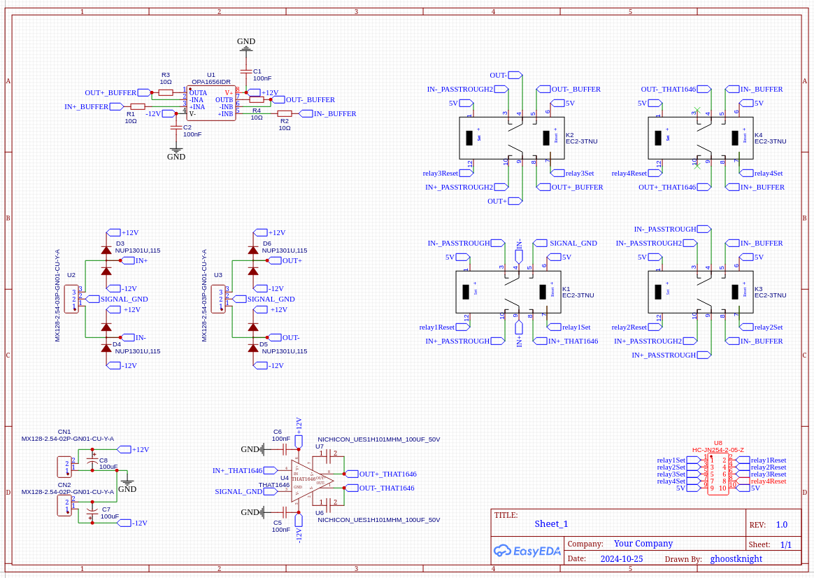

hmmm i found this one https://diy.thcustom.com/?wpdmdl=3207
suggesting the THAT1646 as DRV134 replacement, do you have expierence with this one?
something like this could be an "all in one board"
you can switch between
1. passive passtrough
2. using only THAT1646 for balancing a unbalanced signal
3. using only the buffer for balanced
4. using that1646 + buffer for a unbalanced signal
atleast this is the best idea i came up with
