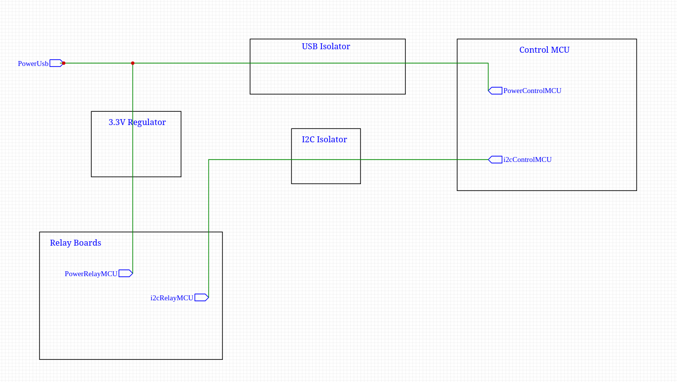

now thinking about it one could do this:
- get one of these cheap 12mbit usb isolators, use this as input for the unit, if you wire things correctly this can also be used to program atleast the control unit
- use the isolated side for the control arduino, in conjunction with a i2c isolator
- split the power input before the isolator and route it to a high quality voltage regulator + some caps/filtering which powers the relays
- now you can use one power supply, linear if you want and have everything powered by one power supply while majority of the (noisy) circuit is completely isolated
... and thereby voiding the isolation that you paid for with those fancy USB isolators. And never mind that those isolators usually work by transmitting RF across a capacitor, so following your own logic you're just replacing one noise source with another.

USB isolators are not bad. I always operated my audio analyzer with a battery-powered laptop. On the PC, 50 Hz were visible in the spectrum. After installing an isolator chip, the spectrum is also clean on the PC.

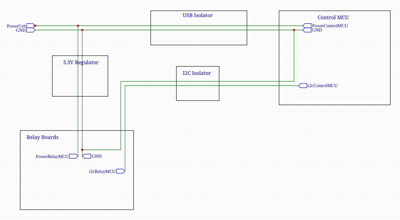

no i split the power before the isolator... and thereby voiding the isolation that you paid for with those fancy USB isolators. And never mind that those isolators usually work by transmitting RF across a capacitor, so following your own logic you're just replacing one noise source with another.
one lane goes trough the isolator to control mcu (which also has a i2c isolator so "overall isolation")
one lane goes to a voltage regulator which powers the relay boards
tho i wasnt sure about the DC-DC converter myself, your argument exchanging one noise source for another is kind of right, also audibly i can say cheaper usb isolators are not top of the cream...

Good, I like inventing my own stuff to my own specification as well. Only then you get what you actually want.
Which still voids the isolation. You get coupling between the two sides through the regulator. How are you connecting the grounds on each side of the isolator? Together? If so, your isolator will do nothing to prevent noise transfer because all the return current will still flow in the grounds. In fact, adding the isolator will likely make the coupling worse as it forces a larger loop area on the traces that go through the isolator.no i split the power before the isolator
And now I2C isolators too??
Dude. I strongly suggest that you sit down with a schematic and trace the currents (signal currents, power supply currents, and return currents). If you have any shared path between the two sides of the isolator you will not get isolation. In fact, the issue that you seem to worry about will be made worse by the isolators.
Don't get me wrong. I'm not against isolators. I think they have a very valid use case on USB, for example. But that's also a case where you can power one side of the isolator from the USB 5V and the other side from your own circuitry. Grounds are kept separate. That gets you isolation.
In your case, however, you're worrying about something that doesn't need to be worried about and your worries are making you make decisions that will result in worse performance on the things that you worry about. Not to mention that you'll probably spend $100 on isolators that could be spent on better relays or better resistors ... ya know ... things that actually impact the audio performance. Or on a good encoder ... something that makes the attenuator more of a joy to use.
If you're worried about noise from the micro controller just shut it down when you don't need it. That's what the many levels of sleep mode are for. It doesn't make noise when it sleeps. It doesn't even snore...
without i2c isolator the usb isolator is kind of useless, imo everything "ControlMCU" wise is completely isolated, i made a small diagram:
the relay boards are not isolated from the main power supply (PowerUsb/power over a usb socket) but the control mcu section is completely isolated from the remaining circuit that directly uses the main supply
