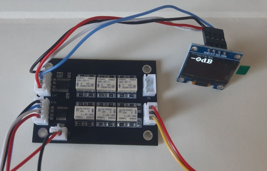

it seems you went in the end with a opamp design as volume control, was it a big improvement? or did you notice flaws with the relay attenuator like being sensible to different cables or such?
what me interest the most is that these relay attenuators act completely passive, so they dont will add anything by opamps/tubes/distortion
I used the Muses72323, and as I understand it's a chip with a passive resistor ladder that is controlled by some logic in the same package.
The Muses sounds significantly better than both my other relay based attenuators that I mention in my above link. And the relay attenuators sounded way better than the blue Alps pot I used previously...

May I ask where can I find this project?
I only posted about it in this thread:
Later I'm going to create a separate thread for it (need to finalize the firmware, recently I received some IR receivers and remote to play with).
tho i was also playing around the idea to have an tiny mcu on each board that can be communicated with over i2c or such,
Yep, that's what I did there.
What mcu do you use on your board that can switch the relays directly (as it seems), or what is the second chip?
EDIT: is it something like an ULN2803 darlington transistor array chip?
The MCU is ch32v003 and there is a driver chip (similar to ULN2003, I do not remember exact part number)
