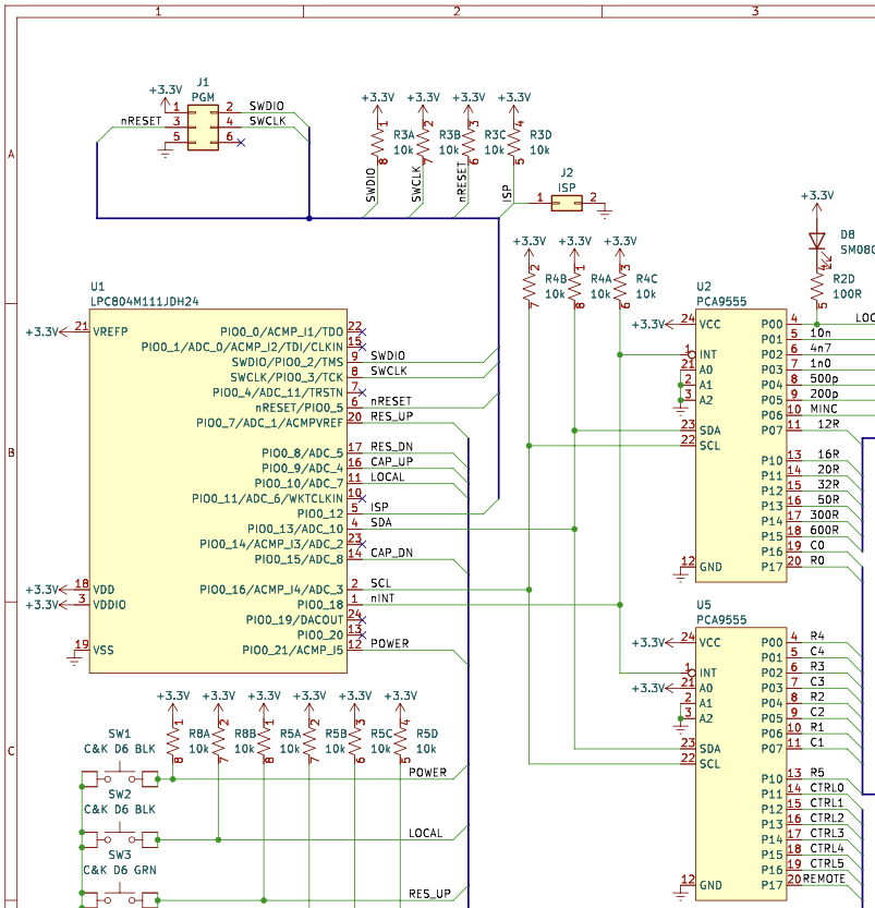

Or port expanders:
The PCA9555 can be configured so it offers both inputs and outputs. That's harder to do with jelly beans. 🙂 The upper seven bits on U5 are inputs. The rest are outputs.
Also note the programming interface in the upper left (J1). That and the resistor network to the right of it is literally all that is required to move from something like the Arduino to a stand-alone MCU.

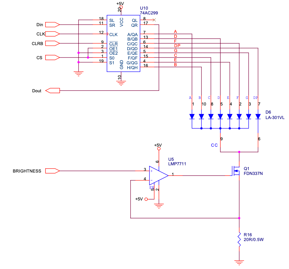

Humans are slow compared to an MCU. You're very unlikely to notice any delay as long as the display updates within 100 ms of user input. That's a lot of instruction cycles for a modern MCU.
The first schematic snippet in my post above is from the display of a preamp. The display has four 7-segment LED displays in it. I decided to geek out and have the brightness set by an ADC that controls the constant current source in the common cathode of the display. To get the same brightness in all display segments, the display current has to be set according to the number of segments that are being shown, which in turn depends on which digit is being shown. On top, I have two brightness levels. One that's used when the user turns the encoder (or hits a button on the remote control) and one that's used when there's no user input. So there's a lot of table look-ups and also a bit of math going on whenever the display is updated. Most math is slow ... very, very slow ... on most MCUs and the Atmel MCU I used is no sprinter. Still, I can't spin the encoder fast enough to make it skip a beat.

Once you get the SPI or I2C figured out, port output becomes as simple as dropping a byte into a register and moving on. Reading from a port expander is not much more complicated, but like reading from any port, you have to choose if you want to use polling or set up an interrupt service routine. I chose the latter in the second schematic snippet. The PCA9555 conveniently has an interrupt pin that'll let you know if its input ports have changed.tho if volume adjustments can be done reliably on a "busy" mcu expander ports might be the way to go, its probably just a software thing to figure out...

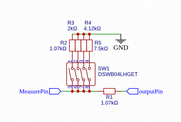

Multi-level "digital" inputs have been a thing for quite a while now. Some have 16 levels.also, i just came up with an idea to utilize 4 bit i2c adress selection and only using 1 mcu pin, 2 pins if you wanna save power and only power the voltage devider network if the mcu needs to read the adress at startup...
Also note that your assembly cost just went up by a fair bit as the operator of the pick-n-place machine now has to load four more reels of resistors into the machine. Manual labour is expensive. You'd be better off by going with R+R+R+R or something like R2R. Not that DIY has to be cost-optimized, but I thought I'd just add that perspective as well.
I'm curious why you'd want to change the I2C address, though.
