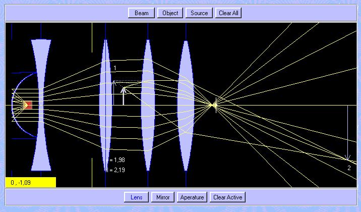

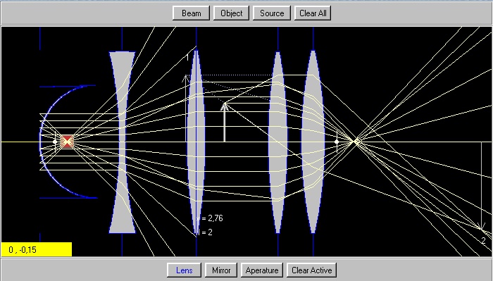

There's one design that I've been considering lately. That's using a parabolic reflector (with the lamp in focal point) and a negative fresnel after that with the same FL than the lower fresnel have but with negative sign.
As reflector you could use PAR64 or PAR56 relflectors which are widely available, cheap (< $/€10) and can be fitted with 150/200/250W type MSD / HSD bulp with a RY 9.5 connnector (I've seen one with double-ended rx7s connector too). That way I think you could get first the collimated light from the reflector (well, almost, as the direct light isn't very collimated) and then widen the spot with negative fresnel for the fresnel & LCD. That way also a larger LCD (15") could be used, with good efficiency, too.
Also if you move the bulp backwards you can widen the spot. PAR64 has 64/8 = 8" diameter, so I guess it works directly with 7" and smaller LCD's, and for 15" you need to back the bulp just a little (I'm not sure if it will work without the negative fresnel or not).

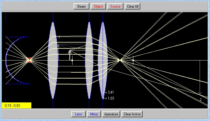

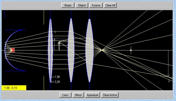

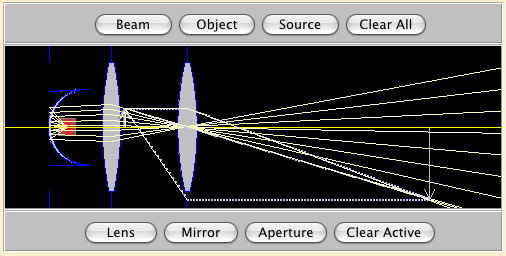

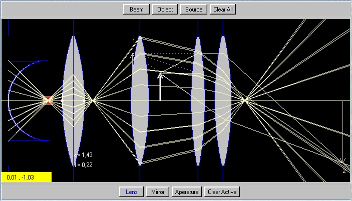

Ah,indeed. The program only uses a (almost) half point source.
As i see it; you loose a lot of light when you place your lamp at the focal point. Or atleast the picture wil be blurred.
Place the light source in the middle of the sphere would be the right way i think.
But also then, the exact middle has to be found otherwise you also get unwanted results.
It´s a very nice program you have found ! But it´s only use the half light from the point source, what about the light going up and down wards ?

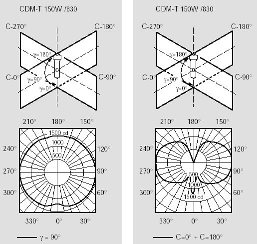

What you are simulating is a double-ended bulb or a halogenbulb. A 1-ended bulb has the most light going up and downwards because you have turned it 90 degrees. As you can see in my diagram on page 117, a 1-ended HQI-bulb doesn´t spread the light very much directly from the bulb, the most light will bounce in the PAR-reflector. The light directly from the bulb will go in a straight beam to the fresnelllens.
mathias said:A 1-ended bulb has the most light going up and downwards because you have turned it 90 degrees.
So you think that when using a bulp inside the focal point the direct light will not be a problem? How about if you use HSD/MSD type MH bulps? I must order one PAR64 (or PAR56) reflector to try with it.
Maybe it's possible to get the source code for the Java app and modify the light source.
Origonal adress

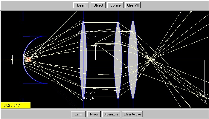

A PAR reflector is a PARabolic reflector and that is diffent for the spherical reflector. And I agree with mathias that this program can only be used for dubble ended tubes. I found the orginal adress of the program including mail adresses from the makers. So go on and mail them, maybe they can add a parabolic reflector to.
http://webphysics.davidson.edu/Applets/optics4/intro.html
I can´t see any problem with the bulp inside the focal point, I get a very sharp picture with my PAR30 reflector, the direct light beam from the bulb actully compensates the light that should bounce into the hole of the reflector.
I haven´t seen any spread-data for the HSD/MSD-bulbs, but I think they works the same way, because of the arc-tubes edges.
