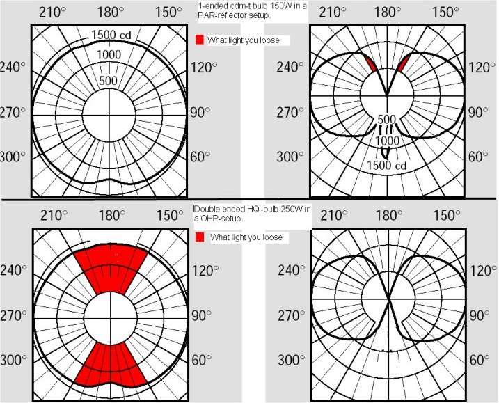

I agree with Diylabs on the fact of the double-ended lamps, the only way to use them is with the ohp-design, but again, you loose much light, as the picture below show.
What I wanna say is that you will get the same light output from the projector with a 150W 1-ended bulb in a PAR-design, as you get with a 250W double-ended in a ohp-design. Because the 150W bulb is much cheaper, here in Europe anyway, there is no point using a double ended bulb, but if you already have a double ended, keep using it.
250W 1-ended bulb, is availible here in Europe as MSD250 Philips and HSD250 Osram. But if you can find them in USA I don´t know.
Also, do you think you can get a manufacturers that makes the reflector with a 90 degrees angle, because that´s what we need if we don´t want to move the lamp backwards. The widest angle I have seen is 60 degrees, there must be a reason why they don´t make it wider.

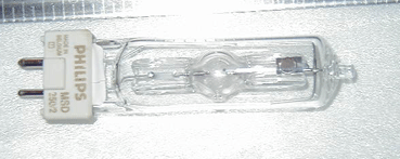

phillips and osram have pdf specs sheets on their site. I have my own contact for ordering those lamps, so I wouldnt be interesting in buying somewhere else. They are both as small as the phillips 150 watt single ended as I have seen and used them both.
Those 2 lamps are used in almost ALL Intelligent stage lighting units made by high-end and martin lighting.
[edit: I attached one of the phillips 250/2 lamps I have on hand.

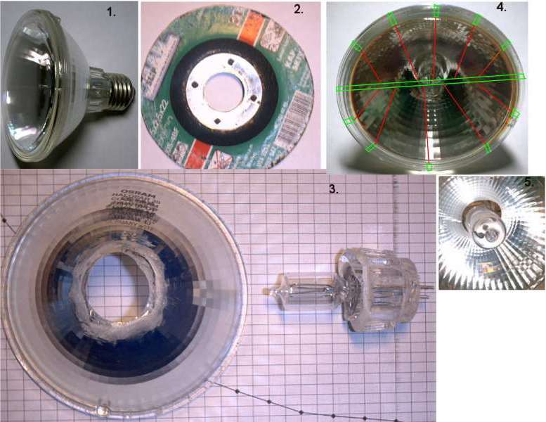

How to cut a PAR30 lamp.
Feel that I need to explane how to cut the PAR30 lamp without to crash it. The first thing you must have is an angle-cuter, with a disc to cut ceramics (picture 2), and the angle-cuter must have some adjustment for the speed, if it rotate too fast you will crack the lamp in wrong place.
1. Remove the metal base with a scissors and a small screwdriver.
2. Start to cut the back of the lamp at the place I show in the picture 3, if you cut it more backwards the HQI-bulb will not fit. Cut it thinner and thinner equal round the lamp, at the end it will break in the place you cut it, if it´s equal thin round the base. If you cut too much at only one side, it will break in the wrong place and a part of the reflector will get lost.
3. Remove the frontglass, this is the most difficult part, the frontglass is extremly hard, so you can´t just smash it. Use the angel-cuter and cut a stripe across the lamp (the green in picture 4) then cut a little at the edge a bit from the stripe, the front glass will break in small parts that you easy can bend away.
Use some sort of protection goggles, very sharp glasspieces can hit your eyes, normally there isn´t any glasspieces with this bulb but, but be carefull.
The hole in the middle is 21 mm wide, and the HQI-bulb is 20mm, so it can´t fit better.

Chasse, yes the light from the PAR30 will cover your back fresnel, it´s very easy to adjust the light angle from the bulb so it fit all size of lcd:s. Move the HQI-bulb 1mm backwards or forwards, in the PAR30 reflector. 1mm is doing big diffrents in light angle.
