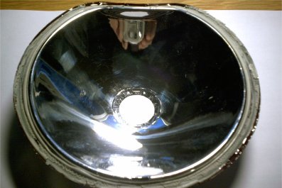

I was wondering if anyone has tried a headlight reflector from a car or other vehicle as a reflector for a Metal Halide or other bulb. Anyone think it could work?

I have thought about doing this, but the refelctor in the headlamp assembly that I have is ceramic, so it would surely crack if I tried to drill it for use with a double-ended metal halide. There are small bi-pin metal halides that look very much like a halogen auto lamp, but they are too low power/output in my opinion. The main problem with using car reflectors is that they are too big ... a good reflector would be about 3" in diameter or less - roughly smaller than the projection lens you'll be using. Another good way to boost output, regardless of the reflector you're using, is to add a condenser lens. If you go with the condenser lens that I carry, then this is a really inexpensive upgrade, too. One last thing I'd like to add is that I think people are putting too much emphasis on the exact shape of the reflector. Yes - there is an ideal shape and size for the reflector, but perfect reflectors don't exist and really good ones are usually very expensive. Most people who have tried my $8 soup ladle reflector find that it gives noticeable increase in light output. I've found companies that will manufacture better reflectors, but usually at a cost of around $100 per reflector! I'll stick with the soup ladle! On the other hand, it would be awesome if someone could figure out a different inexpensive alternative that worked as well - making those reflectors is a pain sometimes!

I have tried a headlight reflector, actually it was an extralight. But it was the most stupid thing I have ever done, it was expensive too. As a reflector for parallel rays it works very good, but for a 15" TFT it´s useless, as you can see it has a big hole in the middle where you place the bulb, but if you want the light to spread from the reflector to fit a 15" TFT you have to move the bulb a little bit backwards in the reflector, when you do that the rays that should be reflecting straight ahead comes in the hole, and the result will be a circle of light on the TFT. An other thing is when you use it with a halogen bulb, you get a very very hot spot that destroys your tft in a second.
