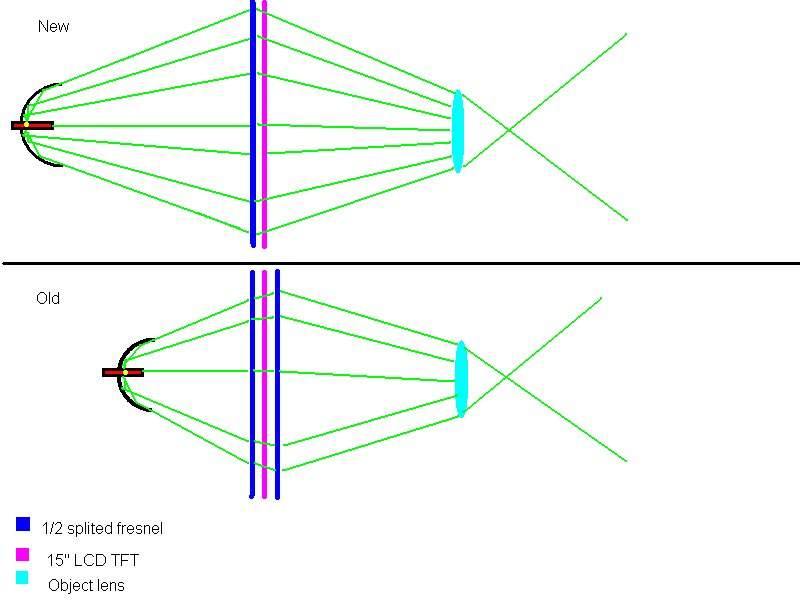

My condenser lens at www.diylabs.org also kills the hotspot effect. Also, splitting your fresnel lens seems to greatly improve how even your light distrobution is, but I don't know if it would cure a hotspot.

And why are we geting a hotspot anyway? Is the ideal light source a laser beam bright enough but hitting only the center spot of the first fresnel say a half milimiter diameter?
Indeed you should! I've never had any problems with hotspots with my setup, but the hotspots are usually a biproduct of the placement of the elements as opposed to their quality. For example, you'll probably get a hotspot if you put the lamp too close to the first fresnel lens or if you have a reflector that isn't positioned correctly (usually too far away).

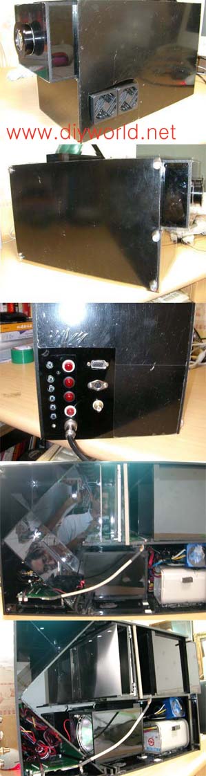

Ok i also wanna ad something to the board. I found more information on the MOVIN 2001/2002. It is still sold in germany (second hand). It is the last single panel projector (as early was told in this topic)
Contrast: 500:1
ANSI-lumen: 250
4x50W Xenon lamps
Hi you guys!! Again another, nothing knowing, newbie;
My name is Frank live in Holland and study chemistry.
I have read my wy around this forum and I must say it is GREAT!! Big applaus for you all. I realy learned a lot and learing still more by reading more topics. I realy love the subject; single vs multiple lightsources.
Also one thing i have to say is: It is hard for a newbie to read up to 114 pages of replies.
Contrast: 500:1
ANSI-lumen: 250
4x50W Xenon lamps

Ok my computer was faster then I wanted it to be so some more information through pictures!
Oh the size is 11,5"x11,5"x23" Not very big

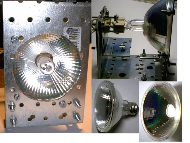

How to get the most light out of your bulb
I have now for a long time though about how to get the most light out of the bulb, the OHP-design most of you are using is only using a very little bit of the hole light the bulb produce. Even with a very big condenserlens you loose over 40% of the light. The new idea is to use a normal PAR30 bulb, cut the bulb and place the HID-bulb in the middle, move it a little backward so you get a wider spread angle. The problem is that you can´t get as wide angle as with the ohp-design, so it will only light up the middle of the screen. The soulotion is to move the hole buld and reflector backwards so the light fills the hole lcd. But if we move the light backwards, the fresnellens will focus the light in the wrong place, depending on the focuspoint of the objectlens. And the big new thing is to remove the splited fresnel in front of the lcd, this will restore the light focus point to the objectlens. The only problem with this light-design is that the distans from the bulb to the fresnellens will be the double. But there is a soulotion to that also, use a mirror in 45 degrees angle, and the distans is the same as before. I´m using this thing now and it´s very bright only with a 150W HID bulb. You can use this design even with small lcd:s. It´s time to leave the OHP-light engine !
