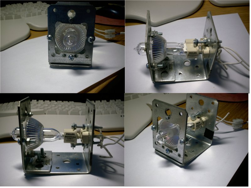

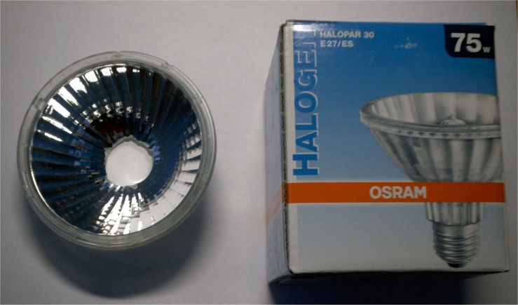

A replay to Faites777, I did a test with a big Halopar 30. I cut it and placed my hid-lamp in the middle. I´m sorry to say it didn´t work, becaurse the lamp only lights up the middle of the 15" tft, with the 30 degrees lamp and there aren´t any wider degrees for that lamp.
In my pj design I instead use a 60 degrees small halogen bulb with coollight reflector. I cut it and placed my hid-lamp in the middle. And it works great ! Very bright with only 150 W. And becaurse the coollight reflector, you can almost run it with no fans.
I think...
2 anglesteel $2.
2 Halogenholder GY6.35 $8. (Don´t need if you have a HID-holder).
1 Halogenbulb 35W 60 degree coollight $6.
Some screws from my junkbox. And of course you need a drillmachine, jigsaw and a glascuter, but that is normal things most people already have. So around $16, I think I spend to make it.
2 anglesteel $2.

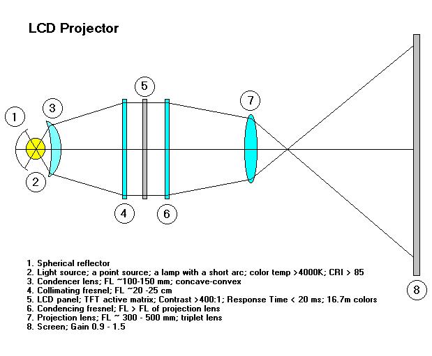

Split fresnel improvement?
mhelin
I have redesigned my projector, split my fresnel into 2 parts, and duplicated your layout (except for the condensor and the reflector). I do have the 80mm triple, and the 8.8/13 fresnel from diylabs. I cannot get any increase in brightness nor does the lighting even out anymore than before.
Please give me the distances between your optical components so that I can duplicate your setup "exactly" and see if there are any benefits to splitting the fresnel.

mavmesa,
What type of panel you use? It is possible that some LCD's (like my dismantled FP567s) absolutely require two fresnels (collimated, straight light rays though the panel). My distances are ~8.8" from the bulb to the 1st fresnel, the second fresnel is next to panel, tilted for keystone correction, distance between LCD and pj lens is about 10"-12" (I use the shorter FL pj triplet from diylabs, same frensel as you). Check that you have the grooves of fresnels inside.
I think we can't improve anymore this design. Though I'm happy with mine I'd like to use a smaller (~150W) bulb but there are no wonder reflectors or condencers available that could make it possible to use 100% of light for projection. There are only small improvements to be made, maybe 10% brighter image with better quality components (or with less components like without mirror). Maybe in future there will be LCD's that let more light through when ON and less when OFF improving both contrast and brightness. Till that day nothing can be done to make things better.
Btw. I've seen TFT monitors (17") with 800:1 CR, how would that be? Sanyo PLV-Z2 will have CR of 1300:1 even when it's LCD and not DLP.
NEC 1550V
I am using the NEC 1550V. There is no discernable difference in light output. Possible our difference is that your panel is more picky about the angle of light entering it.
I will stay with the new design as it is more flexible. Since I have split the fresnel, I now have debris on the grooves and seem inable to remove it. Any ideas?
