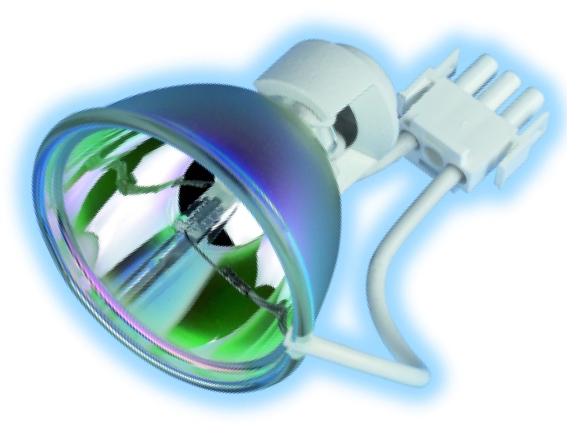

This is a picture of the UHP-lamp unit in my commercialprojector, surprising they use normal plastic around the lamp and in the lamphouse, so I really wonder if the heat is a such big problem.

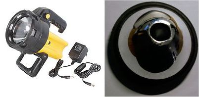

so my question is: where do we get such a high reflective reflector like this one in the picture the alchemist posted?
that was my thought too; don't they melt at the heat the lamp produces? i would like to have reflector like that, but unfortenately the reflectors are not sold seperately :-(

most arent made from glass unfortunatley
I don´t really know what you mean ?
The reflector is made of steel and it wont melt, the bulb used in those lamps is a 55W halogen and that bulb will be very hot.
I payed €15 last summer for that lamp. Buy two of them if you are going to take one of them apart. But yes it is not so cheap for a reflector.
mathias
most torch lights reflectors are made of plastic, sorry i was unware yours was a halogen search light, infact its the first that ive seen being a haologen.
