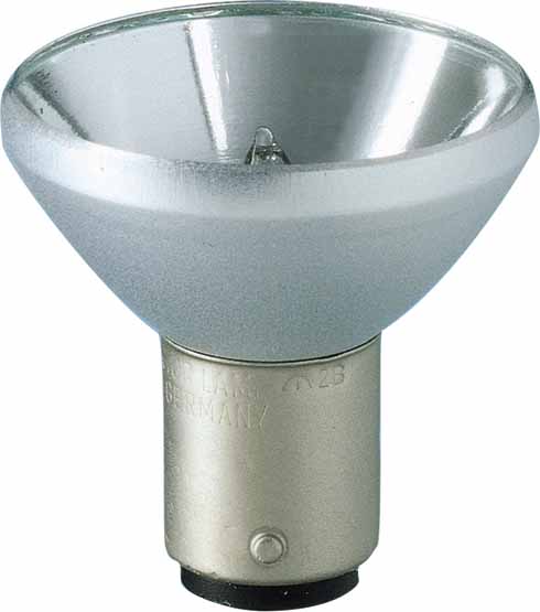

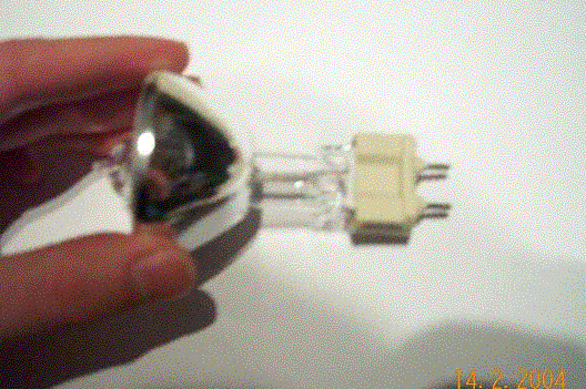

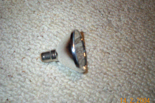

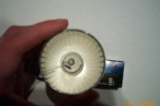

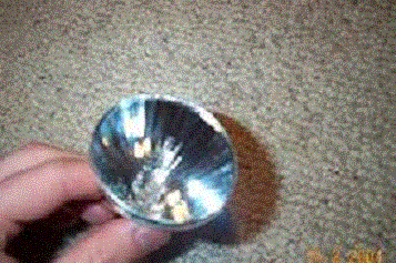

i think i hit the jackpot, with the AluLine Pro in combination with the cdm-t 150W from philips, i will post some pics today...
but i think with a cold mirror and a heat blocking glas i will use, it will be no problem...
Heya slize, nice find buddy, i think u will find the cold mirror will be all that u need, ive got some here also and its good stuff, removes about 90% of the heat, also are u in europe bud? just courious as to where u got your reflector from.

hey ace,
thx man, yeah i am from europe; i have 8 of this bulbs (Aluline 56) left here, if you are interested... normally they cost about 12 euros one bulb, but i got it on ebay for a very good price. the exact print on the package says: Philips Aluline Pro 50W and it has B15d socket
there a three types from Aluline: 111; 56 and 37
these are the diameters of the bulb in mm
just mail me if u are interested ak2kde@yahoo.de
