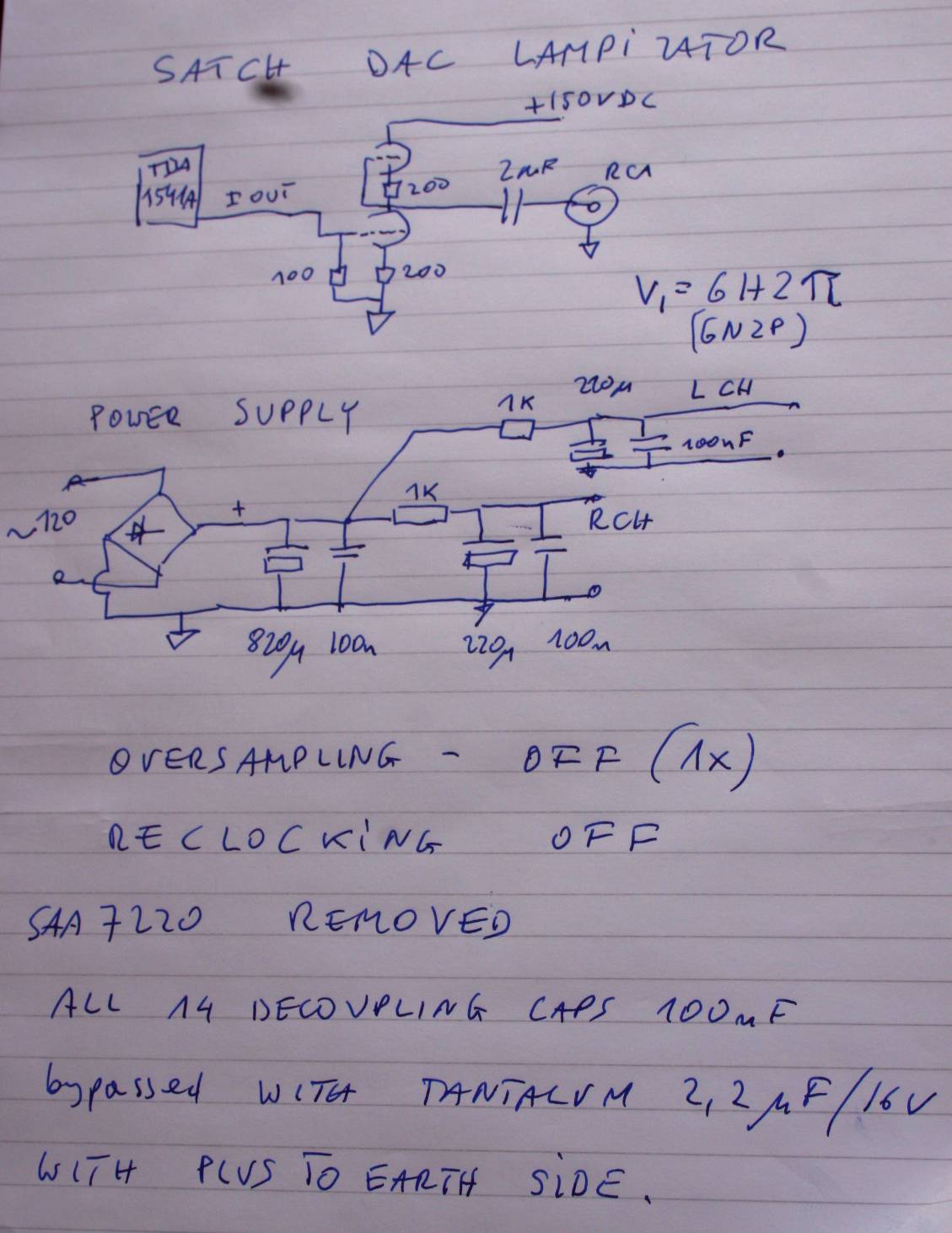

For the 6N2P i am using a setup like this :
http://lampizator.eu/lampizator/references/SATCH/IMG_5501.jpg
It sounds very nice. I use one power supply for the high voltage and another psu with two independent windings for the 6.3V heaters with some kind of soft-start and lm317 regulation. Its based on this design : Tube DC heater PSU with soft start - iAMP - DIY way to build Your own amplifier

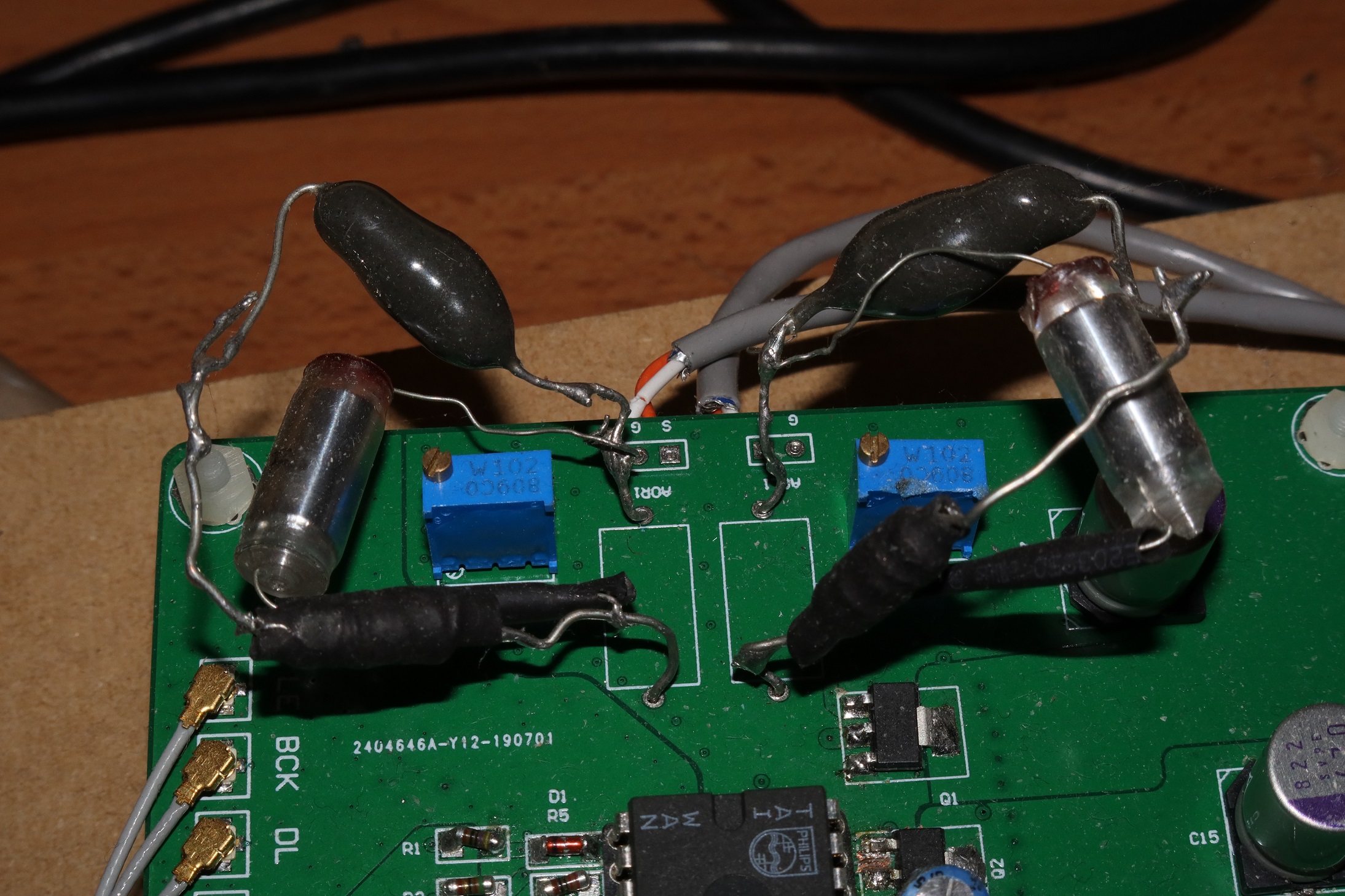

Here is how I wound my resistors:
DIY_Copper_Wire_Resitors
I used Isotan Constantin wire (or something similar) that I purchased on ebay.
The wire is available in various resistances. The wire diameter is very small, so taking the insulation off the ends and keeping the wires from tangling was challenging.
Here is a picture of my diy resistors. Each channel has a 15R and 50R resistor in series. In previous incarnations of my TDA1541A dac, I had used 50R and 15R resistors separately in conjunction with a 5842 tube gain stage.
I cover the later resistors with epoxy to protect the delicate wires from accidental breakage.
