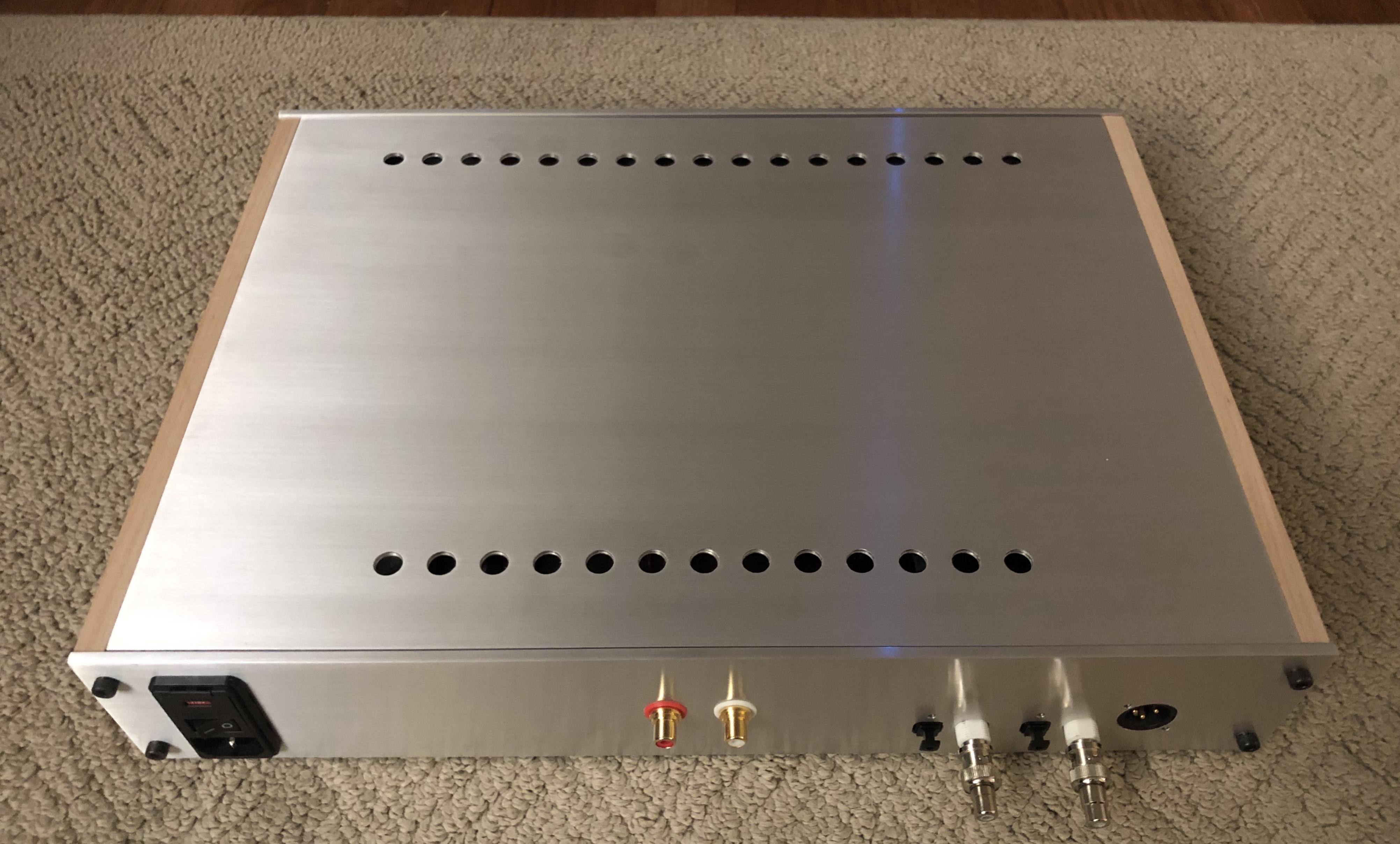

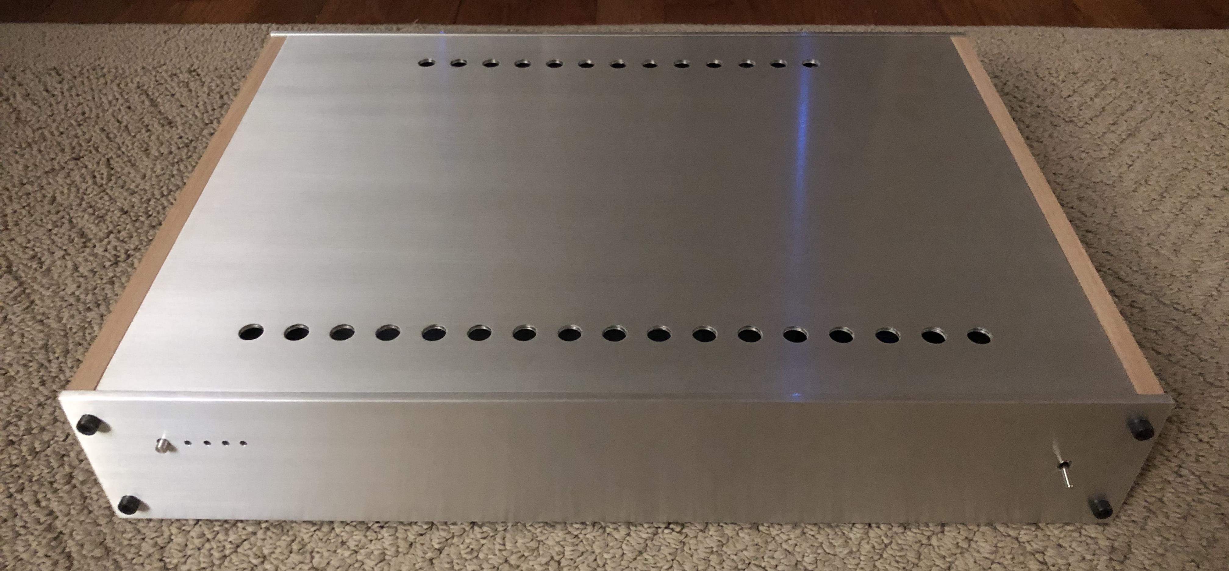

I finally finished up the casework and got a lid on the D3. I took a bit of time rearranging my system to try and have my digital front end organized nicely.
It’s been probably about a year of planning and building to get here and finally be able to sit back and enjoy it.
I have been enjoying it a lot over the holiday weekend here.

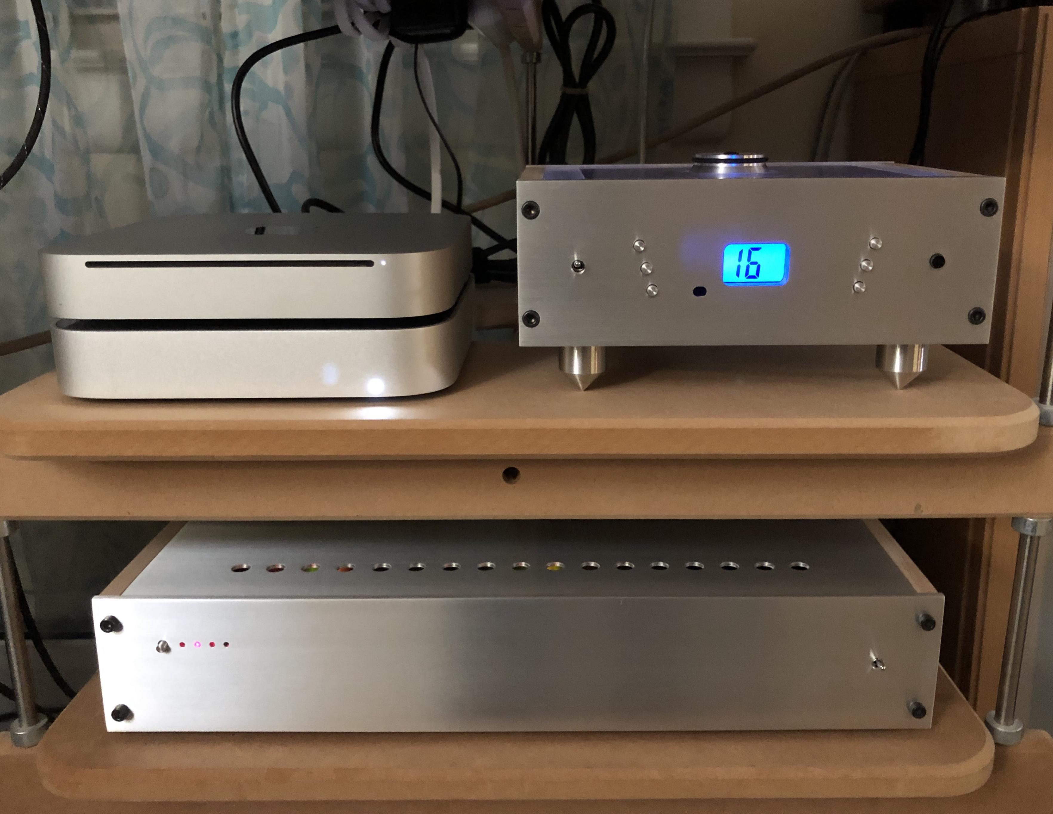

I’ve attached a few pics of it and the rack (I hate the rack and it needs a proper replacement...sooner or later).
I am using a rebuilt Mac Mini to stream from iTunes with an App called Bitperfect that loads the music into RAM for playback and prevents the OS from messing with the file resolution. It has a few glitches now and again, but I can live with it for now.
One of the best decisions I made was to buy a Luna Display dongle to interface my Pro Pad with the Mini. It has been seamless and completely stable. It allows me to run the Mini headless and have complete control over any software I would want to use on the Mini from my Pro Pad.
I’m also very happy with the Shigaclone project. It sounds great and allows me to just throw in any disc I have been too lazy to rip because I’m busy trying to download new stuff all the time.

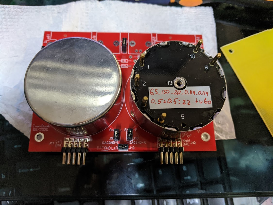

I will be going back into the D3.
I’ve a slightly used pair of bisesik’s transformers I negotiated a deal on.
My understanding is that they are wound optimally to be used with a pair of TDA1541A in differential mode.
I’ll need some guidance with the wiring most likely.

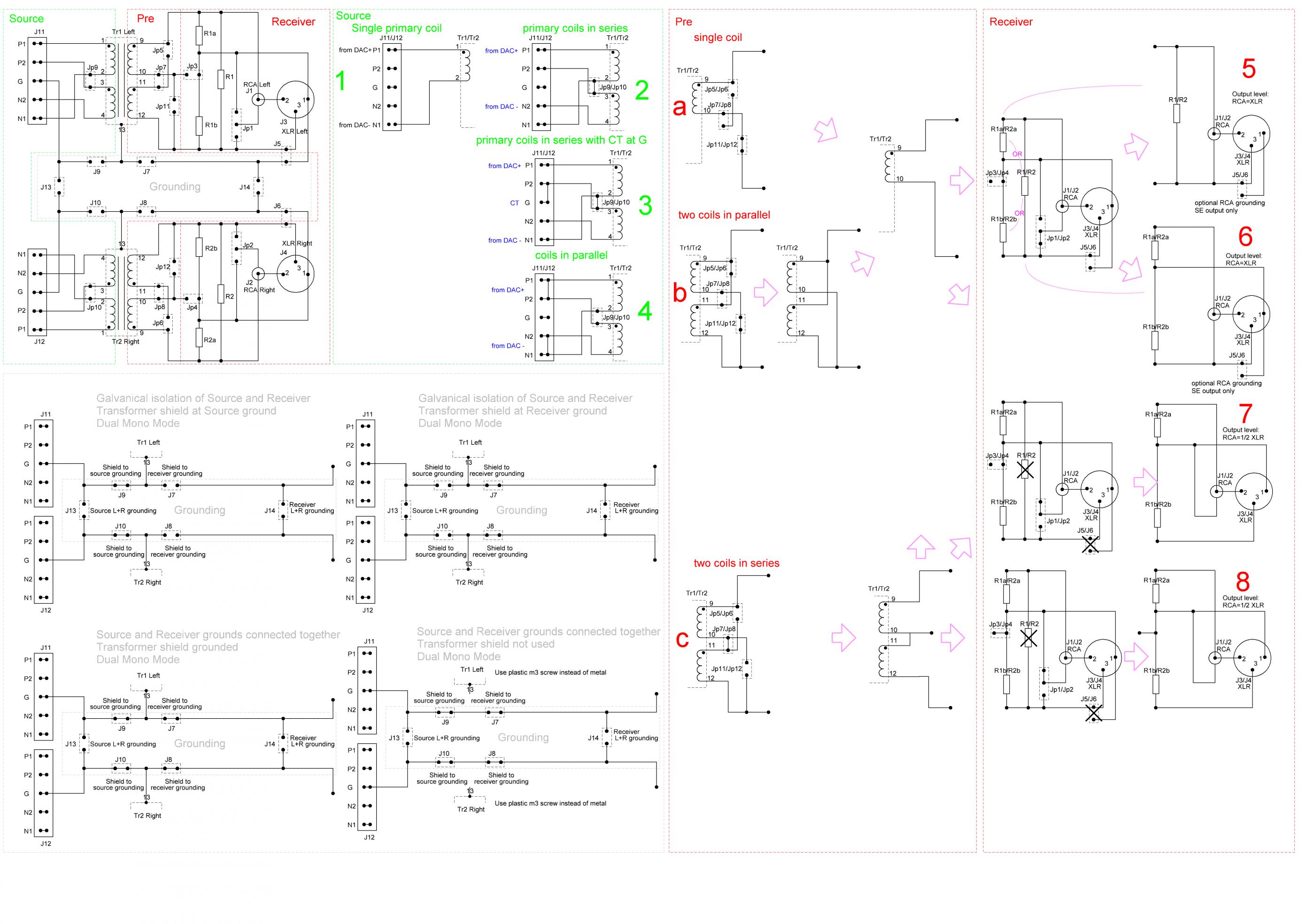

HI Kevin,
here is a diagram for bisesik's transformer. hope this helps
you can find it here on podt # 430 Output transformers for DACs
Hi Ivan
Thanks for the link...I had seen that information before when I was first researching the passive iv solution.
To be honest, I get a headache trying to understand it.
I like to build these projects but I feel like I’m in over my head a lot.
Like they say, a picture is worth a thousand words. That is how I often figure this stuff out.

Hi guys,
I think that drawings will help Kevin to connect the correct way.
