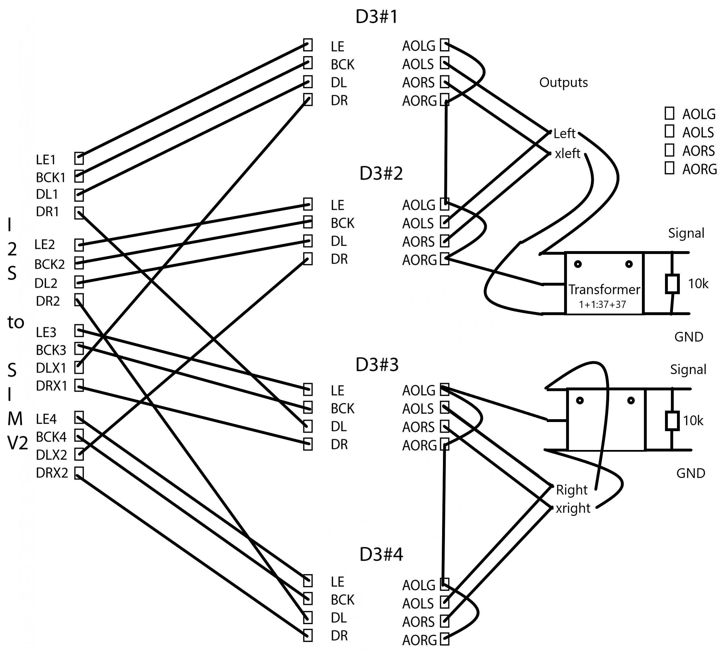

Hi Ryan
When connecting my rca chassis output wiring to each D3 board for either the right or left channel, what orientation should it be in regarding the two sets of output pads for each board? I have one pair of +/-wires for each rca output socket versus two pair +/- output pads on each D3 board.
If running dual mono just parallel the outputs to your RCAs
Will using two D3 boards in a dual mono configuration increase the current output for each channel and allow me to use lower value iv resistors to decrease distortion?
It will increase the current but it will not decrease distortion because the voltage will appear at both outputs. But you'll get a lower output impedance.
I hope the wiring can be clarified and understood. I think it's important to get the schemes illustrated here for end users not wanting to damage stuff. I've put a fair amount of time and money towards this and would hate to end up with unusable parts.
Here is how I have my 4 x D3 PCBs wired up with the I2StoSIM PCB.
2 x D3 PCBs only are required for balanced output but if you double up you have extra current to allow for a lower value load resistor resulting in less losses in the transformer and a lower output impedance - although I still needed a current buffer before my F5 amp.
Also, the way I have drawn the GNDs was for clarity, you should have the signal and ground wires twisted going to the transformer. The Primary and secondary GNDs should be connected as well as the transformer shielding can.

This is what I mentioned in post #812
If using two D3 boards in a dual mono config I would recommend using one D3 board for the left channel and one for the right, you'll get better channel separation this way and it should sound better.
Attached "Dual Mono" or not?
Yes, dual mono.
Balanced?
The wiring from the I2StoSIM to D3 is correct, just how you connected the analogue outputs is wrong, connecting the signal to the inverse signal will null the output. Instead these outputs need to be dealt with separately like I showed in post #824.
Yes...thank you very much Ryan.
Sorry it took me a couple times around for it to sink in.
As soon as I looked at Mark’s illustration again I realized he had come to the same conclusion already.

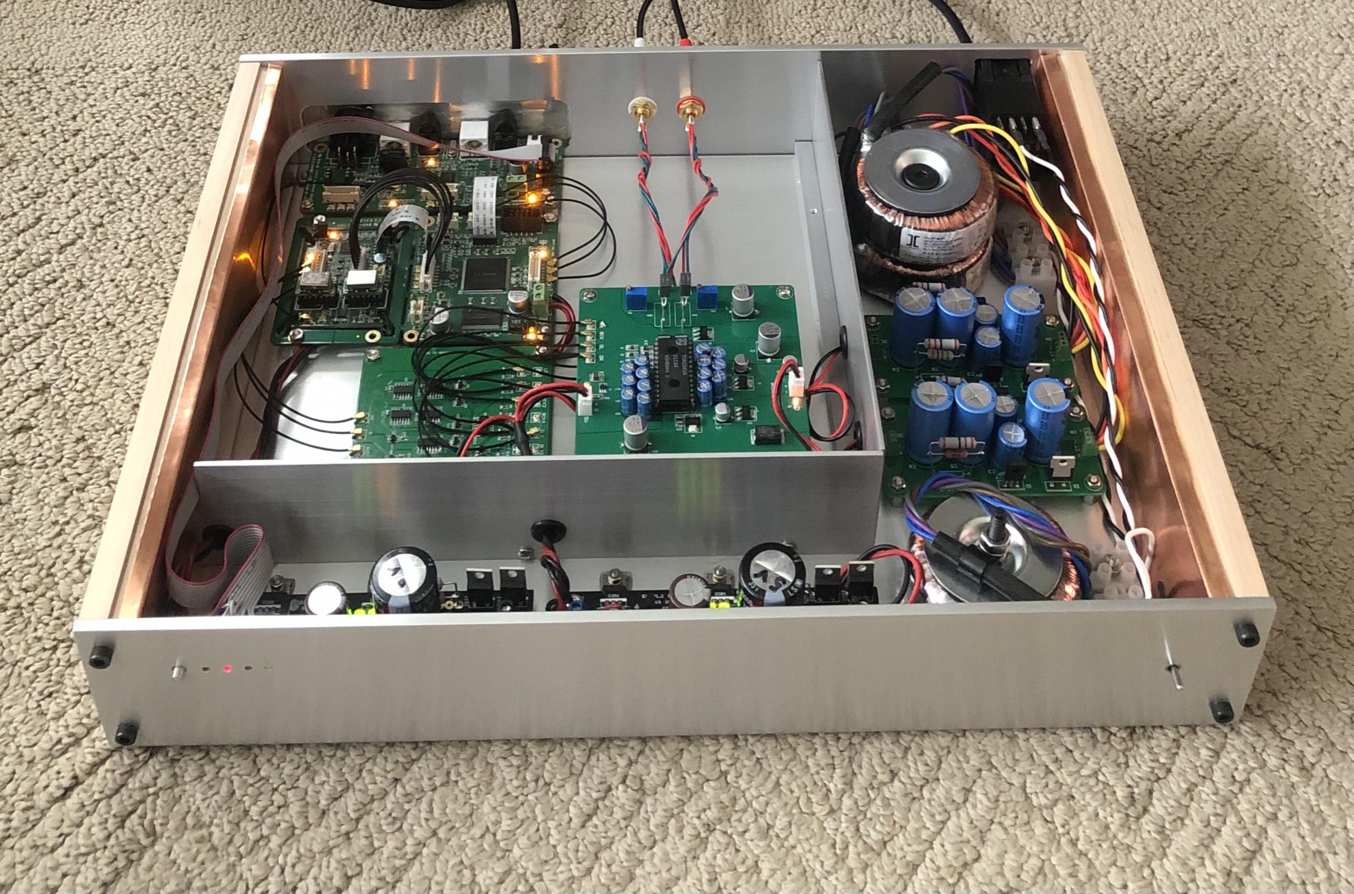

Finally!!!...It’s Alive!!
I stumbled a little trying to adjust the offset, but then realized that I needed to connect the input side of the D3 boards and everything went perfectly.
The CMx supplies are swinging between 25.5V and 26.5V as observed so far. Not sure if I want to try and nudge it up a little for the lower output supply yet or not. It is working and does swing up to low 26.xxV region.
They are wired up in dual/mono configuration.
Using only some parallel Caddock MK132 on the output as iv resistors creating a 110 Ohm load.
It really sounds wonderful. As sweet and natural as I remember my Rotel 855...even better.
It’s taken forever it seems for me to pull this together, but I am really happy with the results.
I am finally using the gain potential of my system. My DCB1 Hypnotize based preamp has Jensen iron on the outputs giving me about 6dB. I am turning my pots up to 50-75% to get ”satisfying...enthusiastic” levels.
I am currently using my experimental open baffles as my horns were knocked over and damaged recently. The horn system is more efficient.
The sound is open with these baffles (LOL)...the stage not as restricted as the horns are more directional in my space which is a bit small for them. Just overall a natural analog like quality to the sound.
I am finally enjoying the work I’ve put into having a digital front end.
