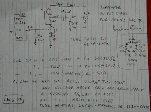

First i used the onboard resistor as i/v, but i made a tube based i/v now. What do i need to change to use this ? Only remove the I/V resistor or is there more to remove ? How do i bias it (with i/v resistor soldered or removed) ?

Hi LinuxGeek,
Which tube circuit you using?
If using lampizators circuit- you need only to remove R33 and R32 as the negative current from the analogue outputs of the DAC will bias the tube to set the plate current.

Hi. Yes first i wanted to try srpp, just because i have all needed parts already available. So i remove r33 and r32. What about bias ? When using the resistor as i/v i played music and adjusted the output so i reached 0v. Will i need to do it a second time now or does the bias not change without r33 and r32 ?
Ty very much.
Having the grid at 0V will allow more current to go through the tube than if you have say -100mV on the grid with a 50R IV resistor. I think this will also change the linearity operating region of the tube. Also you may shorten the tubes life and wear out the cathode faster if you run too much current through your tube.
Anyone that knows tubes please correct me if im wrong.
So in short, no you wont be needing the CCS to get the output to 0V. I didnt use one when I tried this SRPP.

Here are the curves for the 6N1P that is in the Lampizator circuit. For a given plate voltage it shows that as Vg increases (from 0 to negative Vg), the plate current decreases. Plate current is maximum when Vg=0 as Ryan stated.
In the Lampizator circuit, it shows a 680 Ohm cathode bias resistor that provides -1V of bias. The -2mA offset of the TDA1541A provides additional grid bias voltage across resistor Ra (60 to 80 Ohm specified). So the offset current would provide an additional -0.12V to -0.16V of bias voltage.
If the TDA1541A offset current is nulled, then there is no additional bias voltage, which would then change the tube operating point. However since the cathode bias resistor provides a substantial portion of the bias voltage, the loss of the bias voltage from the current offset would not destroy the tube.
Interesting note - the SRPP circuit is push-pull:

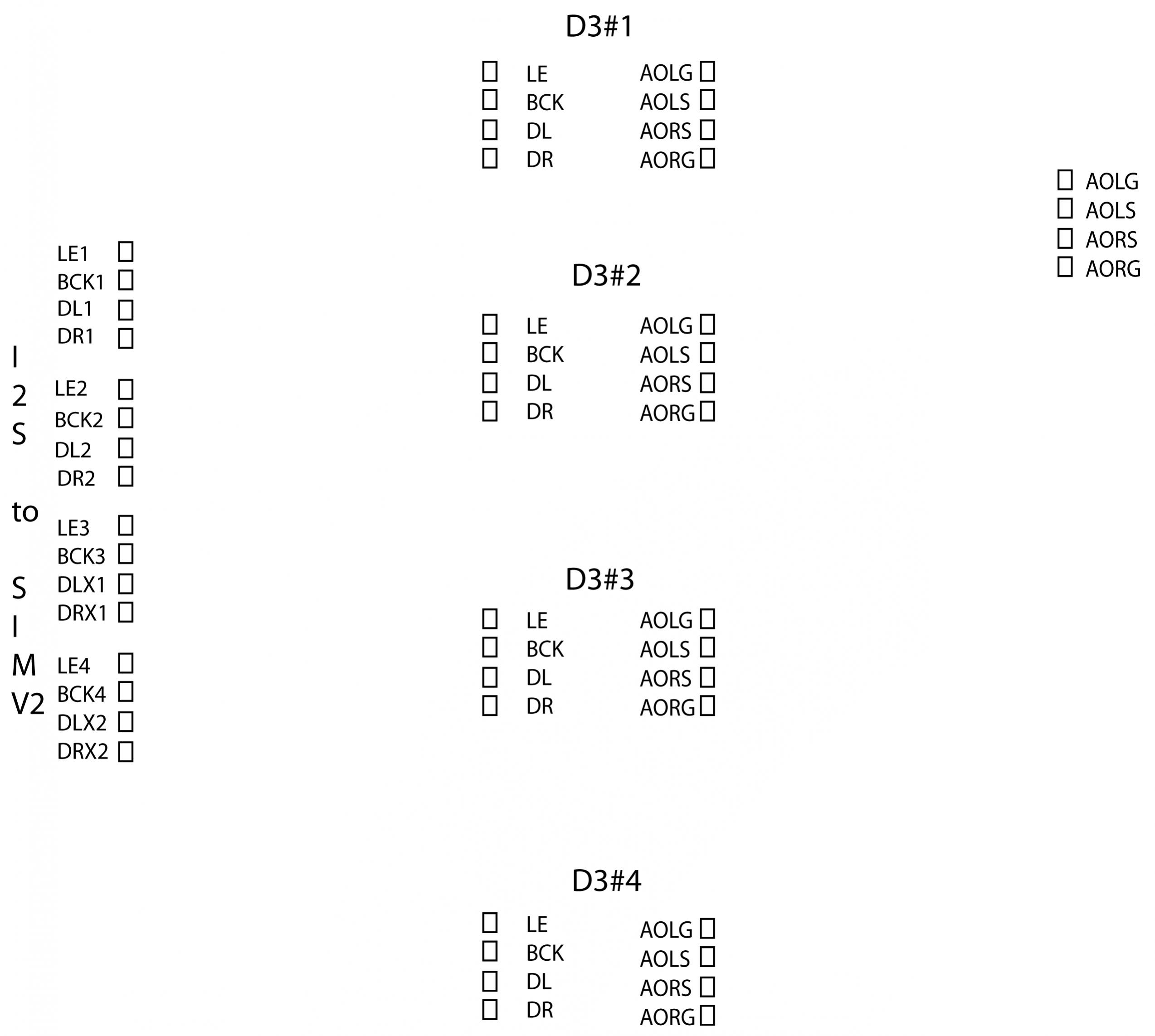

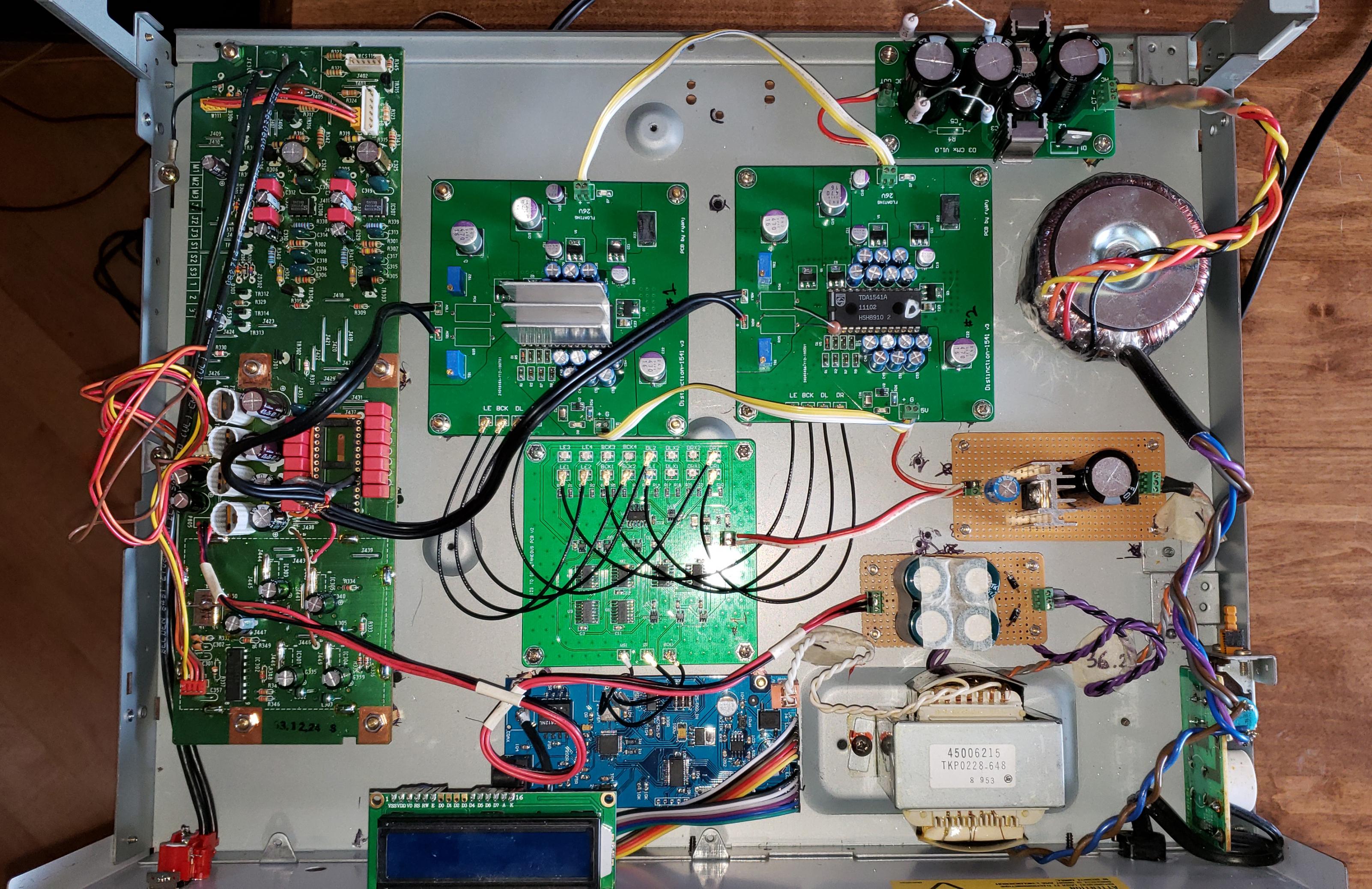

Hey guys,
Got the new correct resistors in place and am testing. All output groups on the V2 Sim board seem to work driving D3 boards. This is my current test setup which must be a summed version. It works and makes decent sound.
I've built a few more D3 boards and will eventually try a quad version.
Anybody care to post the various wiring schema or know where to find illustrations. How to out of the V2 Sim to D3's and out of the D3's into output stages.
This thread could probably really use this info in it.
Mark K.

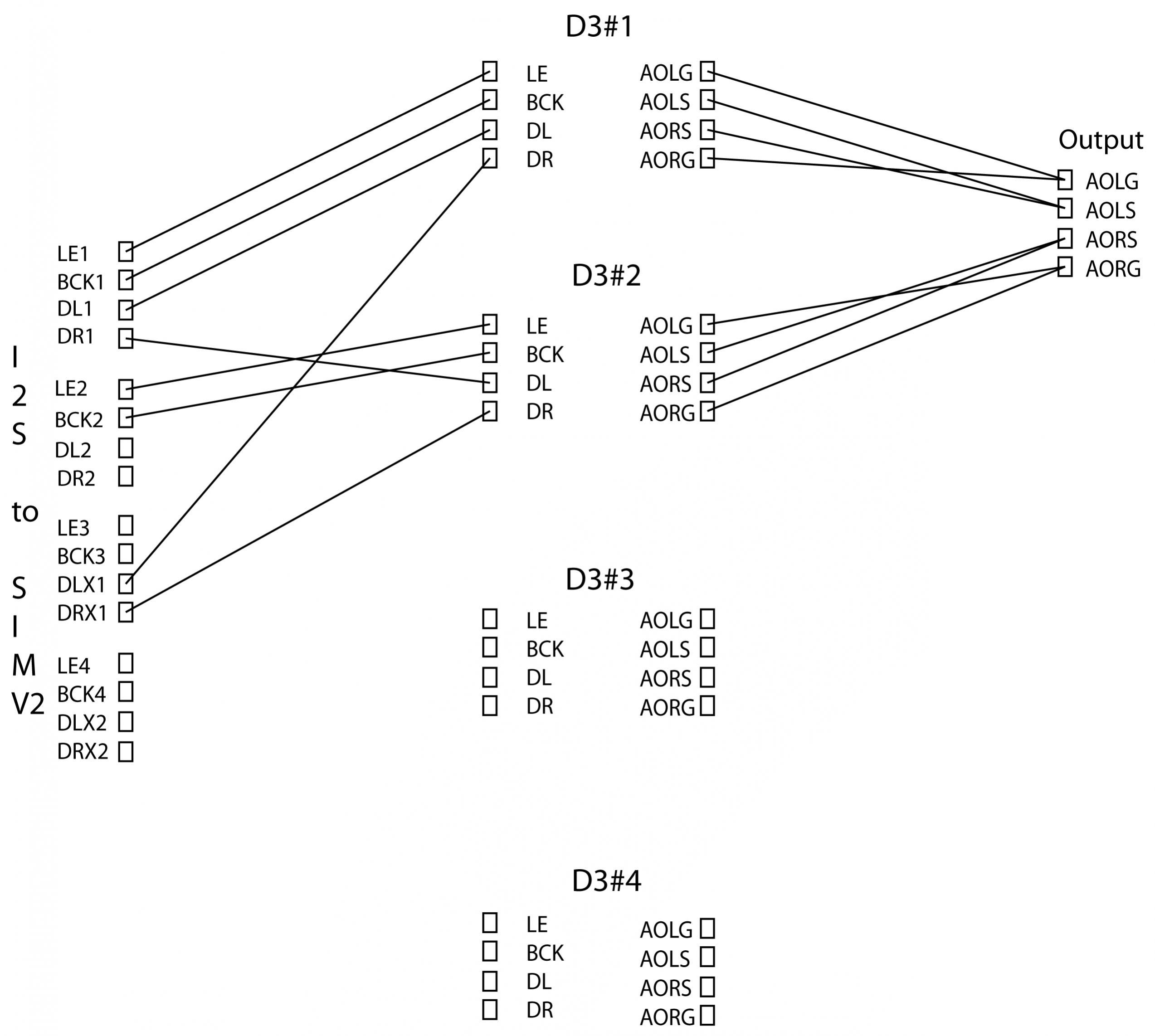

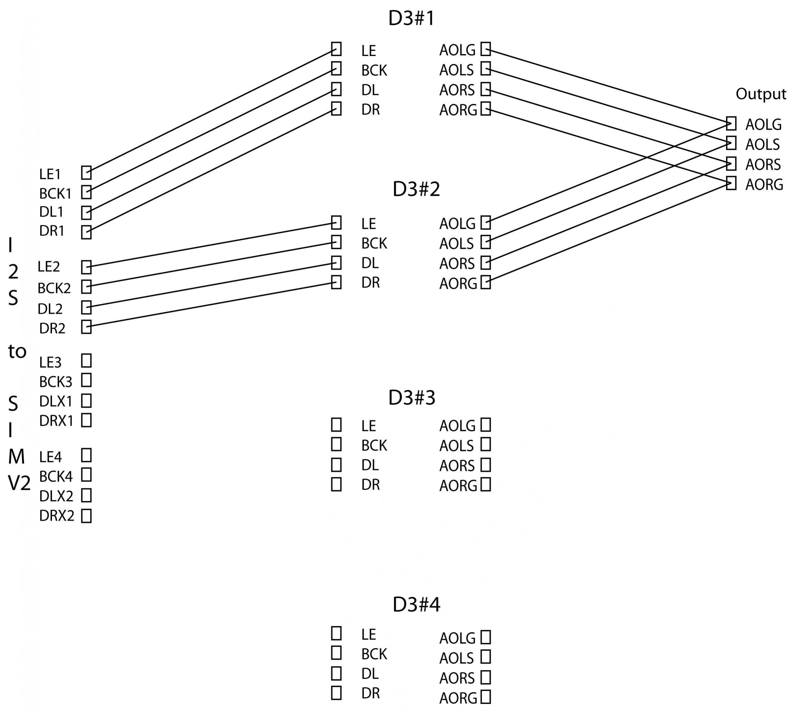

Here is a possible wiring scheme template and my current configuration.
Feel free to post schemes or possible combinations and titles. Not sure what mine is exactly other than summed output.
Mark K.
Mark K.

Attached "Dual Mono" or not?
Hi Mark
Thanks for the update on your DAC project and the information and illustrations relating to the output wiring. I think they will be useful.
It’s good to know you have it working with two boards parallel on the outputs like that. I wonder if you’re getting the benefit of better channel separation that was mentioned regarding dual/mono operation? It seems like you would get the additional current, but I’m not knowledgeable in the matter.
The issue of how the I2StoSim board connected to the D3 only faintly occurred to me. I figured I just needed to make sure the connections weren’t mixed up.
Hopefully we’ll get some feedback on this subject.
The only thing I found regarding wiring multiple D3 boards was Ryan’s post several pages back of his quad stack of D3 boards he was working on to test with output transformers. I can only see that on the top board he grabs one ground and both signal outputs.

Thanks Chrome,
I haven't attempted other connections yet but I am enjoying the builds and sound produced so far!
I hope the wiring can be clarified and understood. I think it's important to get the schemes illustrated here for end users not wanting to damage stuff. I've put a fair amount of time and money towards this and would hate to end up with unusable parts.
