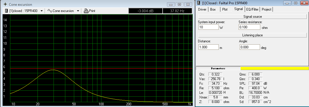

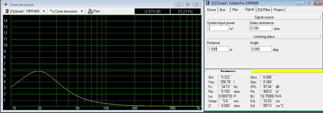

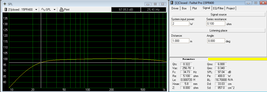

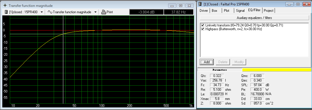

I doubt you'd see this in a 70l sealed box with this driver...
Didn't you notice the Linkwitz Transform for 30Hz ?
At lower SPL, smaller sealed box might give you a bit more bass "presence" but not the extension.
I put 10W in there, however at 2W the Linkwitz transform could be at 20Hz, just didn't want to exaggerate anything. Although amplifier power increases at lot due to the EQ, subwoofer won't be necessary.
