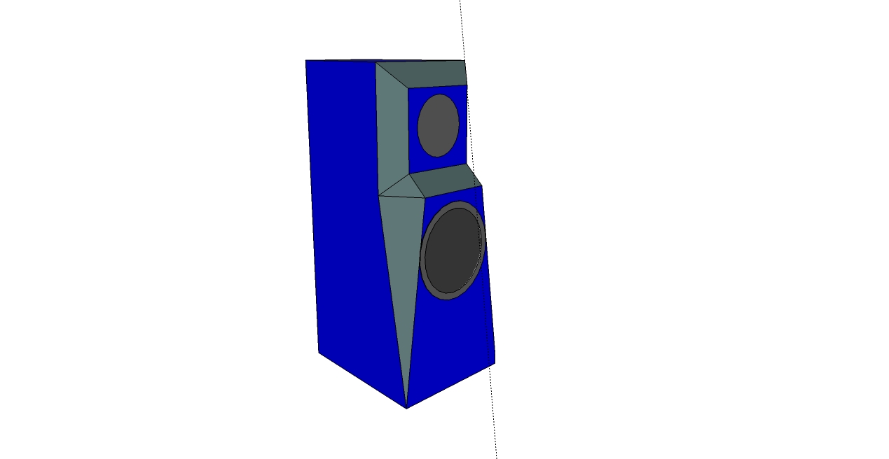

Sorry to complicate things further, but what about double chamber aperiodic bass loading ? Lovely tight clean bass. I quite like the sound of a small full range with a woofer to augment bass. My audiolab Q DAC is MUCH to smooth at low listening levels for my taste, but the M DAC is supossed to be better.
Thanks for interesting info, it looks good. Except it seems to be sensitive to proper "tuning" to get it really work as resonance damping, isn't it?
I have looked at magnetic planar speakers - it's a pitty but it seems to have toomuch problems (low impedance, room and listening position picky, resonances ..).

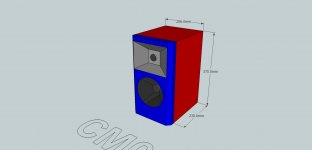

I have thought about FR plus bass too. Because woofer should play relatively high (300-400hz ?), it should be close to FR driver. With big woofer (10/12/15") it's problem, more important for small listening distance (<2m).
What about 2x8" d'apollito ? Low crossover frequency should be good for this ?
Box will be tall (130-140cm), but it's not a problem. Separate sealed chambers for each driver could lead vertically to bottom where second chamber for aperiodic damping can be placed and filled wit rockwool.
I like this idea, what do you think about ?
