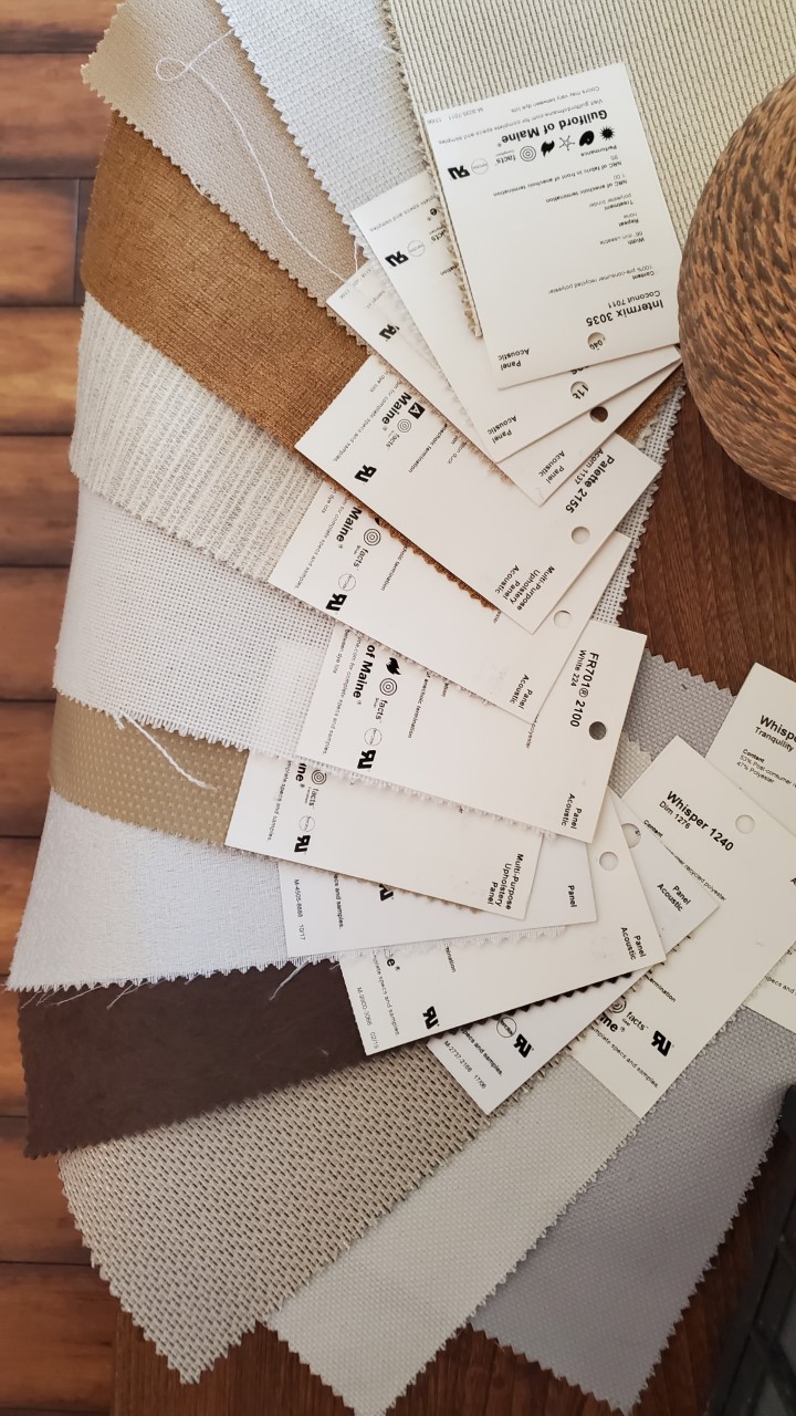

The room is in the basement, 15x17 with a 7'8" ceiling, lower where HVAC runs. First step is a complete removal of all drywall. Then move HVAC return, so flow and Return are at opposite walls so it's visually and acoustically balanced. Reframe walls for 2x4 centers. For the walls, I haven't decided on all absorption, all pressure panels or alternate between the two. Aesthetic goal is all absorption so no absorption panels would be inside the room, but necessary if the walls were hard surface pressure panels. The ceiling 12"oc trusses will be completely filled with absorption, strapping across to create a 24" grid pattern. Fabric stretched and stapled across all the absorption on walls and ceiling.. Also going to discuss it more at this site.Home | The-audio-expert
-The fabric is from Guilford of Maine - some samples in pic.
-The insulation will be 4" Rockboard 60 with a synthetic fiber fill material covering the rockboard before fabric install.
-The ducting will have a 1" rockboard covering - best I can do to save height.
-Floating subfloor with Carpet. Shag carpet if I can sneak that one past my Woman😀
-Home theatre/2channel combo on one end and 2 channel off of side wall..
-I'll play around with diffusion on home theatre listening end later.
-I'll measure and listen to final results of the bass response, then potentially look at a Bass Array for a flatter bass region, but my feeling is that it wont be necessary.
Side note - I'm working on a room in the GTA that holds a Grand Piano. Before Xmas, I finished 2 foot wide ceiling perimeter absorption with Guilford fabric installed. Inside the absorption perimeter the center of the Trusses will hold forty 2'x2' quadratic diffusers, targeting 1200hz to 8khz. The owners are deciding on the type of wood, then all will be made in home shop.. The walls will be treated after piano is reinstalled and I can measure reverberation.

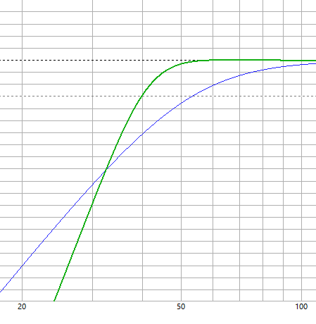

Properly damped sealed is great, so clean. I just put together test boxes for the start of a 40L sealed set with an 8 inch woofer in each. But it doesn't quite match the low freq extension of my 20L ported, but has 2db more sensitivity. The blue and green curve reveals the response difference. Subjectively, the the sealed bass is close enough to the ported on many recordings but its early roll off shows up on some recordings. The sealed design was chosen for box size and for the earliest roll off I can accept in a sealed speaker.. lower sealed f3 requires bigger boxes or lower sensitivity - Hoffman's Iron Law-.
I'm not a big fan of really big boxes!
Equalized Sealed sub maybe.. I have 2 SB Acoustics 8" Subwoofers. The build quality is awesome, with 11.5mm of Xmax.. Planning to implement them into the sealed speakers mentioned above for lowest possible bass extension I can equalize them to at a low listening level. Maybe only one sub is required for this, I'll see. Solen Electronique Inc. | SB23MFCL45-8
If you can handle the cone breakup of a full range driver, I think Your idea is good. You preserve phase with the full range. Crossing over to tweeter can be a bitch. In my 3way, I crossed my bass to SB(not a true full range) mid at about 300hz and listened to it full range for months while tweeter sat on top unused. It was pretty okay and really nice off axis.
