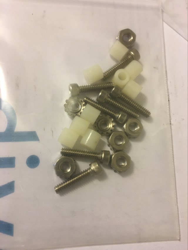

Can someone tell me if the TO-3 screws to mount the Sony P-Vfet and IRF250 will need to be conductivity isolated from the channel bracket when mounting these devices.
I see that only 8 nylon inserts are provided for the two channels in the round 3 output kit from the DIY store with the TO-3 and IRF250 4 thermal pads.
Please excuse me for my ignorance, but I presume that the outer TO-3 case for the Sony P-Vfet is uncoupled from the rest of the electrical circuit and sees no voltage.
Also, is it advisable to apply a non-conductive mica/thermal grease to both sides of the thermal pads when mounting the Vfet and IRF250?
TIA

Yes, you need to use plastic bushing to isolate the screw because TO-3 body is collector. You may say VFET is uncoupled, but you will not afford to risk such precious VFET in case the bracket/HS/chassis accidentally connects to PS ground or negative.View attachment 1057571

The plastic bushings are for keeping the 2 leads (which go through the T bar to the circuit board), separate from the T Bar. There are 2 leads x 4 devices = 8 bushings.
As far as I can see, the "nut" end of the bolt/nut assembly grounds the "can" of the device to the circuit board. The device should be separated from the T Bar by the thermal pad.
Thermal pad - the silicone pad / Keratherm type pad don't need thermal grease. If you are using Mica sheet, or a ceramic thermal pad, then yes, non conductive grease on both sides.
For the P channel VFETs only, this circuit runs the transistor case at ground potential, however we still isolate it in case we need to float it for noise reasons.
So the poly tubes go in the bolt holes, not the ones where the VFET leads are. Man, I am glad this was brought up. The original VFET OS came pre-built, and I did not realize that those were to protect the bolt from the T-Bar. I have some ceramic pads. Does it matter if the nuts touch the solder pads on the circuit boards, or are those not connected to anything?
