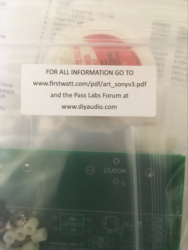

Yes, I understand what Ben Mah is conveying, but as I stated the package of resistors I received in the P channel kit I just purchased had a white label attached to it with a web link for the resources to build the round 3 P-channel Vfet was 404.
There was no BOM included with the parts I received other than the information on that white tag that was included with the current DIY kit the store sold me.

Yes, I got the document you linked and also the one from Ben Mah.
I just wanted more clarification since the white label attached to my parts bag that stated for all information go to the firstwatt.com web link and the Pass Labs forum, in which I did.
The confusion I brought up with regards to the 27K resistor and the 10k resistor was from the web link on the parts bag being DOA = 404. I was just trying to make sure (clarification) that's why I was asking if the 27k resistor was superseded by the 10k resistor.
Jason has already acknowledged there was a slight information anomaly in the works and will be taking steps to address it.

Sorry about the delay, sometimes life gets in the way of audio...
10K is the correct value, and is also specified on my schematics and BOM in the article unless I am mistaken.
Actually, I don't know where the BOM in your picture came from unless it was some early copy.
In any case, 27K would have worked fine also.

The BOM is from 6l6's build guide of the first P-channel Vfet loterry build.

Yep - and I think that is where the confusion came from ... DIY VFET part 1 was using 2SJ28 and had R8 = 27 kOhm, and in the "OS2" output stage in the VFET part 3 series, in the P channel version for the single-die 2SJ18, R8 = 10 kOhm.
