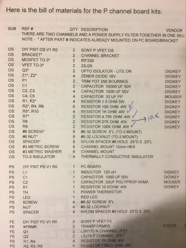

Hello,
I sent an email to the DIY Store for clarification but it's been unanswered.
My question is with regards to my recent order for the Vfet output stage.
Going through the parts (resistors) for the assembly of the Sony Vfet P-channel OS kit I noticed that I received a different pair of resistor values for the OS R8 as listed on the bill of materials from the NP PDF file.
I received two 10.k ohm resistors where the BOM for R8 calls for two 27k ohm resistors DIGIKEY part number PPC27.4KYCT-ND
Was there a revision change and the two R8 27k ohm resistors are now superseded by the 10k ohm resistors.
Also the link to ----> https://www.firstwatt.com/pdf/art_sonyv3.pdf -----> is DEAD!
The DIY Sony VFET OS2 Amplifier is here:
https://www.diyaudio.com/community/threads/diy-sony-vfets-os2-official-thread.384256/post-6971207
https://www.diyaudio.com/community/attachments/diy-sony-vfet-amplifier-os2-pdf.1035400/
The schematic and BOM for the P-channel 2SJ18 show R8 as 10k.
Hi Ben Mah,
Well I received two 10k resistors for R8 not the two 27k ones as outlined in the BOM.
The DIY store has thus far been non responsive to my email request asking for clarification as to why I received those two 10k resistors and not the two 27k resistors.
Also I have the PDF from Vfet from the first lottery build P channel amp, but the little white sticker attached to me bag of resistors shows the web address I listed above as the place for the schematic/pdf.
I looked in my parts bin and unfortunately I don’t have the two needed 27k resistors need to complete the build.

Confused - you originally said that you received two 10k resistors.
No, I was at work and I meant that I received two 10k not the 27K. I was not able to edit my first post to clarify it.Confused - you originally said that you received two 10k resistors.
