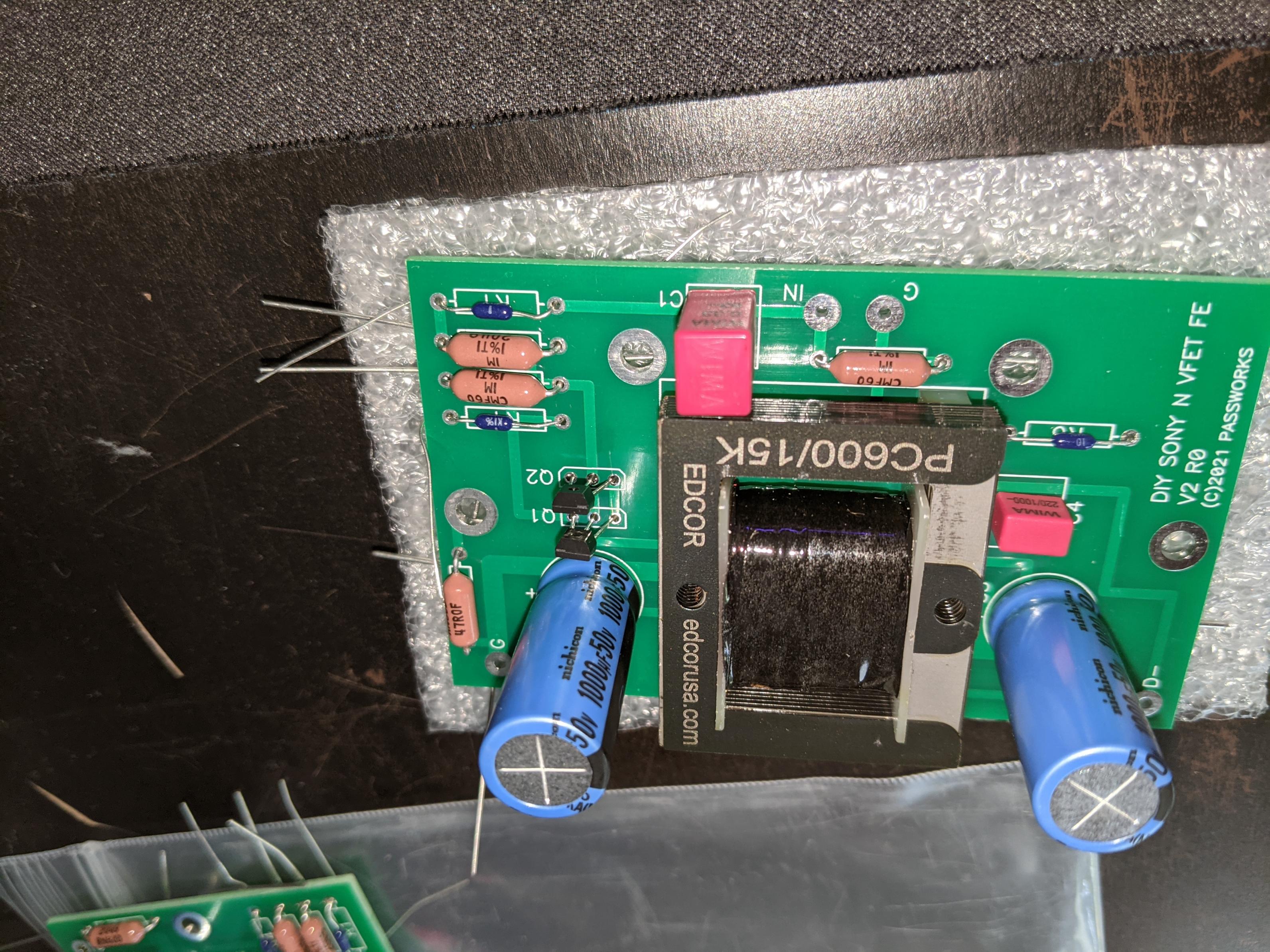

BOM says .4W≠.25W
Look at it! So tiny.
Just wait till you open the Detailed Parts List for the VFET front end card named Marauder. It provides error prone builders MANY more opportunities to order the wrong part, accidentally skip a line-item, mistype one character in a stock number, confuse nanofarads with microfarads, etc. A wonderful training exercise to (painfully) discover What Can Go Wrong.
