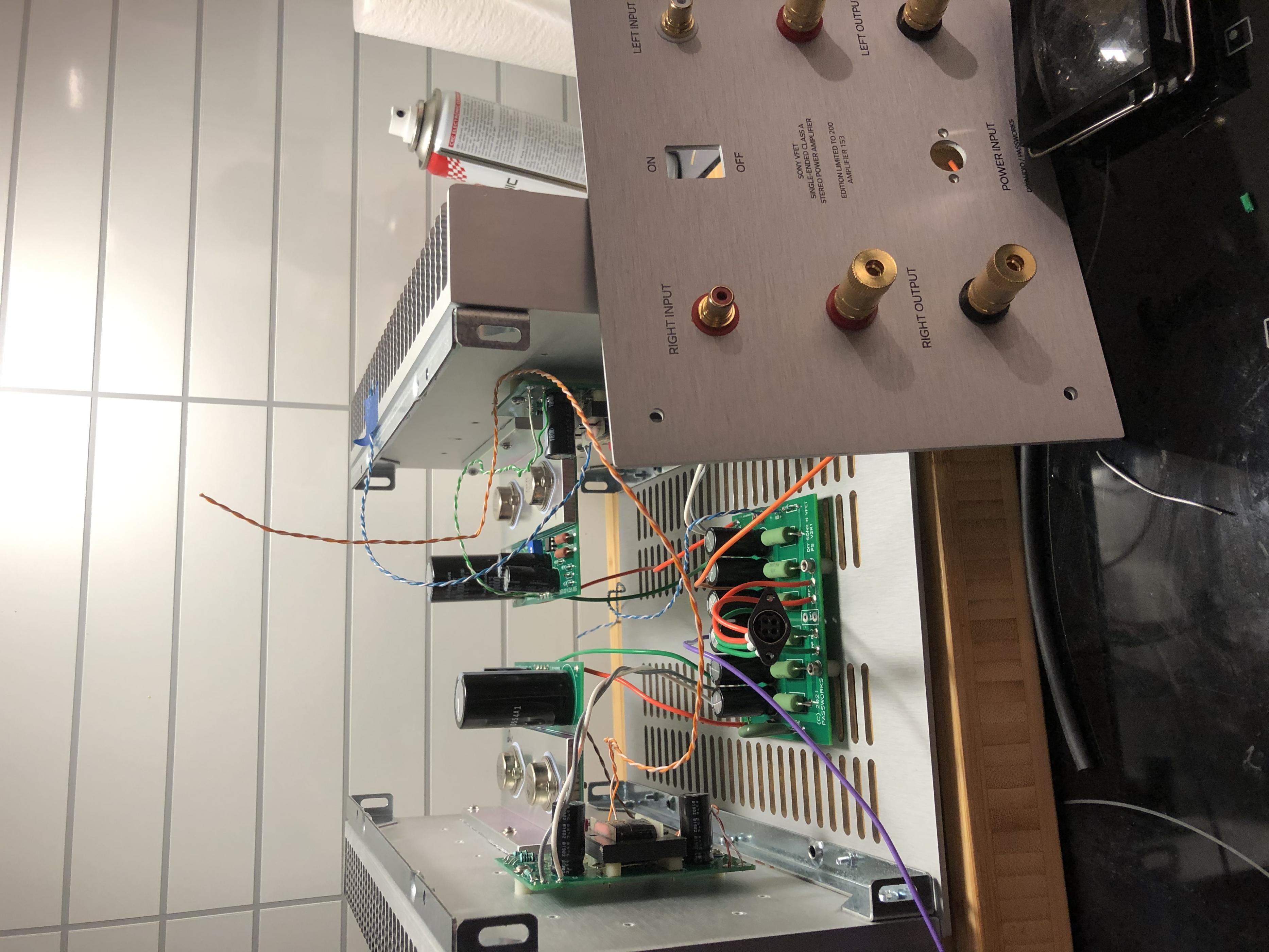

The VFET case should measure hotter than the heat sink fins. Mix-up in reporting the temperatures?
I double checked, the top of the case is is indeed around 41C. The "valley" of the fins, where the T-Bracket mounts are at 48.5C.
I'm using a Raytech Laser thermometer
And I agree, counter intuitive for sure.
He did write cooling fins, i.e. heatsink fins. I interpret that as the fins outside of the amp, and they can very well be 48 degrees C. If that measurement is as interesting as a on the V-Fets is another matter.
If you measure 1 cm next to the V-FET what do you get?
Infrared thermometers may be inaccurate when measuring reflective surfaces such as bare aluminum or steel.
On the T Bracket, between the two transistors, 1cm from the transistor, i'm getting 41.5C

Just checked temperature of both the Sony's, and they are 41.5C on the casing
(both are the same)
The cooling fins are at 48C
Guess things are working as they should?
To be honest, I never found heatsinking an issue for this project as by the touch of hand, they were considerably cooler than the heatsinks in my other VFet amp dissipating 4 times the heat.
As papa said, use of thermal silicone grease can hide a lot of sins and transistors operate fine at 70C 😎

Mine measure approx. 300 x 163 x 40mm
jeff
if you can keep fingers on them, all good
Hmm I can borrow an IR gun but a real thermocouple seems like a more accurate method. On mine after a half hour you can't touch either mosfet but upon cutting power you can touch them almost immediately. So it seems like the heatsinks are working efficiently.
