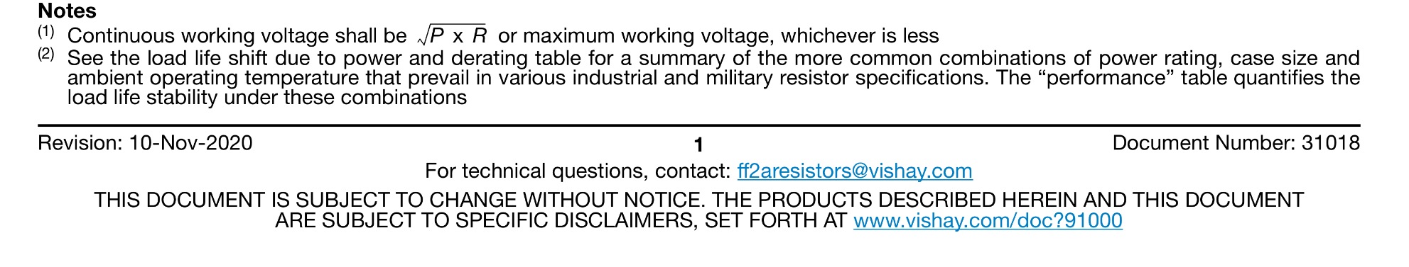

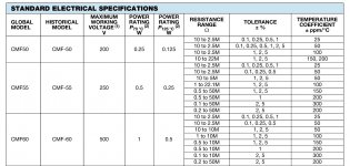

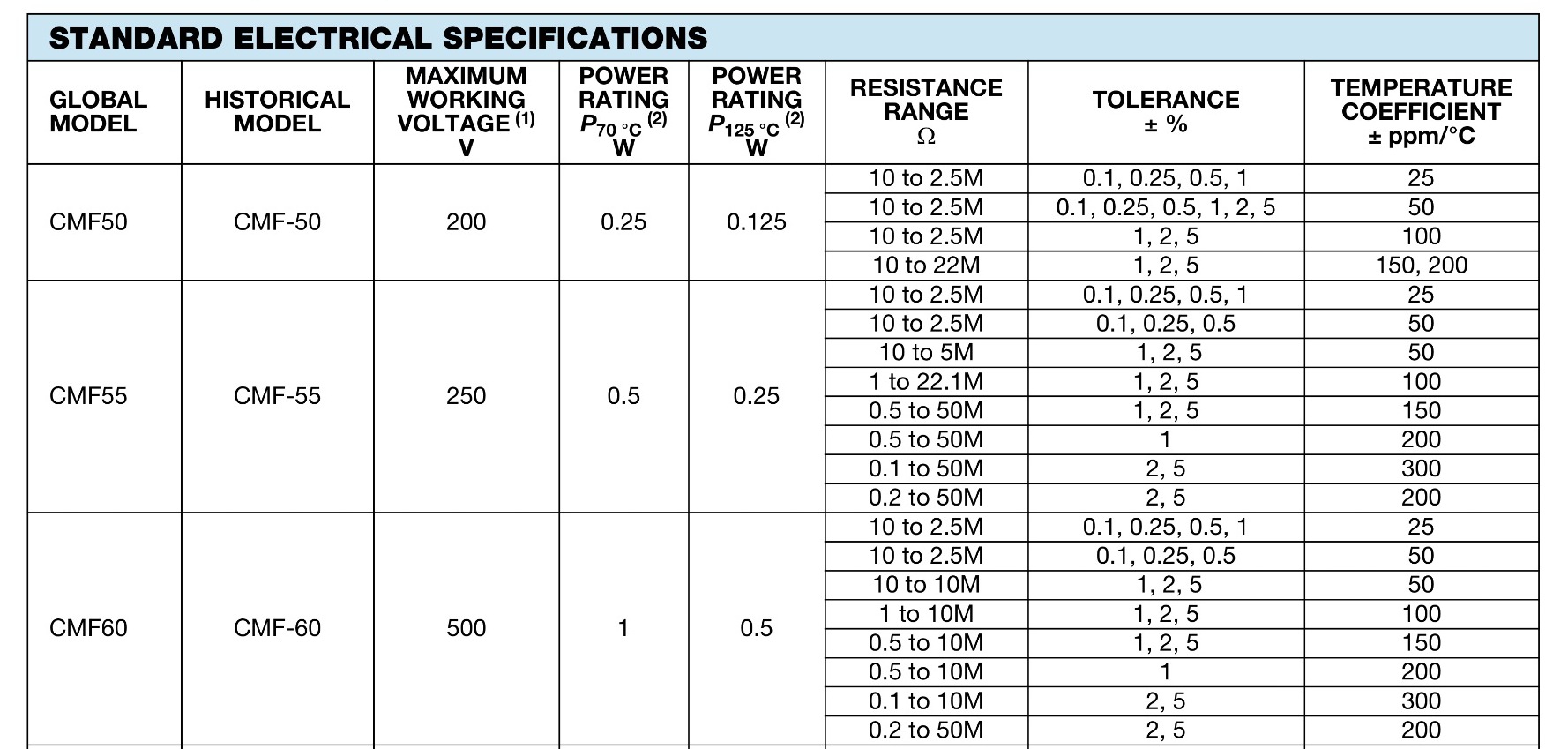

..heat dissipation.
This resistors are made and tested for work in harsh industrial conditions.
We see notes (2) and in Vishay Dale CMF50 data sheet with 70°C max ambient operating temperature
they power rating dissipation is 1/4 W = 0.25W
but with hot 125°C air they can handle only half = 1/8 W
Good news Vfet amplifier air temperature inside is much less 70°C max.
🙂 Kind regards
