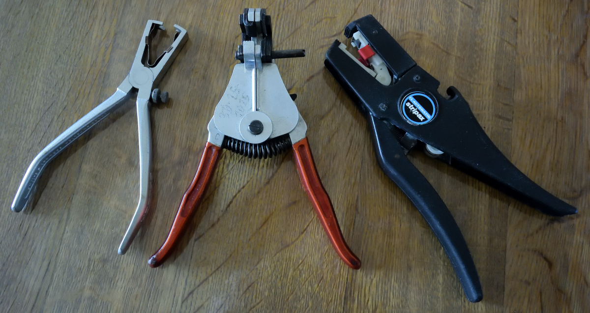

About wirestrippers for PTFE insulated wires.
I have a modern Stripax which is the black one to the right. It works not very well with this kind of insulation.
The old fashioned Beltzer to the left works every time if adjusted correct and also the next old fashioned but more fancy Beltzer tool in the middle works very well if there is a "groove" that fits the wire gage.
But which modern wirestripper that is more or less "automatic" works perfect with PTFE insulation?

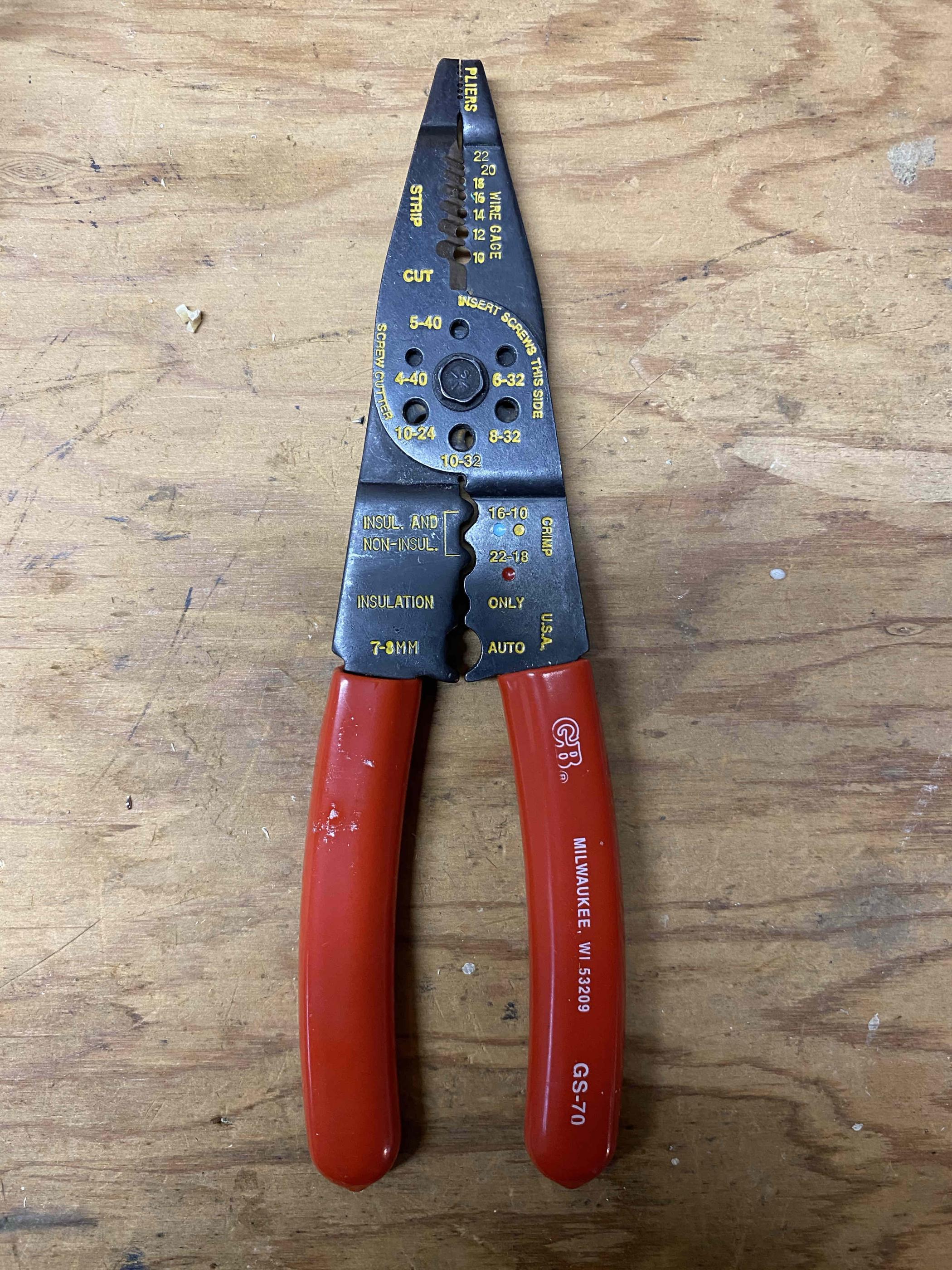

Thank you.....and not expensive.
The black Stripax on my picture is in the $100 range as far as I remember.

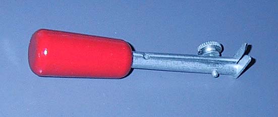

I have only ever seen 2 of these, both sent to me by Allen Wright and have never been able to find an on-line source. It is a Weller. It works fantastically.
dave
