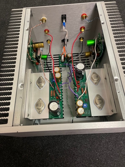

mine finished , works perfect at the start up , no noise at all ! compared to my beloved M2 , i would say that it sound more tubey and it merge pefectly with my PX4 Set amp i use for the highs. same liquid and gorgeous sound. the M2 keep his strenght , tight and a little more transparent
i will wait for all the big capacitors to burn a little before final judgment .
anyway here is another " tour de force" from our white druid.
thanks mr Neslon and Jason.. 🙂

Looks great! Can you let us know what boutique parts you used?
It looks like maybe Nichicon KZ caps for the 1,000uF caps? The green ones are Nichicon ES?
I see the big 10,000 uF cap says Rubycon. Could it be a Blackgate?
Glad to hear your listening impressions. Sound wonderful.
nothing extraordinary on mine , panasonic film caps in place of Wima , Nichicon FG for power supply , Nichicon ES NP for the big 1000uf coupling cap . i have also change the stock Rubycon with a Big Elna 10000uf 63V ( only because i have it ) that i put under the card to have more place .
i will try later a 100uf film cap to bypass the output cap but i don't feel the need of it immediatly as the baby amp is getting better and better with time... 😀
